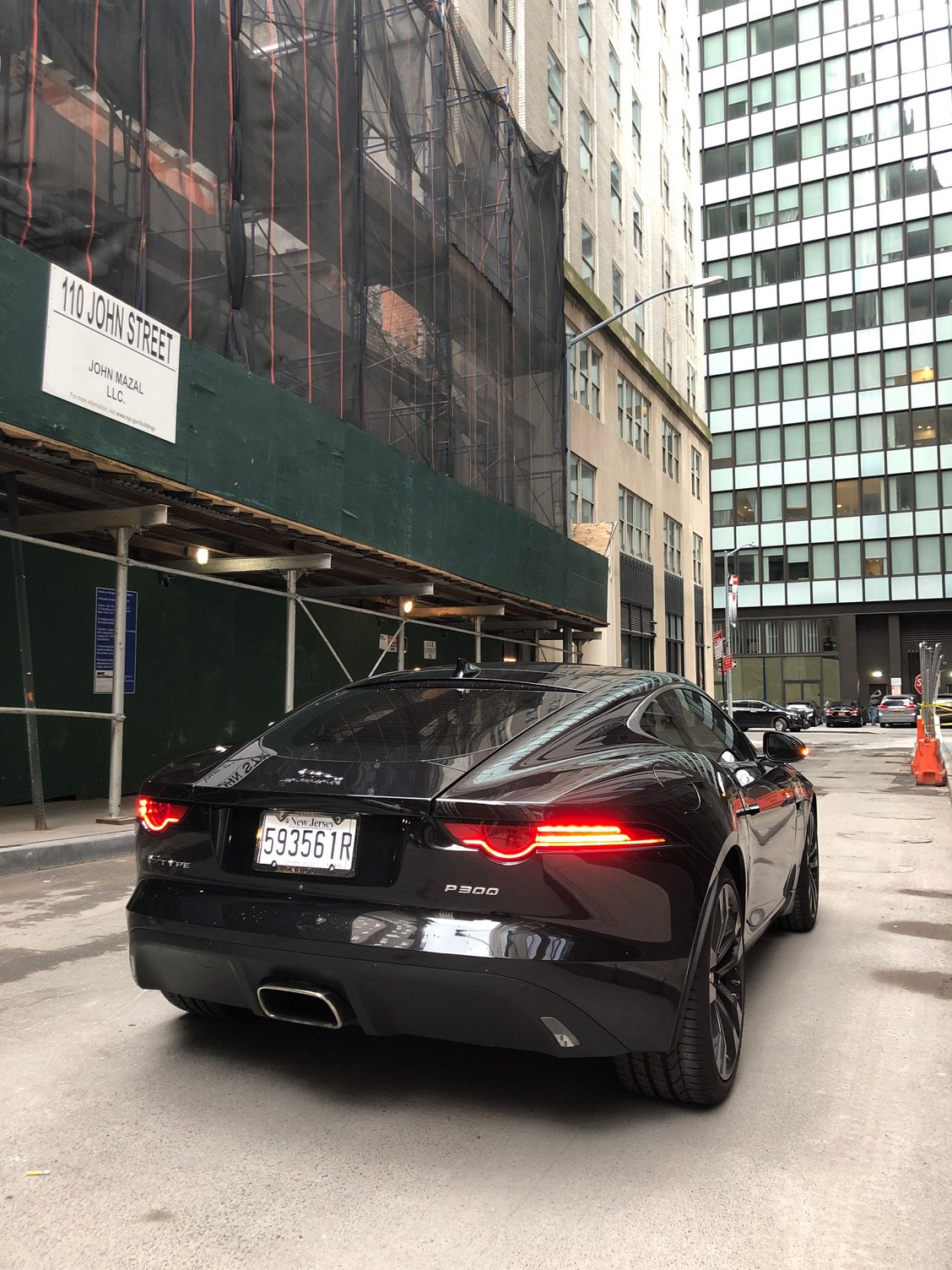

Didnt feel right not tossing up a picture 🤣
