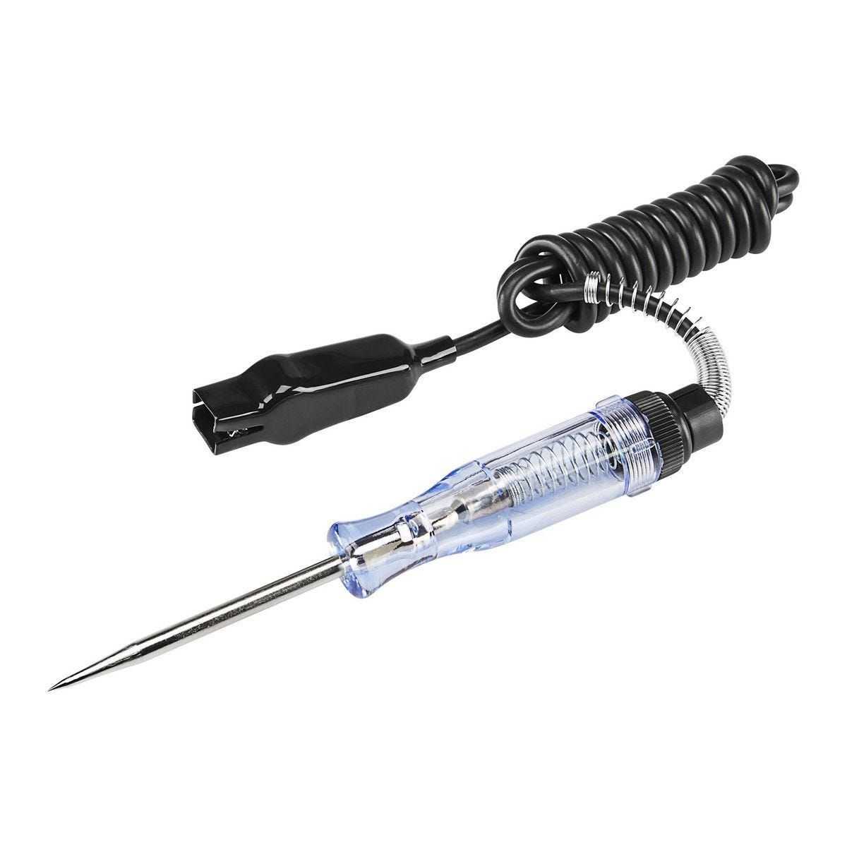

Old Apr 18, 2026 | 05:02 PM
2018XF25T's Avatar
Joined: Apr 2021
Posts: 808
Likes: 216
From: Texas
This wil help you find which fuses powers off when ignition is off and find constant live fuses. The tool is called "car circuit tester". Very easy. And you need a piggy back fuse tap. It should be included with hard wire kit.

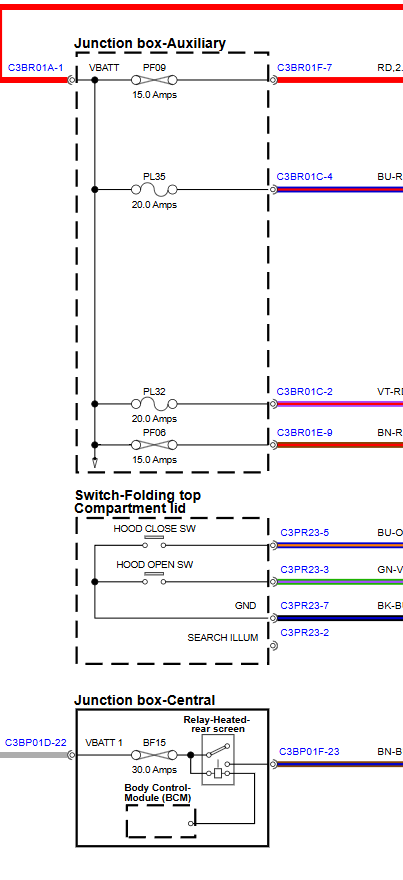

Old Apr 18, 2026 | 06:55 PM
RoverJoe's Avatar
Community Influencer
Joined: Oct 2025
Posts: 497
Likes: 183
From: South Florida
If I had to pick I would choose one of these fuses, either in the left A pillar box or the one under the passenger foot rest area, whatever's easier for you. The fuses shown are for the folding top system, which are not disrupted by any of the quiescent current relays and the circuits should be there on a coupe anyway, maybe without a fuse in them. I would test them for power and just verify they do get juice all the time, but that's where I'd start.
