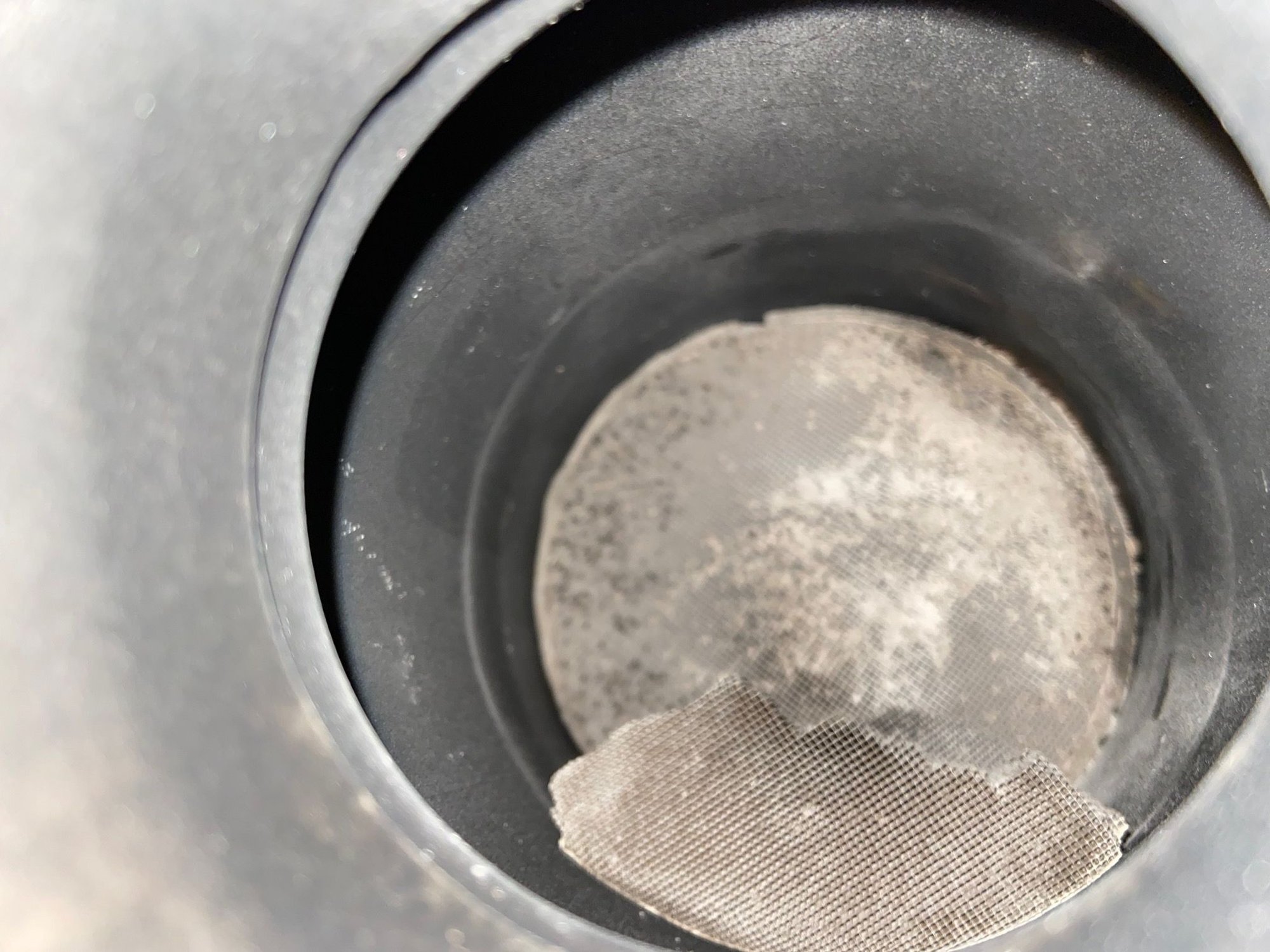

If your Bank 2 catalyst is destroyed, that is most likely why you are getting the misfires. The catalyst clogs and creates too much back pressure, which affects the AFR in the combustion chamber, provoking a misfire. I diagnose this by removing upstream and downstream sensor on suspected bank, can either insert a borescope camera to view or the preferred method is attach a pressure change or oscilloscope to compare delta. If a large delta is noticed before the catalysts = blocked.
Also, if the catalyst had failed and broke off pieces, these pieces can get sucked back into the combustion chamber during the EGR camshaft phase cycle. If this has occurred and you're seeing misfire codes, the worst case could even be something like bent valves from the broken catalyst material.
Nonetheless, it's very rare only 1 catalyst goes out, usually the ECU will flag 1 bank and the other side is shortly lived, meaning both banks are needed when the brick starts to come apart (providing it's a not a code pertaining to a concern of the welds cracked)...etc.

I have some good news!
I have installed all of the injectors and i drove around (40) miles and now the only code i get is the catalyst codes on bank 2. Initially I eventually got some misfires (if i drove it enough) but not this time. Car seems to idle better.
Next day, i decide install the 200 cell downpipes, after disassembly i find my bank 2 cat looking like this. (the pic is after i dumped out the big clusters.
However I figure this is the affect of my misfire, not the cause!
I couldn't finish my install with the pipes because i needed some flange bolts since i couldn't remove the ones in the discarded flange. After i ordered some bolts from ebay, i decided to look around under my car and inspect and i find a horribly collapsed motor mount and I order new mounts as well. After i order the mounts i go and look for a "how to" thread for the mounts and i find this.
https://www.jaguarforums.com/forum/f...mounts-221412/
Right on the first page i see this!
...and yes both of them are my symptoms!
Diagnosis:
There are three signs that you have a motor mount failing or failed on your jag.
1- Slight random misfire, this is one of these issues that your mechanic may chase for bit, replacing a coil, maybe a plug, tried a can of BG44K...and the misfire still persists. Many times with a bad mount the crank sensor will pick up on engine movement as a misfire and give you a code, sometimes the cyl # will change also. Other times it will have no codes and run great just have a clearly audible misfire that also shakes the car. Most of the time this a cold start misfire and goes away when warm, but not always. The mounts are hydraulic, meaning they have a hard rubber shell like most but are full of fluid and an internal valve to dampen vibrations.
2- Engine movement, you may notice your hood jumping up during hard acceleration, this is an extreme failure and will cause damage if left unaddressed for too long, usualyl this is the drivers side mount and the engine torque is causing the motor to rotate and lift enough to push the hood up. Easy to check for, pop the hood put your car in drive, apply slight brakes and some throttle will cause the motor to raise, if more then 3/4" you should move onto the next check. See below for an example of what this should look like when you have a failure."
So my assumption is that .....
1.) bank 2 fuel injector was going out first! (probably #8)
2.) cat gets blown out
3.) cat causes multiple misfires?
4.) motor mount also doing the same at times?
Hell I dont even know anymore, too much to think about but im fixing it all. will update with videos as well.
