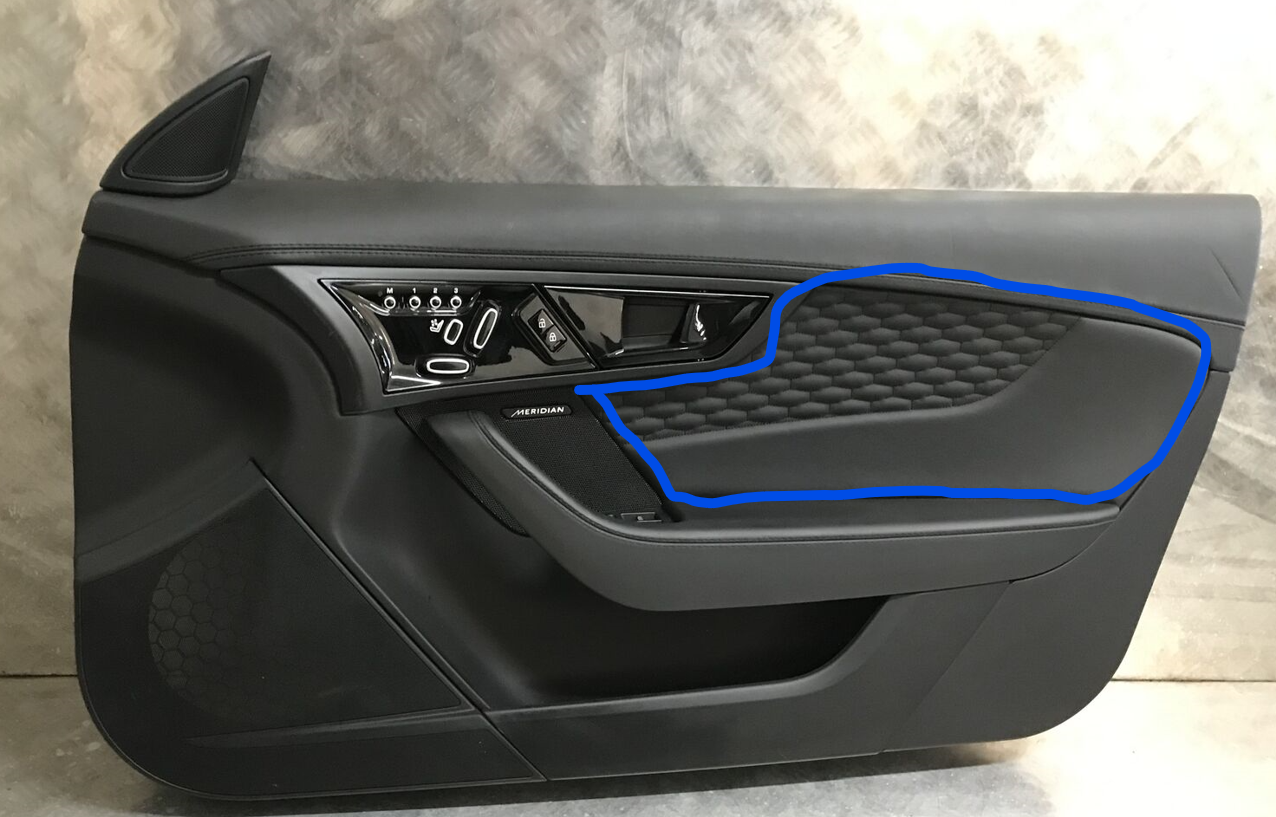

Does anyone have experience of changing out the middle section of the door card? I'm looking to replace mine with the "quilted" section. Are they plastic riveted on? Difficult to see in the pictures? Are they interchangeable?

Usually everything in the card is screwed in or clipped in. However, if it is similar to the speaker grill section at the bottom, it is glued on and can't easily be removed. Try gently prying at the edges from the inside and see how it is affixed.
I hope a new card isn't necessary just to replace that section, but I'm afraid it might be unless you are good with fabrication. Also I don't think there is a part number for just that section?

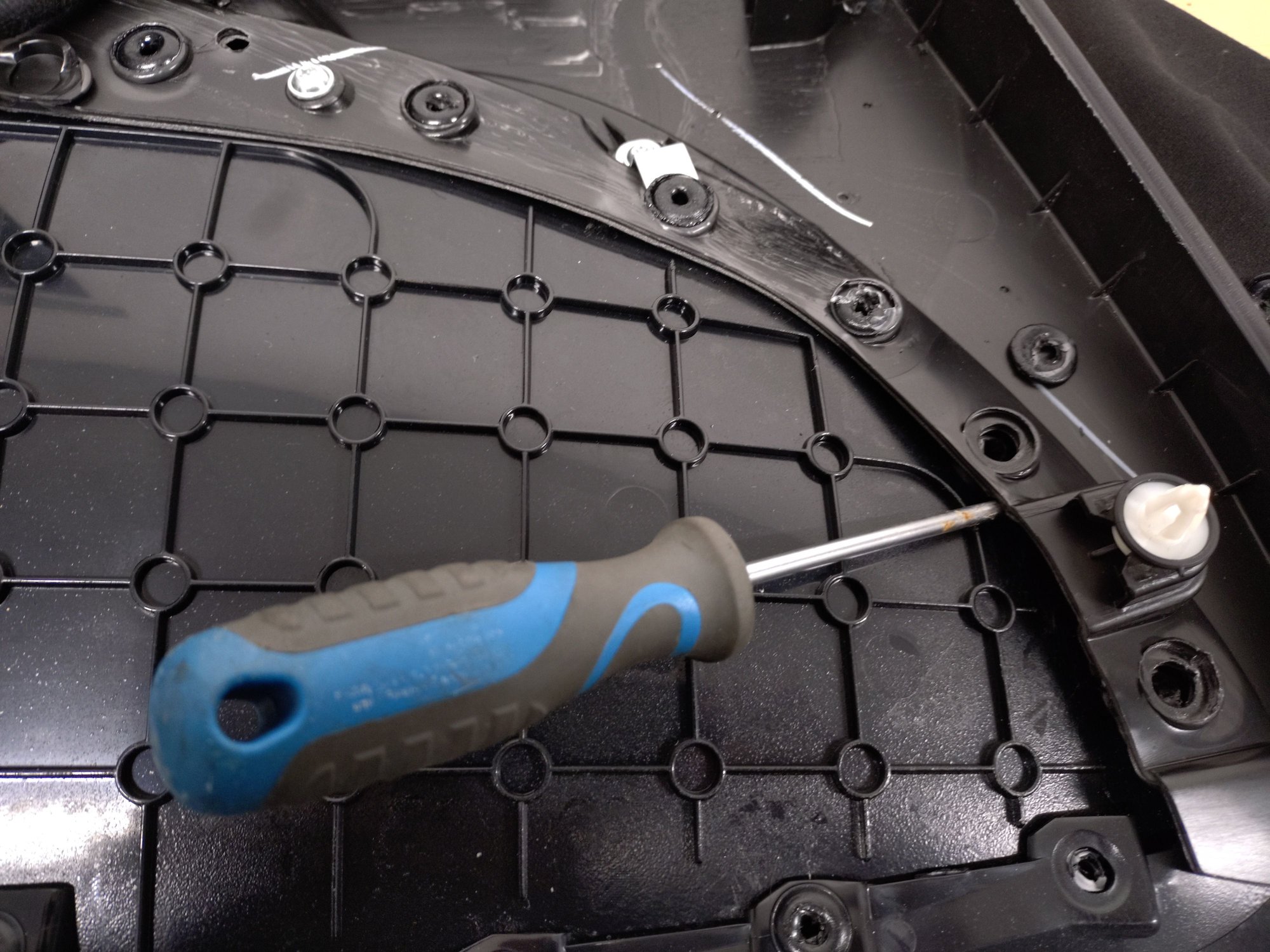

Thanks for the response. I just remembered I have an old doorcard sitting in my garage from my old F-Type. Going to see how easy it is to dissemble. Will update.

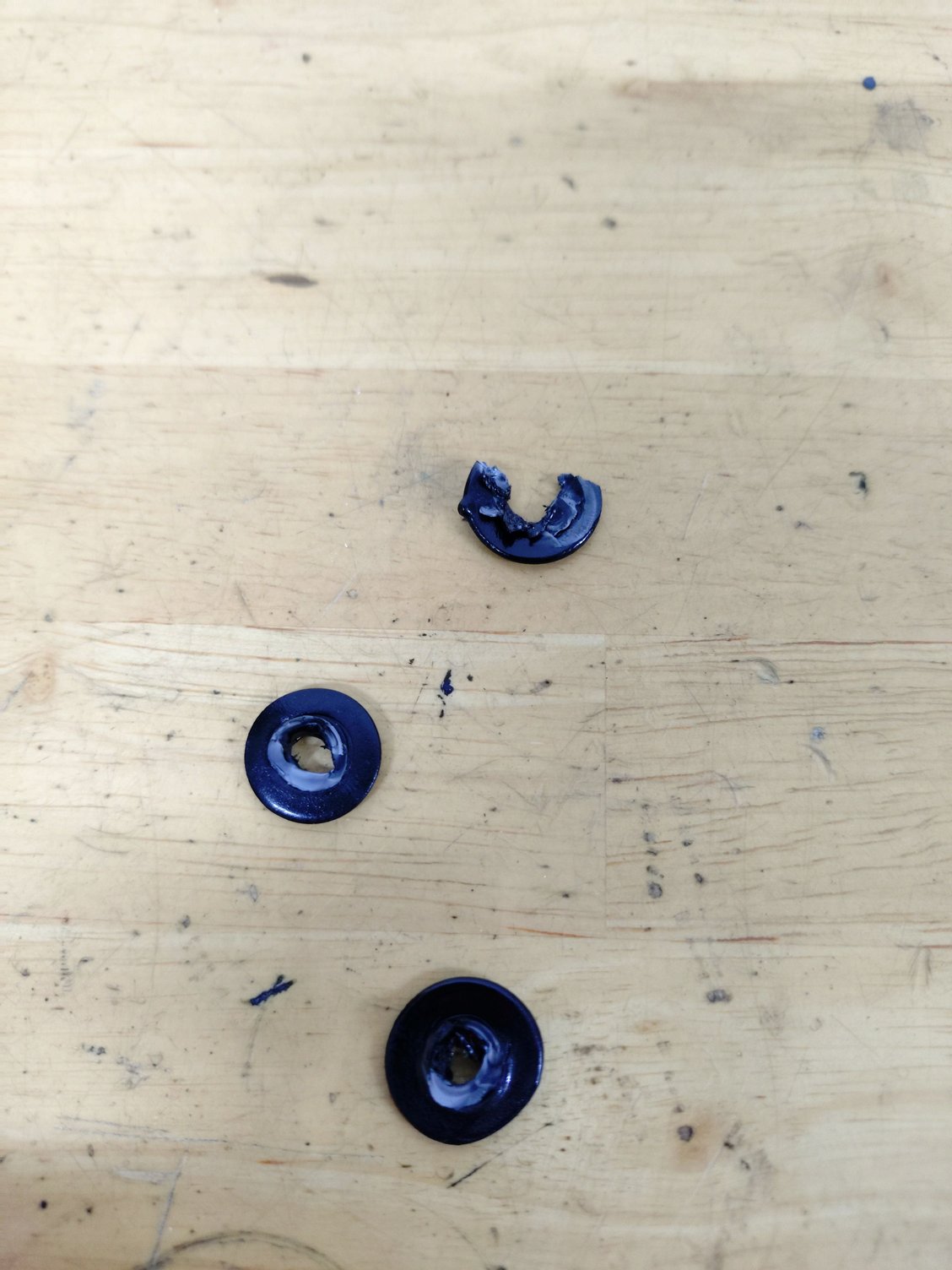

A bugger, plastic welded as I feared

Same as the speaker grill - I hoped the rivets could be popped out but no go.
