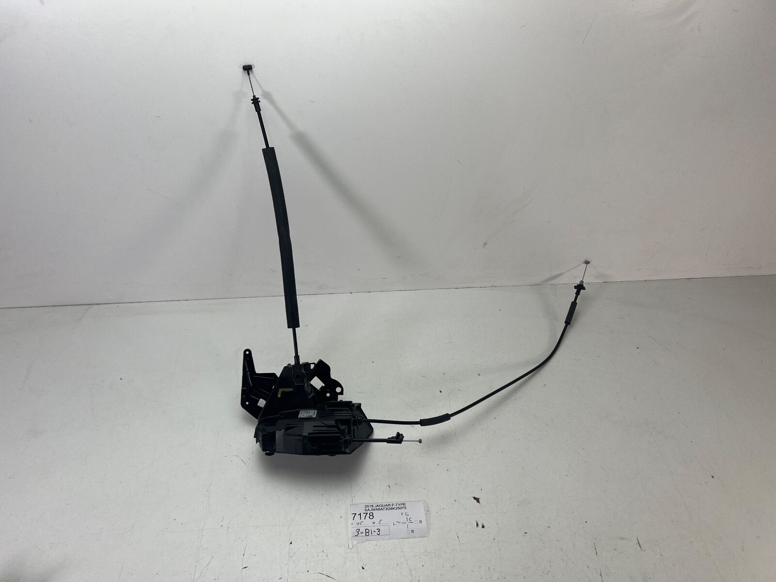

But long story short, ordered this door latch from ebay, and after a ton of swearing and some bleeding (getting the cables hooked up is a pain) my problem is resolved.
