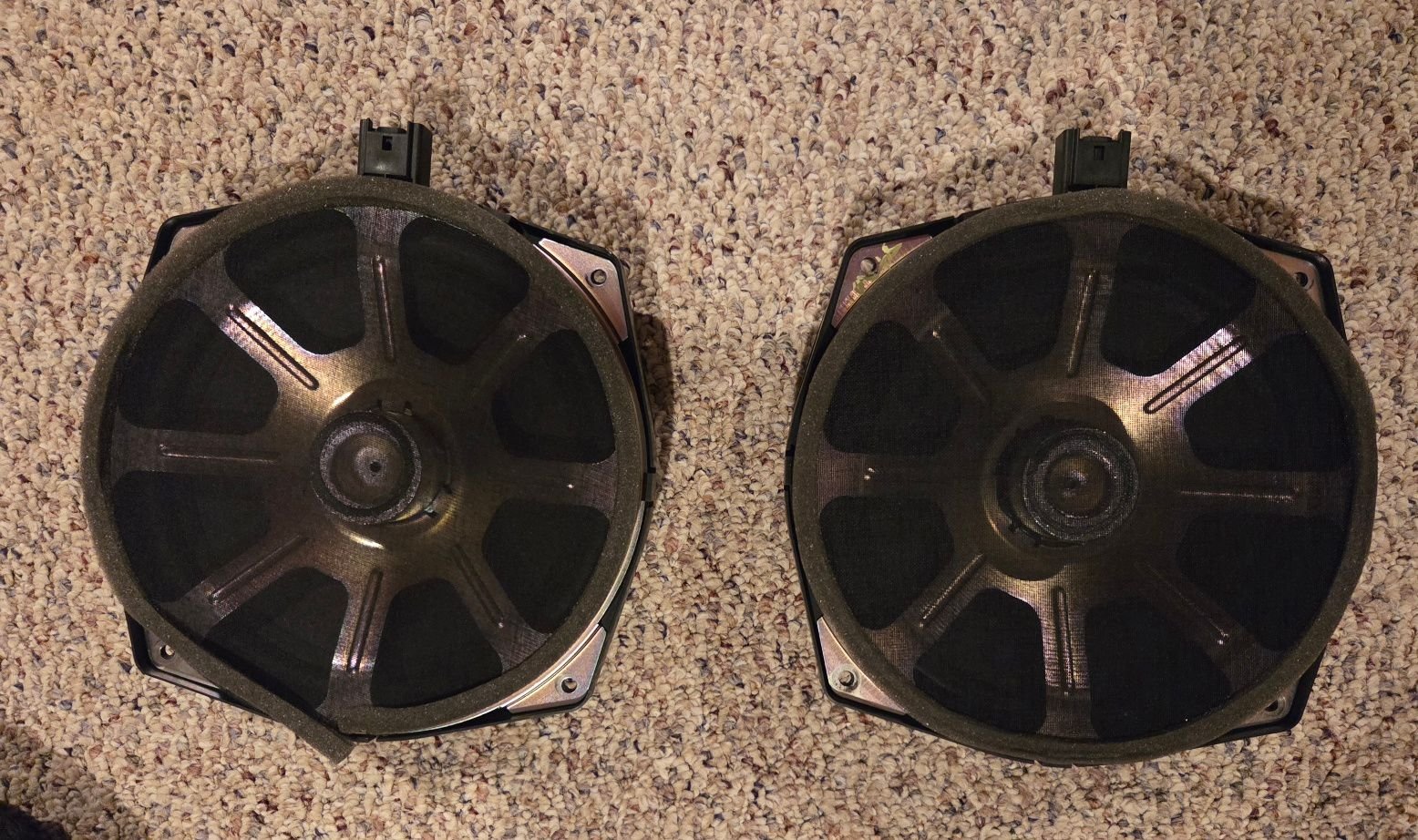

Well, when cleaning the basement over the holidays, I discovered that I had purchased the upgraded subwoofers and forgot about them. Since I suspended my stereo upgrade product, they're available! I've got them posted in the classifieds.
