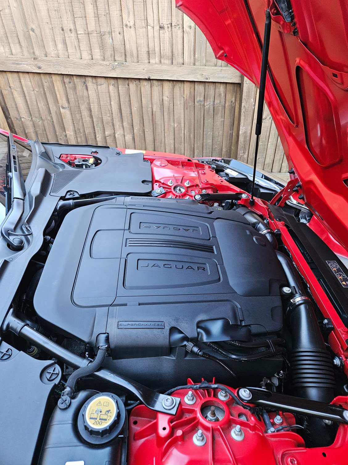

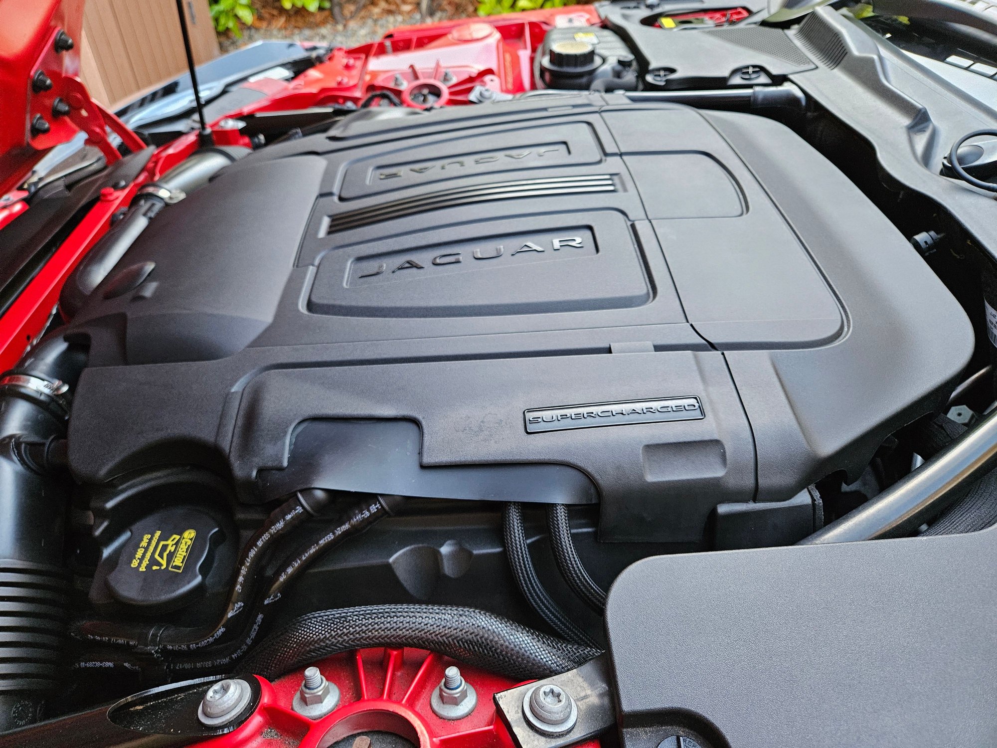

Default Used a silicone mat instead of EPDM
Although I'm skeptical about the chance of rain water or sensible jet washing with the hood down and engine cover on making it's way to the injectors, I used the example above as a template and modified mine this weekend.
Knowing nothing about EPDM, I realised that sourcing a small piece online would be tricky as most were only tested to 115C.
I then came across this silicone mat on amazon that can sustain 230C and it filled the bill. I used a black silicone glue to attach the strips to the underside of the engine cover and I'm happy with the results.
Links (Amazon UK but it shouldn't be hard to find similar alternatives where you are)
Silicone mat
https://amzn.eu/d/fRJZmli
​​​​​Silicone glue
https://amzn.eu/d/h4uMhlJ
Final results. Hope this helps.
