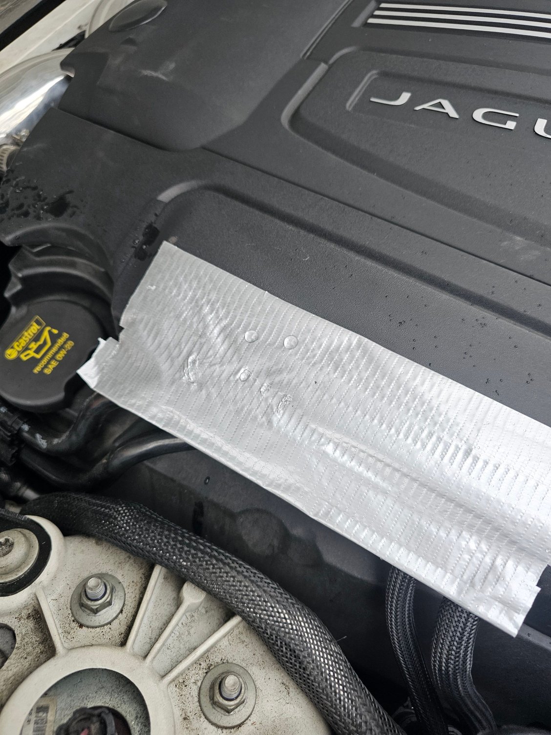

Default Get your engine covers sorted out for the rainy season!
So the other day I parked on the street while doing some visiting and it rained a bit while I was inside.
When I got back home (short drive) I decided to take a look under the hood. Look at all that water!
This morning I pulled the engine cover out of storage and enhanced it with duct tape as several others have done (maybe I'll get around to doing the fancy silicone job at some point).
As a test I parked outside this afternoon, in the rain again. Results below:
Bone-dry, as you can see (I removed the cover again to record the second video).
So that's the solution: modified engine cover for the rainy season. I just keep it in the closet by the front door and take it to the car if the weather calls for it. I call it "Jojo's umbrella" (Jojo is my wife's name for the car; it's long since stuck).
