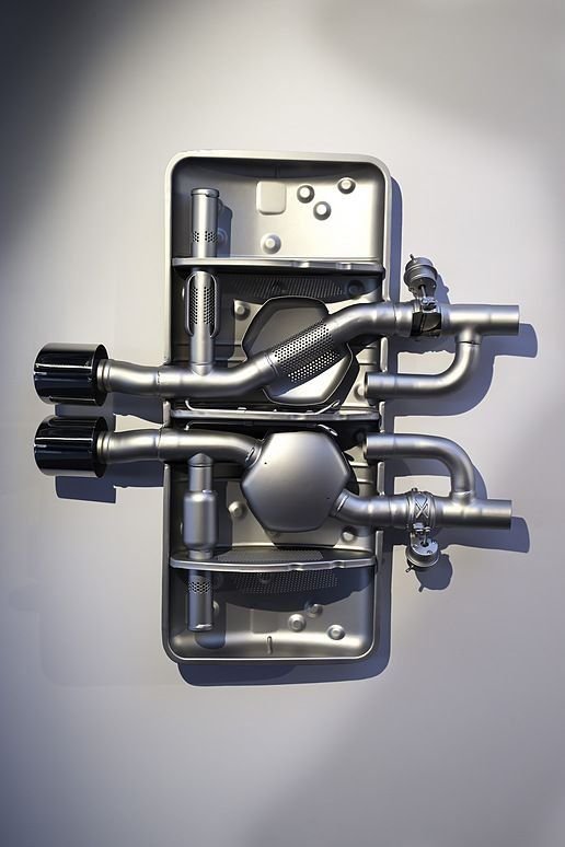

According to this picture, you should be able to easily run an endoscope up the pipe to look at the valves on the inside, though the endoscope might get sooty.

Great idea! Thank you
if they are broken I can just cut them out and put in a small straight pipe, but will be loud always
