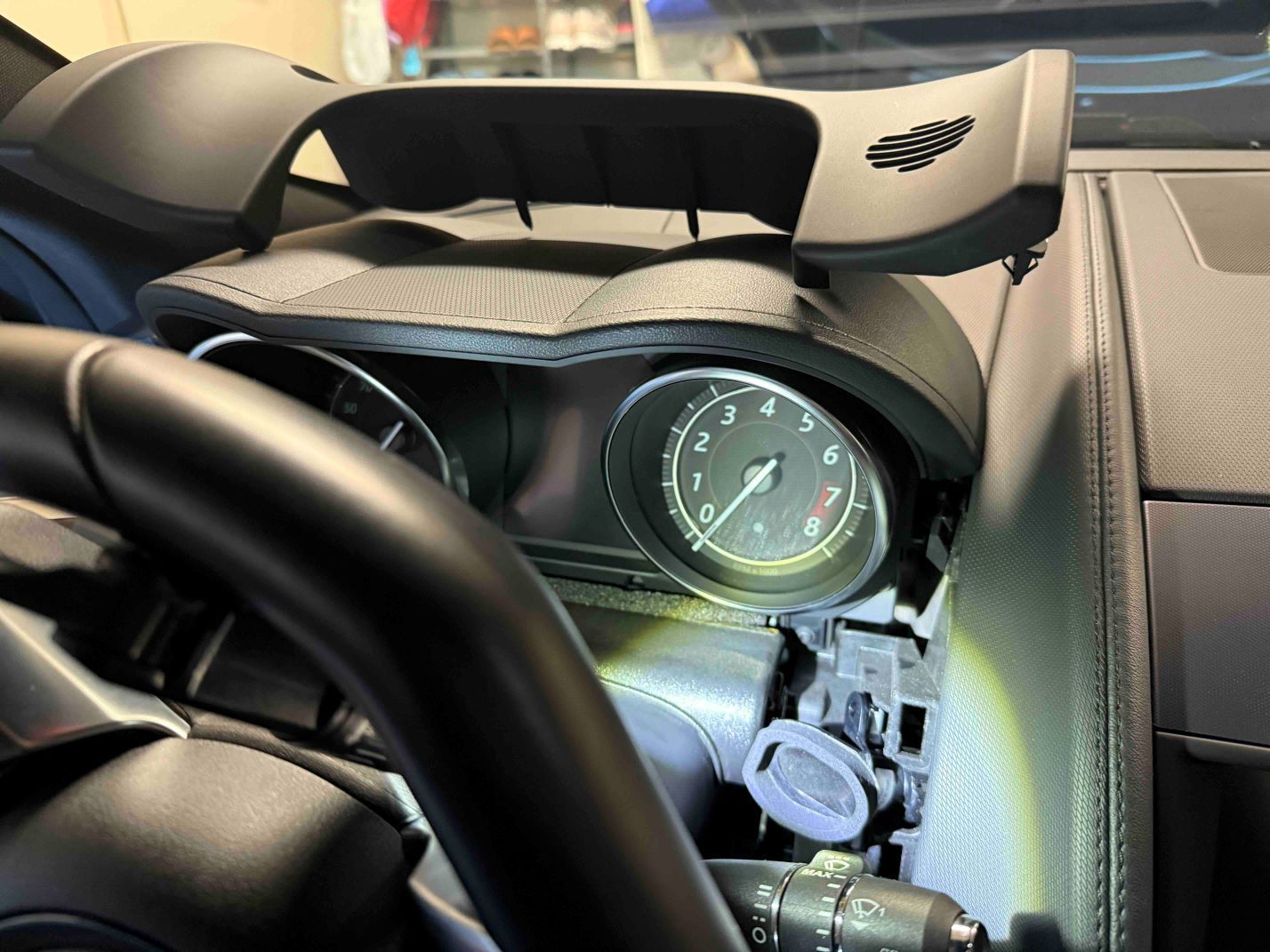

If your AC is acting up or suddenly blowing cold when you have selected heat this is worth a try. It's easy to pop off the trim above the steering wheel and access the unit, which looks like this:
I removed the 2 screws but could not completely remove the unit, but I was able to twist it to see down the "horn" with a bright headlight. Beware there is a spinning fan below the 2 metal sensor wires if the car is awake, so its best to wait for it to go into sleep mode first before inserting anything into the "horn". There was a surprisingly large piece of lint + dust wedged between the fan and the sensor wires that I carefully removed with some fine tweezers.

Is the "horn" there below the tach and above the stalk? I have trim removal tools, looking for guidance as to where to insert tool to pop off trim piece. No issues as yet, but want to file this in case.

Yes Valerie that's the horn. The trim piece is resting on the dash after I removed it. The oval vent on the trim piece is where the horn intake is located just behind it.
Pops out easily just by prying a little, grabbing the edges and pulling out. Snaps back in just as easily. Would be impossible to break if going slow and gentle, so no fear!
@Carbuff2 Give it a whirl and see what's in your friend's horn. Foreign material like lint and hair may transiently affect the current across the 2 sensor wires just above the fan and mess up the temperature reading.

Great photo and I appreciate the work note help. Deadly fear of breaking parts. I pried that little triangular plastic piece off the door side/edge toaccess screw and remove the door card and broke the plastic piece. $50 for that little *&^$% piece of plastic!!!!!!!!!!!!!
