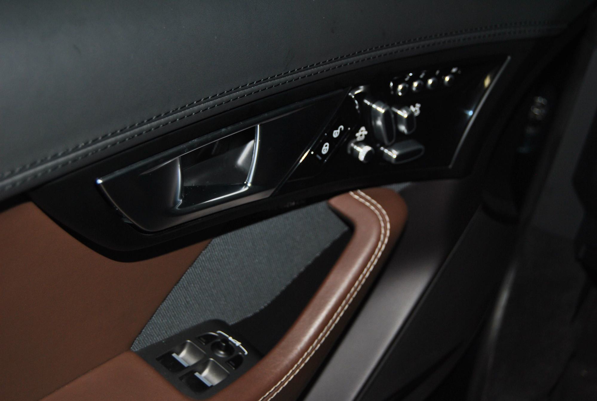

The OP clearly states in his original posting that his car only has "two controls". So is it just that the OP did not read his owner's manual regarding seat adjustment for the base model? It is on p.20 of my manual (Canadian market): the settings (with illustrations) are listed under "MANUAL SEATS" thus:
"1. Seat angle adjustment" (this refers to the button which electrically controls the seat back angle)
"2. Height adjustment" (this refers to the button which electrically controls the seat bottom)
"3. Forward and rearward adjustment" (this refers to the lever at the bottom of the seat to the right of middle for manual adjustment)
All of these are referenced to drawings of the seat controls.
Relatively few of the cars were sold in base form, so most of the cars had full electric adjustment fore/aft, up/down and angle adjustment for seat back angle and seat base angle. Many had further adjustments: for the lumbar support (in/out, up/down) and bolster adjustment (inflate/deflate) - as shown in the photo from my car.
Perhaps the title of this thread should now be amended to have "SOLVED" after it?
