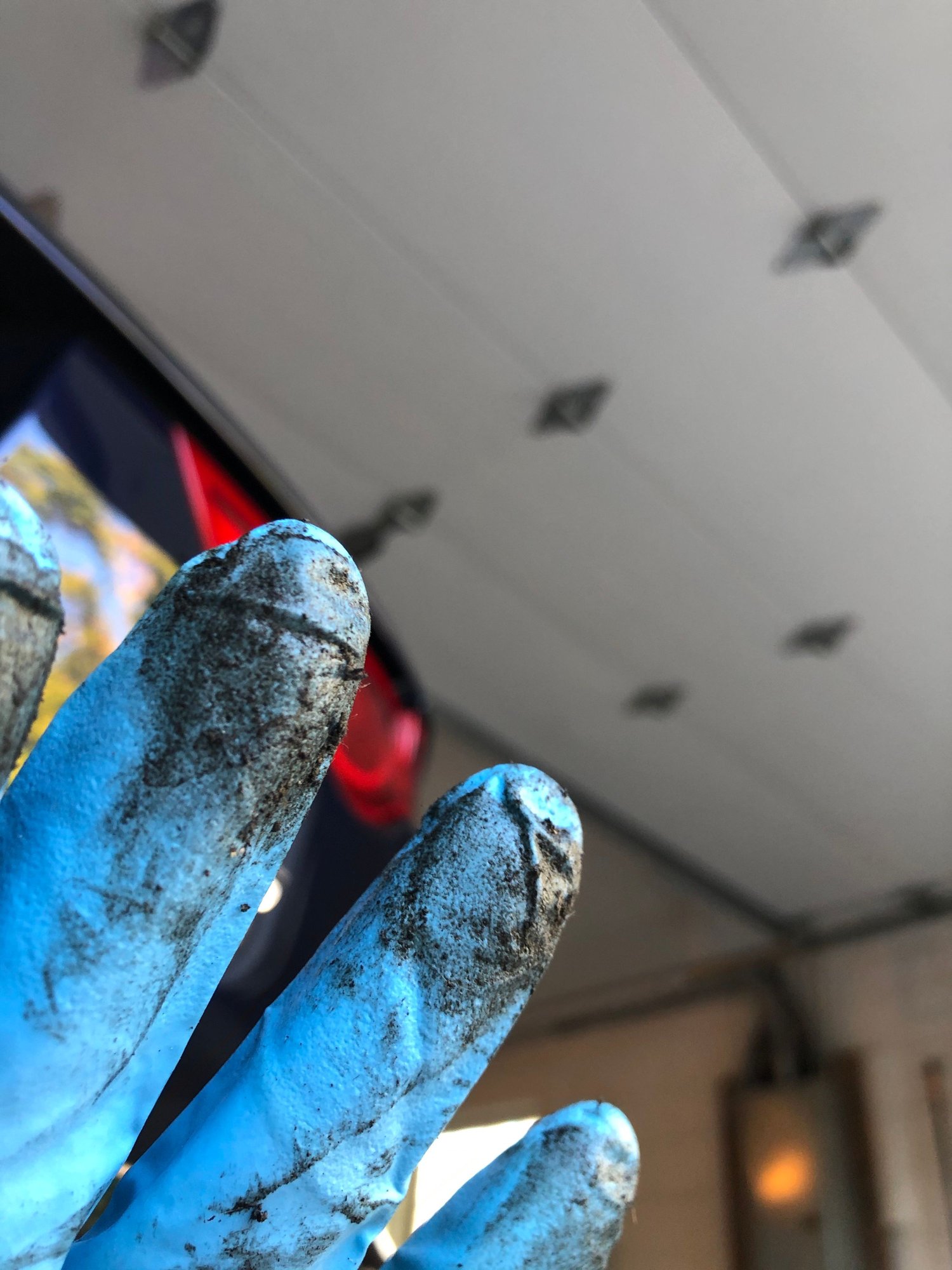

I think I might have a small amount of leakage from my rear differential. I took the covers off and the front differential is bone dry. There is a small film of oily dirt covering the rear differential that starts from where the drive shaft enters and stops near the drain plug. Hard to see in this photo but you can see what it looks like when I wiped it with my glove. I haven't driven it in 2 weeks so it isn't water. Is this what others have seen with leaky seals?
I have an appointment in 2 weeks at the dealer. I want it checked out now as I have only 6 months left in warranty and I will be putting it away for the winter soon.

Yup, definitely looks like the input/pinion shaft seal is weeping. I would insist on having it replaced now while under warranty, it will do nothing but get worse with time.

As suspected it was the pinion seal. Currently being repaired at the dealer. Just over 25,000 miles and 4.5 years old. 2016 V6S AWD. Add it to the list.
