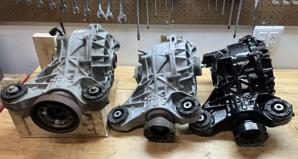

Good discussion, here are my thoughts after taking apart 6 rear differentials from various F-Type and XE vehicles.
There are stories of forum members experiencing various noises from the rear diffs.
Whining Noise: @bostonian F-Type R
Whining noises while driving straight would indicate a consistent gear mesh issue between the pinion gear and the ring gear. This could indicate old oil or lack of appropriate lubrication, improper backlash and preload on the bearings internal to the diff.
Whining noises while making corners would indicate a differential gear mesh issue between the planet and sun gears, or an issue with the friction discs in the V6 S model LSD. The LSD cars certainly benefit from more frequent oil changes, of the correct type. (Castrol BOT 720) @jcb-memphis
Clunk Noise: @themacs001 2021 with 16kmi
A clunk from a rear diff would indicate poor oil, or no oil to soften the gear engagement in the center carrier, but could also be poor axle half-shaft engagement into the rear diff.
Or the e-Diff engagement mechanism could be the issue for clunk noises on V8 cars.

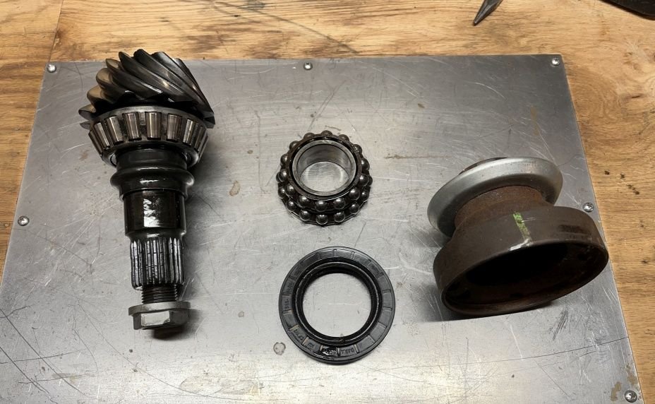

Replacing Pinion Seal: @scm
Yes, this is a big job. I have done this on one of my rear diffs (3.15 ratio, from base V6, 40kmiles). The seal needs replacing, the yoke to pinion shaft interface needs refresh, the crush washer which separates the two bearing races is hard to replace/find/source. The amount of torque needed to crush the crush-washer is up around 400 ft-lbs and requires a very long extension on your wrench.
The pre-load on the pinion bearings (one is a dual ball bearing, the other is a roller bearing) is critical and difficult to achieve with the unit still in the car. (Jaguar method) I have a means now of getting this right.
The Jaguar rear diffs are based upon the DANA 44 AdvanTEK gear set, which has a 220 mm OD Ring Gear. Each gear ratio has a unique pairing of Pinion and Ring gear. These were specially developed to be quiet, efficient and long life. But I think more pressure and shear force is applied to the oil, hence Jag has specified special diff oil for these units. (BOT 750B, or BOT 720)
Jaguar designed the aluminum housing and cover to fit a range of their cars. The cover-to-housing is sealed with a grey RTV and, yes, this can leak. It is a total pain to remove from the car and repair, so best to inspect this interface before returning to service.
I will soon be offering a rebuild service for these rear differentials. I am also looking at the V8 e-Diff units to see if they can also benefit from a rebuild service. This will result in less expensive replacement options for those with Jaguars that are out of warrantee.
