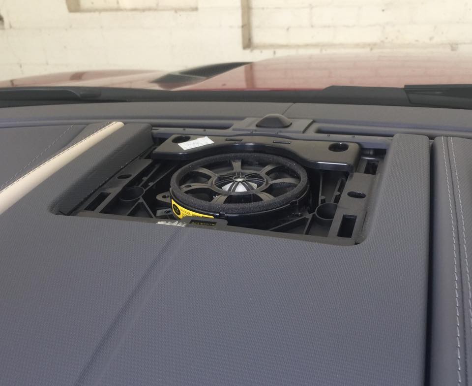

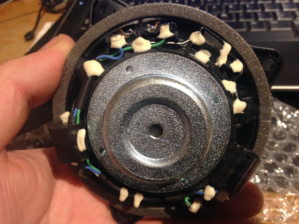

The center fill speaker;
Attachment 131354
Attachment 131355
Attachment 131356
As per usual, a Land Rover branded item in a Jaguar box. Actually this speaker is a bit unusual in that you can only order it with a Jaguar part number...
The speaker is mounted in the rising air vent assembly and is covered by the same grill.
Attachment 140392

Cambo, I am attempting to install a new center dash speaker & am unable to access the front screw. Topix makes it look like the panel on top of the center vent should pop out. Any help would be appreciated.
