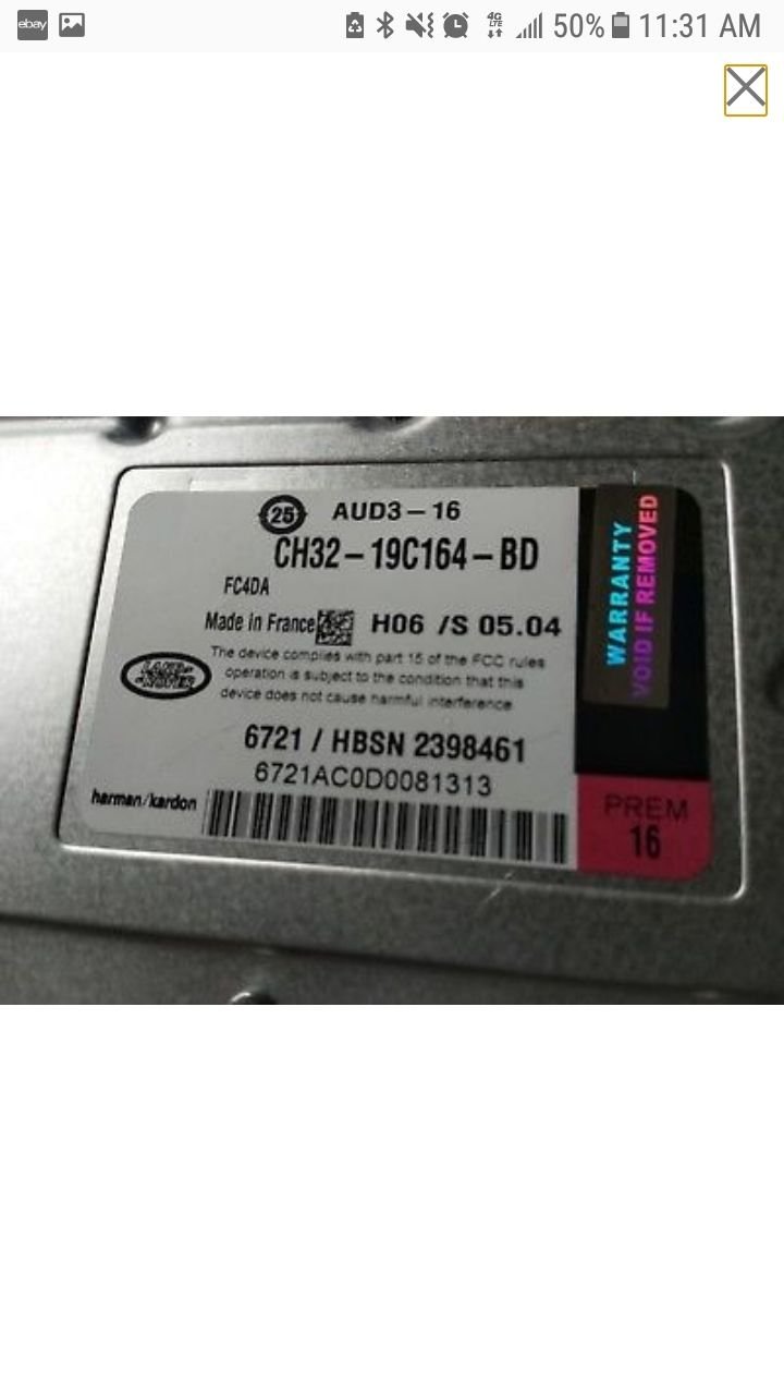

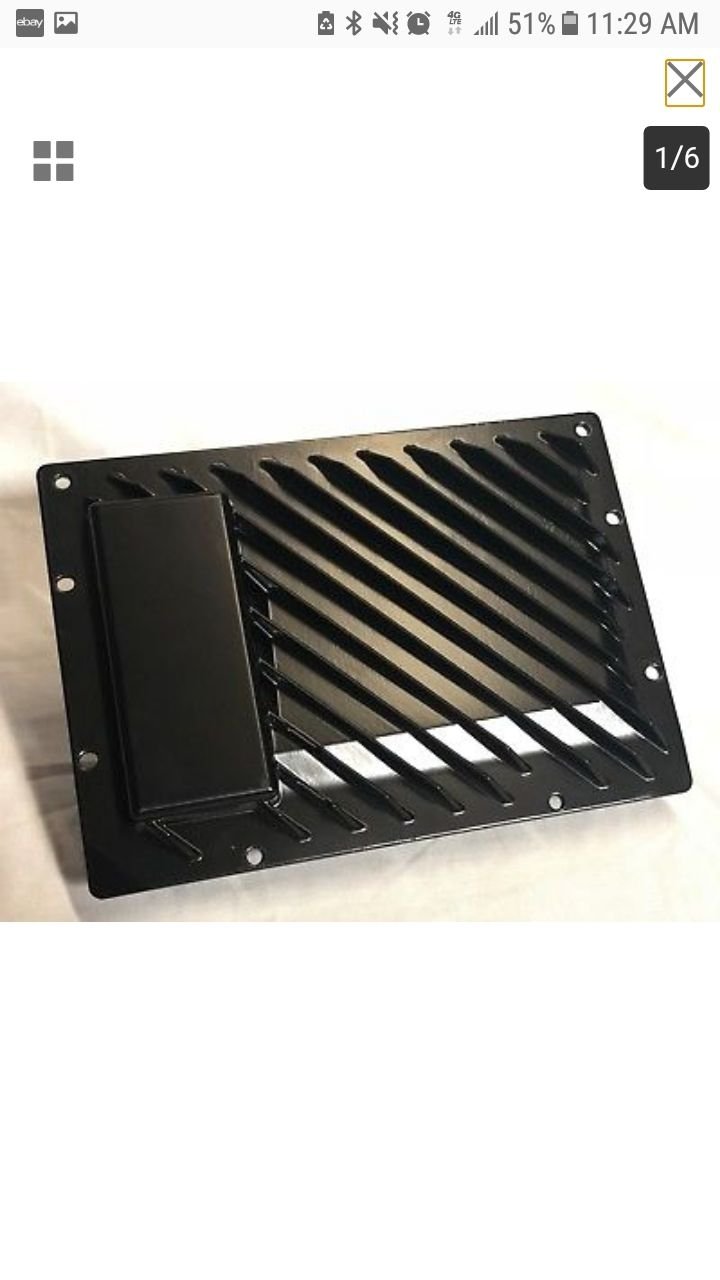

Amp - DX23-19C164-BA
Center Speaker - C2Z22817
