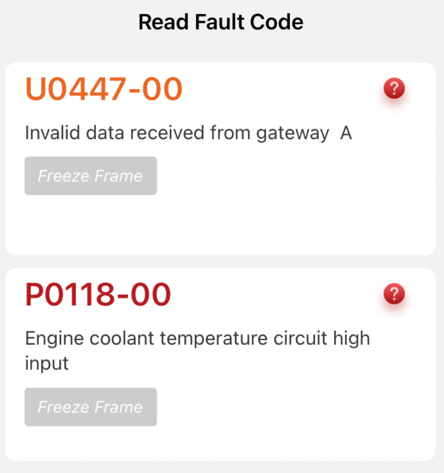

After changing cooling pipes, my car cannot delete those errors: U0447-00 and P0118-00
Since it is at independent garage without JLR diagnostic, we are bit stuck... Anybody have idea what this might be?
Thank you in advance

Thank you, it was a un-clicked connector to one of coolant temperature sensors.
All good and purrr now!

Probably you did not connect the (correct) ect (temp) sensor.
wenn deleted the symposer you can also have swapped the temp connector…. Bin there…😌
