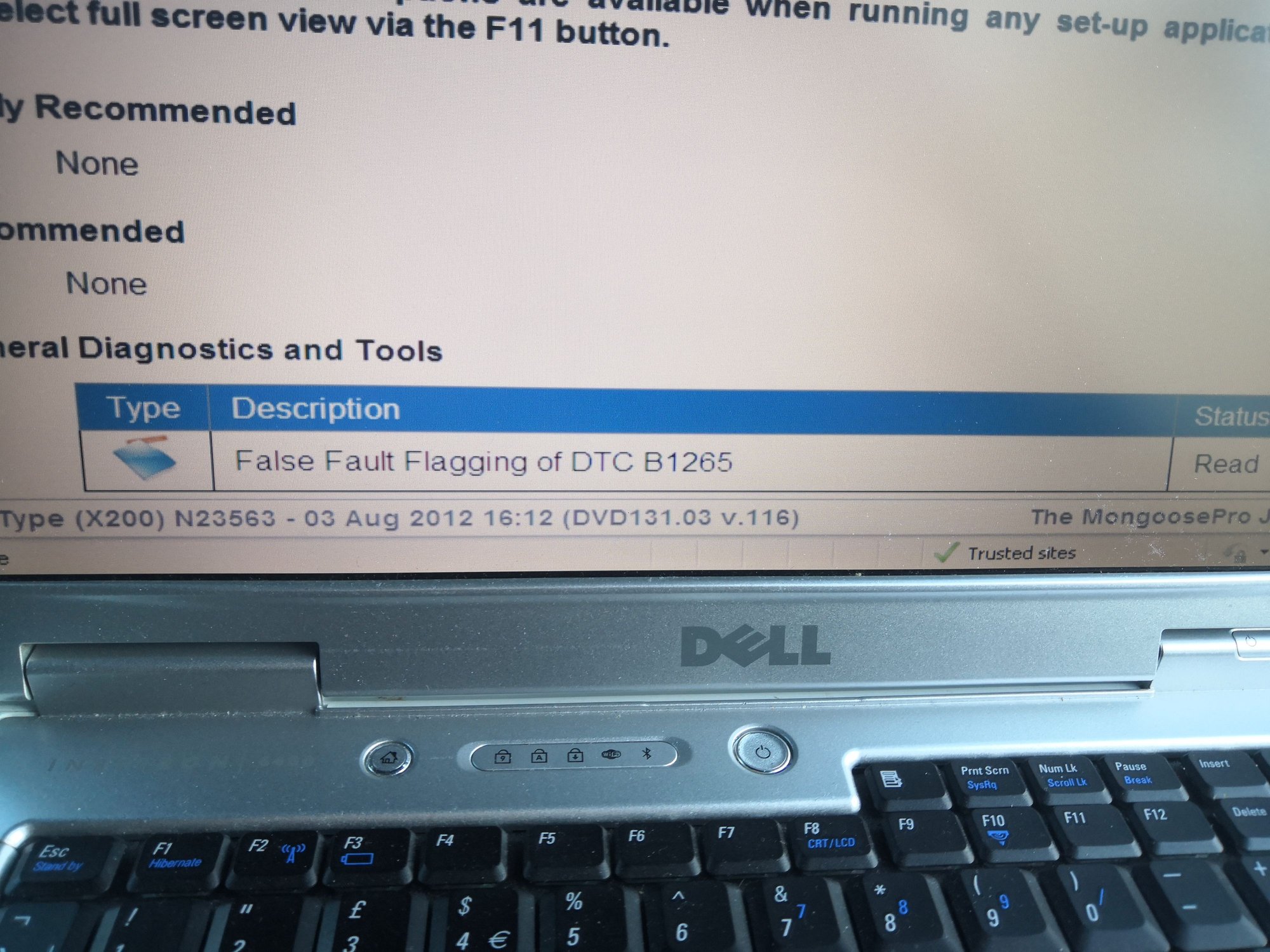

I had b1265 and 2477....1265 was a bad servo motor at the door and 2477 was fixed with a module reflash....i i ended up doing a reconfigure as new module and it fixed the amp and d2b comm network fault
Which module did you reflash. I have flashed the Audio unit and Voice module as new.
Those 2 and the amp and both electronic modules...i used sdd version 138.02

I couldn't find an option to flash the amp. I have installed it from another car, but the audio works fine .. As far as I know.
I have flashed FEM and REM also.
Might check fuse for the amp as it wasn't factory fitted, but I would imagine I'd get no sound if it wasn't working at all.
