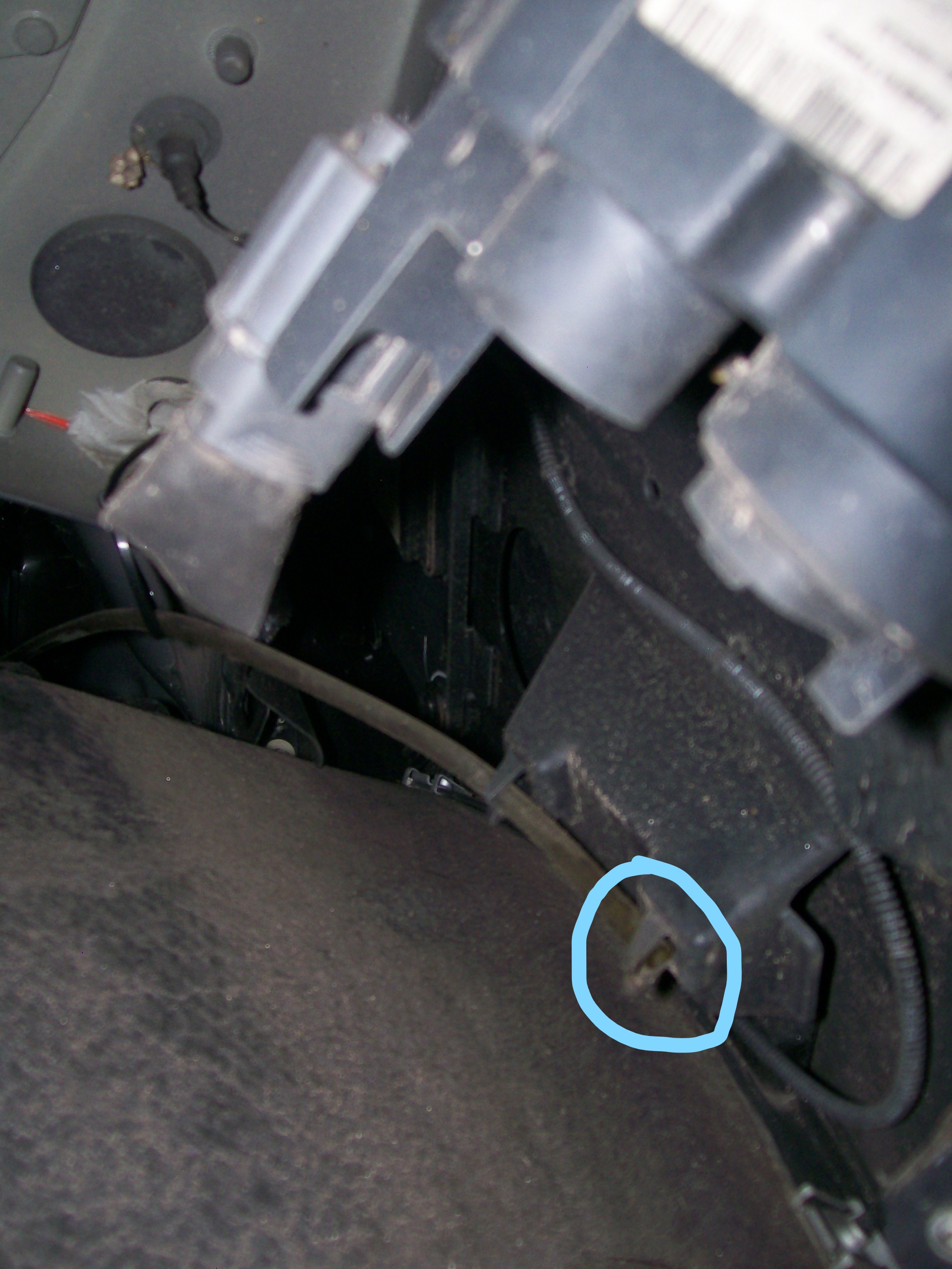

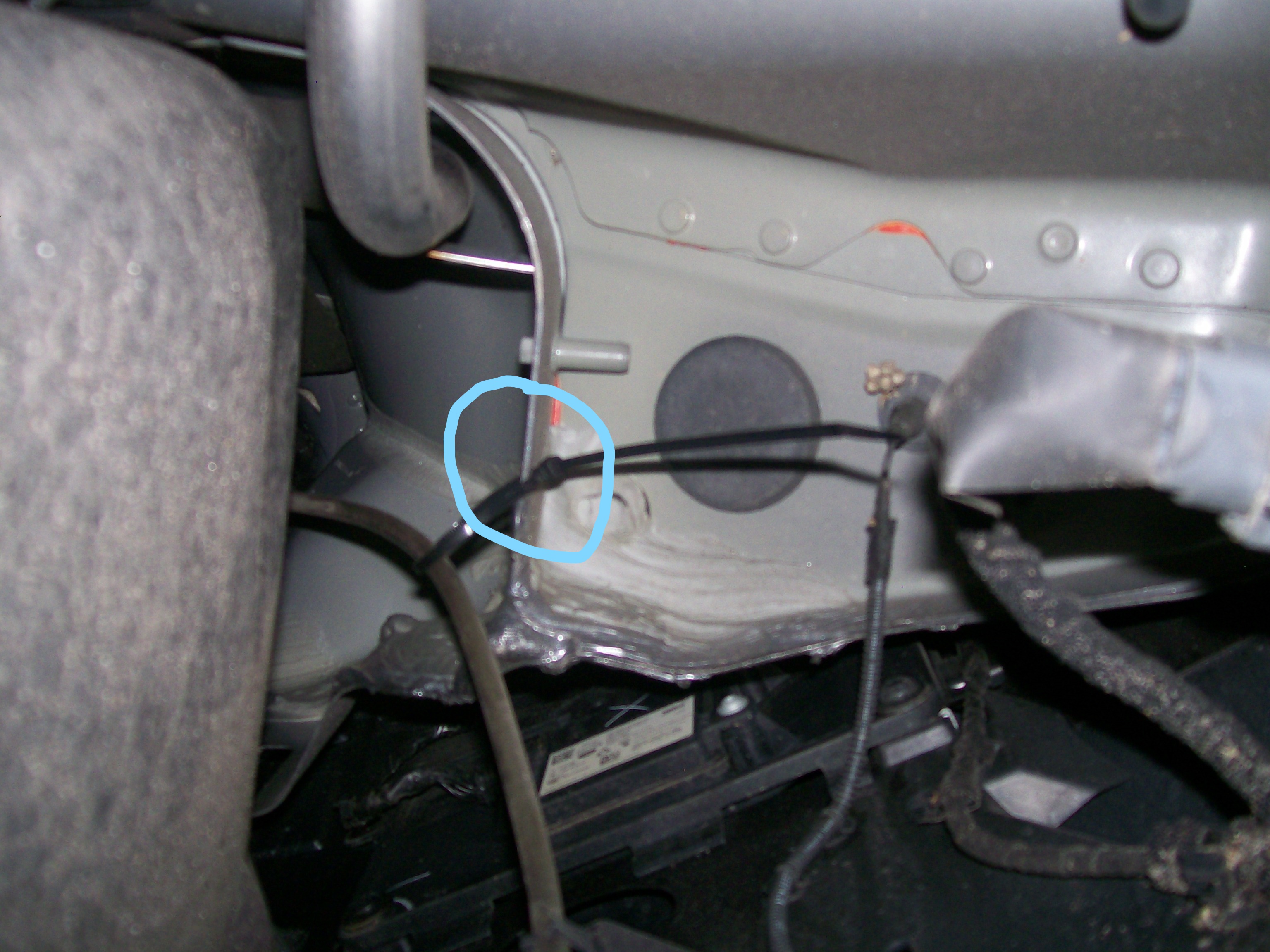

Hoping that this tube was not so far in under that car that I could slide under and see what was going on. In this case, the tube was not in its lower clip, so heeding the other warnings, I gently pressed it back into place. That still left a lot of "flap", so I got a zip tie and found a nice hole in adjacent sheet metal. Needed all the finger dexterity I could muster to engage the zip tie and tighten it up a bit. That still left the end of the tube loose in that clip, so I put some RTV on a popsicle stick and spread it over and around the tube and the clip, being careful not to get any in the drain hole end of that tube. I sure hope this works, that noise is such an annoyance. MANY thanks to vipretr for all the time and work to isolate this. Photo is the location of the sheet metal hole and zip-tie, second is the very end of the tube in its clip, where I put the RTV

It's at the right rear corner. Get your bearings from the location of the fuel filler door ... standard suspension/not lowered. Put on a pair of protective glasses and on your back or side, slide under and look up. With sufficient light, you should see the tube, and the location vipretr used to fasten his zip tie, and perhaps the small hole in the adjacent sheet metal where I fastened mine. While I was pleased to correct this tube issue, it did NOT resolve the 'tink' noise that I now think is in the passenger door... probably loose wire connectors flopping around. UGH.
