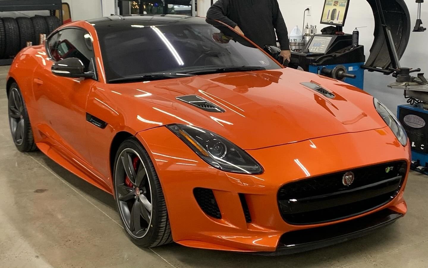

So after a lot of looking, I found the car I was looking for. More miles than I typically go for (a little worried at 45K) but color/equipment/interior, price, all worked. So I compromised.
For now, I'm going to keep it stock till I trust it more and go though some level setting maintenance. But there will be pulleys/tune/cats, etc. in the future. The dealer mounted 255's / 295's all season tires on it. So wrong tires, and the fender gap/tucked tires are killing me. It has the carbon wheels, I think these will end up being my winter setup.
From my forum search, 15mm spacers from https://www.motorsport-tech.com/ seem to be the recommendation? As to lowering springs it appears to be H&R?, or I'm leaning towards the adjustable KW's. I autocross and do an occasional track day, so my typical default is adjustable. I'm pretty well versed in Porsche's/Bimmers, I've turned a lot of wrenches. But I have 2 days experience with the Jag, so open to any suggestions. Thanks.

Change your rear differential oil, unless you have service records that show its already been done. 45k miles is past the recommended 30k interval, based on much research here into rear diff problems. I just picked up an R-Type as well, same mileage. I looked at your car, but wanted white. I just got 2 liters of the proper diff oil (BOT 720) from the local Jag dealer. I'll change it myself, several good guides online to help.

For the existing wheels and tyres (exactly the same wheels and same size tyres as my set-up) you will want 15 mm spacers on the front and 20 mm on the rear.
If/when you go to a summer set-up of 265/305 tyres then swap the 20 mm rear spacers out for 15 mm.
One good thing about the Blade wheels is they are the ONLY OEM F-Type 20" wheels where you can use 15 mm spacers without needing to cut or grind approx. 3 mm off the wheel lugs, so if you go for a different set of wheels for your summer set-up you will need to carefully consider which wheels. Different wheels could mean you want/need different size spacers or else consider after-market wheels with different offsets such that you don't need spacers at all.

Based on the carfax it's been dealer maintained, but I see no record of the diff fluid. I'll change all fluids just to level set on maint. I do a lot of that kind of work myself. The engine bay is freaking packed, so some jobs are probably going to be a pain (like plugs)
Second set of wheels would have offset to eliminate spacers. I knew this going in, but the lack of aftermarket support is going to make things challenging. I think I have to do springs/spacers now, current stance detracts from otherwise incredibly beautiful car.

There are at least two manufacturers that will make wheels to your specs. I opted with BC Forged over VS Forged because of the styles available, but both are represented by members here. There are a few threads on the subject.
