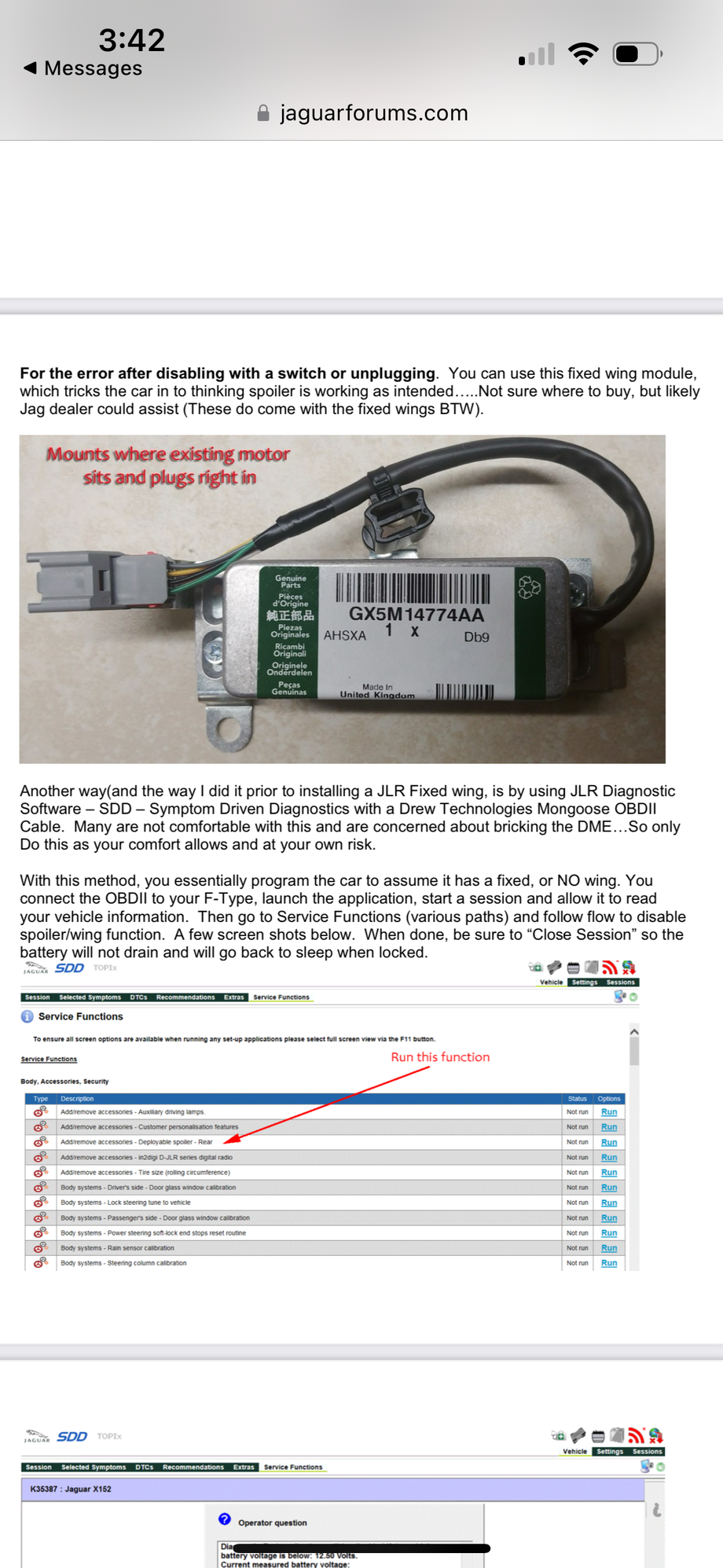

Hello everyone, my name is Eric from MADNESS Autoworks I am here to ask the experts where I can get a fixed wing module so we can complete a fixed wing conversion. I am thankful and have read TheRock's DIY PDF post where I was able to get a part number Gx5M14774AA. However, I am unable to find this part an
d have called our local dealership with no avail. If anyone knows where I can get this module it would be very helpful. Thank you for anyone who reads this, have a great day.

That's the module, but the number on it doesn't look like a "normal" Jaguar part number. I got the full kit and installed it myself, so just checked the paperwork that came with it to see if it listed numbers for the parts in the kit. Unfortunately it has numbers for all the parts (hardware, switches) except the module and the fixed spoiler itself. For 2016 the spoiler kit had a part number of T2R19419LML. Your dealer might be able to use that to track a replacement module, although I'm not too hopeful.
