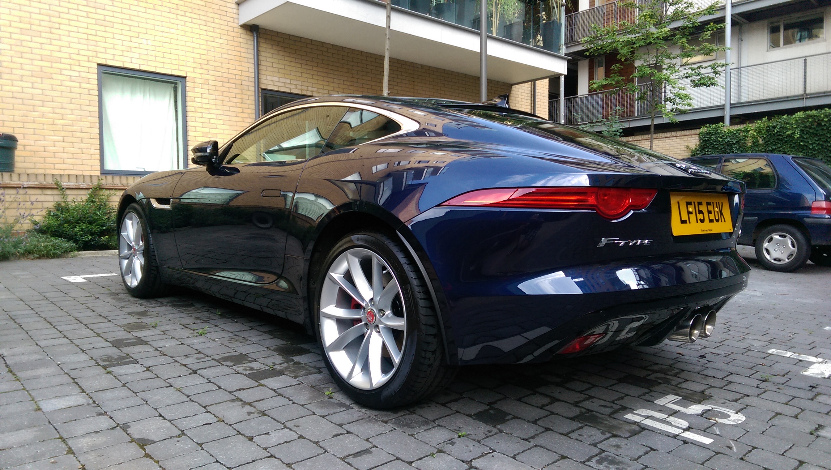

Here's some pics after a recent well deserved hand wash.

Very nice looking car. I am also interested in the answer to this.
