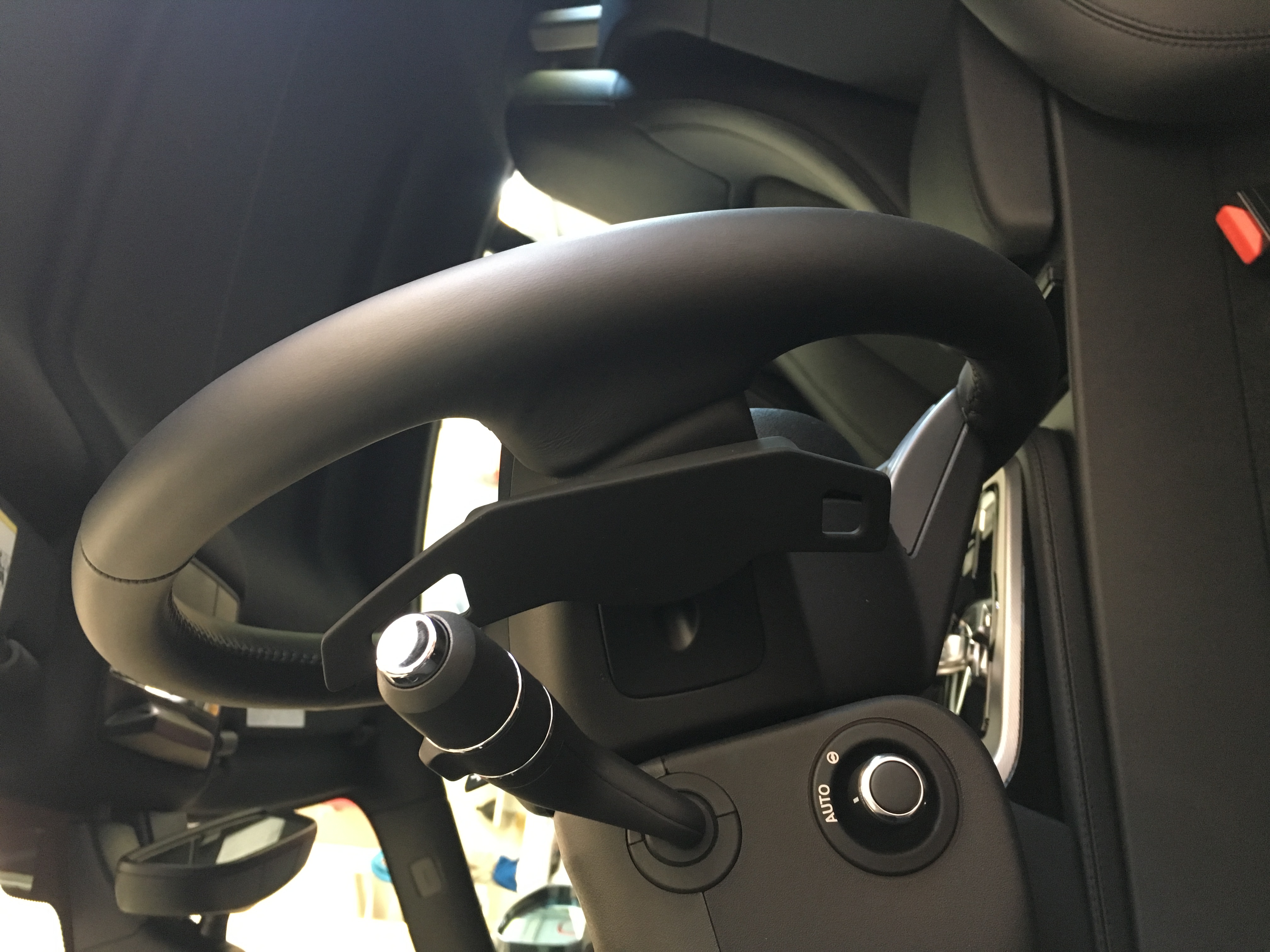

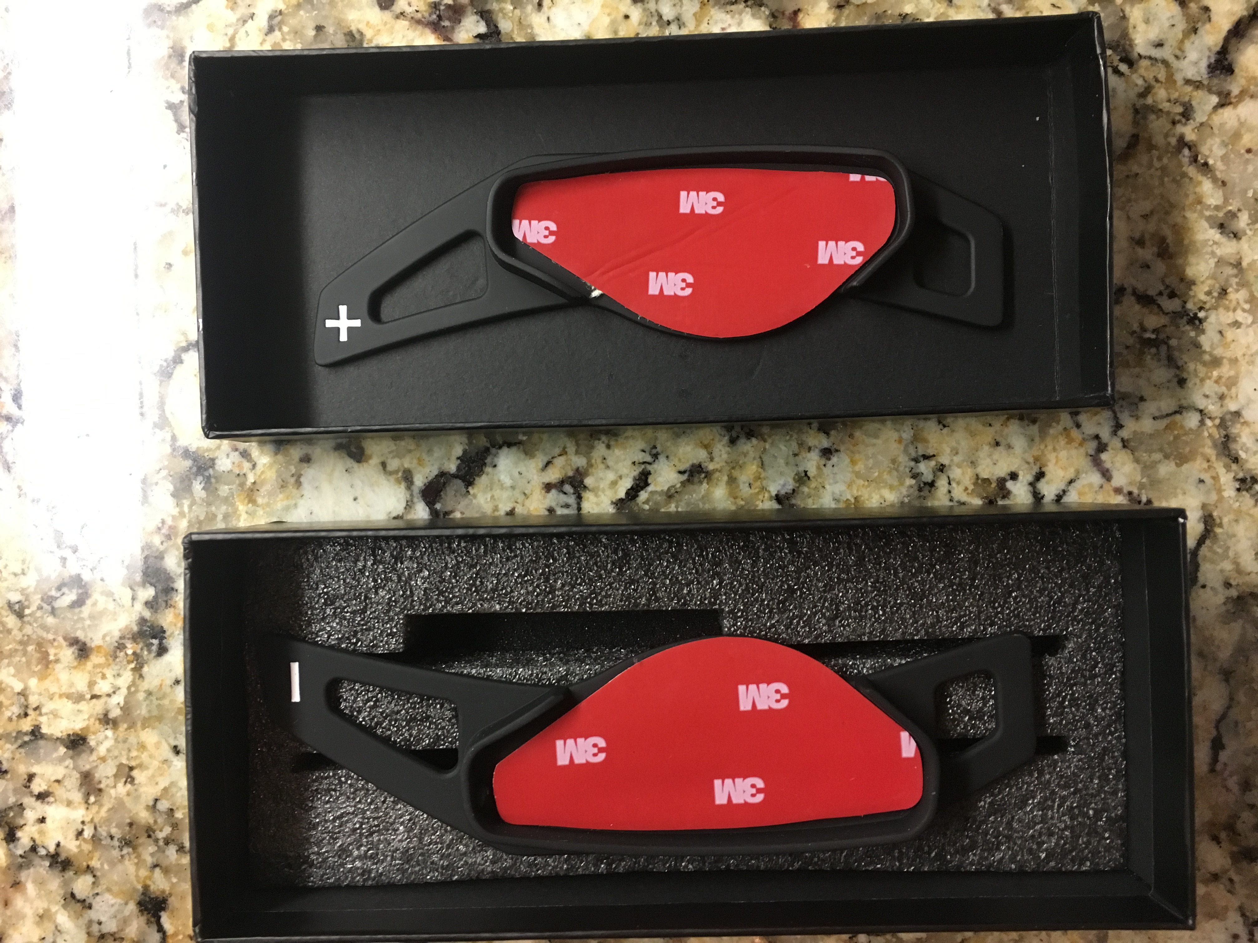

Paddle shifter extensions installed
Starting off small but since I drive my car in manual mode 100% of the the time I needed something more functional. I would have preferred a direct replacement for our factory paddles but these extensions that I found will get the job done just fine. There are made of aluminum and the black matches with the factory paddles to give it an OEM+ look. The fit is spot on and shifts are firm like they should be. The installation only takes 5 minutes to do.

I fitted similar paddle extensions to my XFR, but I tired of them after a few months so I took them off.
Point is, that 3M tape sticks incredibly hard and they were a right royal PITA to remove.
If you just try to tug or lever them off you risk snapping the paddle or the mount.
What eventually worked for me was to soften the glue first using a hairdryer, and then pull them off by steadily pushing the centre of the outer edge of the extension away from the paddle.

Thanks although I'm not looking to take them off any time soon since they work great. Also, an easier way to remove them is to simply unbolt the original paddles from the steering wheel and then remove the extensions at that point.
