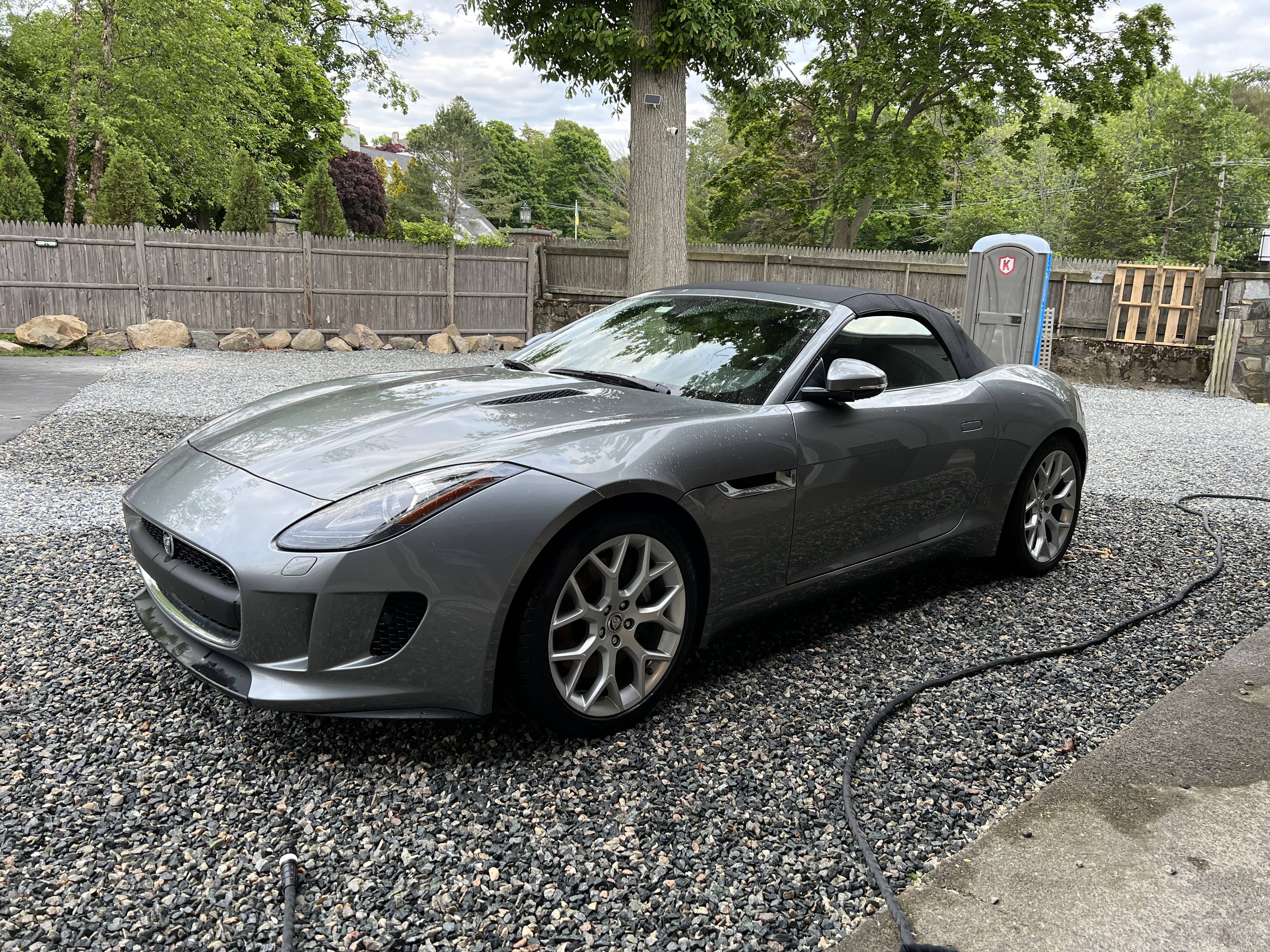

Gave her a quick bath today to celebrate

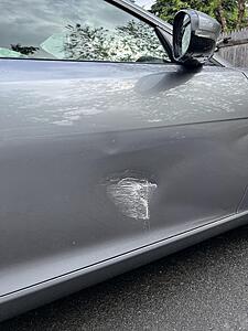

less than 48 hours after OzXFR helped me fix it...while I was visiting my parents their contractor backed into it...
body shop can't get to it until July 25th but at that time we're going to do the whole car and get rid of all the little rock chips and paint blemishes -- basically make her new again -- hopefully next season is a little less eventful than this one
