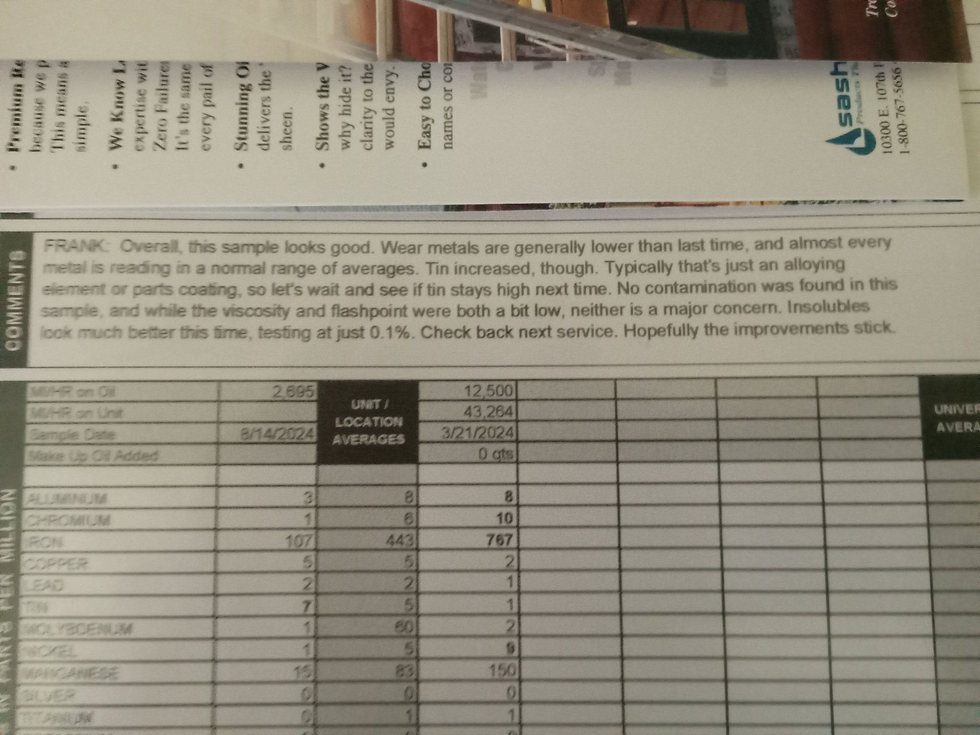

Unusual noise (groans only way I can describe it) searched forum, as one would say, first time I heard that. Some background 2016 s that had differential replaced at 43,000 on 7/21 under warranty. Noise appeared recently. Replaced differential oil
with redline LS 75/90 at 56,000 on 3/24 due to groan noise when driving forward and reverse at slow speed, still there added LS dif additive still there at 59,000. I’m thinking replace oil redline 75/90 again send out oil for black stone analysis. If there was some sort of binding I should feel some jerky decrease in movement. Photo of black stone analysis. Anyone have a similar thanks in advance for your comments. Cheers Frank

Update on groaning noise. Dumped the redline ls 75/90 and replaced with Motul 300 Ls and oil additive. Solved the issue. No moans groans or odd noises. Sent oil for analysis results I've added thread. Cheers Frank
