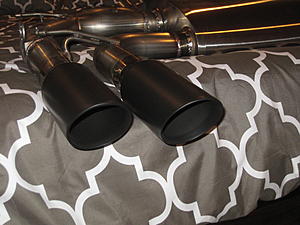

I wanted to coat my tips gloss black but couldn't wait. Easy install. Might ceramic coat them over the winter.

So I wanted to write a quick review of the VAP valvetronic exhaust Stuart was kind enough to offer the group buy on. Would have written it sooner, but there were days lost getting the system coated and then my car was at the dealer for some minor warranty work and then I needed some free time to install. Anyways, now that its on the car and I’ve lived with it for a bit, I thought I’d share my unbiased review of the system:
1) Sound:
I doubt anyone could be disappointed with the sound of this system. In quiet mode, under normal/light acceleration, it’s much like stock quiet mode, with slight improvement to the sound, a hint of growl, and some subdued pops and crackles. Not really louder, just a tad better sound.
In loud mode, things get interesting. As others have said, it’s an enhancement of the sound - part muscle car mixed with a bit of exotic. Really fits the personality of the car. A bit louder, but that is not the primary effect, it’s really a dramatic improvement of the sound. More pops and crackles, but also more of an evil growl - just what I was hoping for.
Now many folks are totally satisfied with the factory system, and there is no doubt it sounds excellent – outside the car. But this is why I got the system: my car is a coupe, and I find I’m always driving with the windows at least partially down. With the stock system, in quiet mode I heard no exhaust sounds, and in loud mode I just heard a muffled growl. With the VAP system, you get a much richer experience inside the cabin, at least in loud mode. In quiet mode, you hear just a hint of sound. For me, that’s exactly what I was hoping for. So I give the system top ratings for sound.
2) Appearance:
Tips: So this may be even more subjective than sound, but I think the tips are perfect – bigger than stock, they really fill up the exhaust tip opening and they are just the right length. The angle cut looks cool and it has an expensive look to it. I think this is how the car should have come stock. Oh and no matter what exhaust you have, do yourself a favor and get the tips ceramic coated black – looks great with every F type color.
Muffler can: I have to deduct a few points here. The can sits a tad lower, and a bit too far forward. And it is not as wide and the factory system – so it sits in the middle of a wider space and well, looks aftermarket. Especially in shinny stainless steel. I solved this at least partially by painting the rest of the system black (originally I just had the tips ceramic coated by a local shop – should have had them do the whole thing.) Painting it makes it barely noticeable, and even then to see the muffler you are 15 feet or more behind the car, so it’s not a huge deal.
3) Weight – VAP system is a legit 8-10 pounds lighter than factory system. Noticable on a 3800 pound car? No, but the cumulative effect of this and other weight saving measures (e.g. delete eco battery, lighter wheels, engine cover delete, etc) may help a little.
4) Fit/finish/quality:
Easy to install, if you have ramps and basic tools, you can do this in 30 mins or less. I bolted mine up and the tips sit perfectly centered, so high marks on alignment/fit. As for the system, the bends and welds appear to be smooth and professionally done. Too bad we need to cover up all that beautiful stainless steel for aesthetics reasons, but at least we know the system will last. Another consideration regarding fitment, apparently some F type coupes have an extra brace around the differential like the convertibles do. If you decide to try one of these systems on your car I’d recommend shooting a picture of the differential and sending it to Stuart so you can select the proper model for your particular vehicle. Seems to be no rhyme or reason to it, some coupes have it, some don’t.
Final verdict: Very nice system overall, with only the smallest nits to pick. It is one of the few systems I’d be willing to put on my f type, and for me the adjustability is important so for now its really the only game in town. Those that wear Nomex suits and flame proof underwear on their drive to work may want a louder system, but most will be impressed with this simple axle back system.
