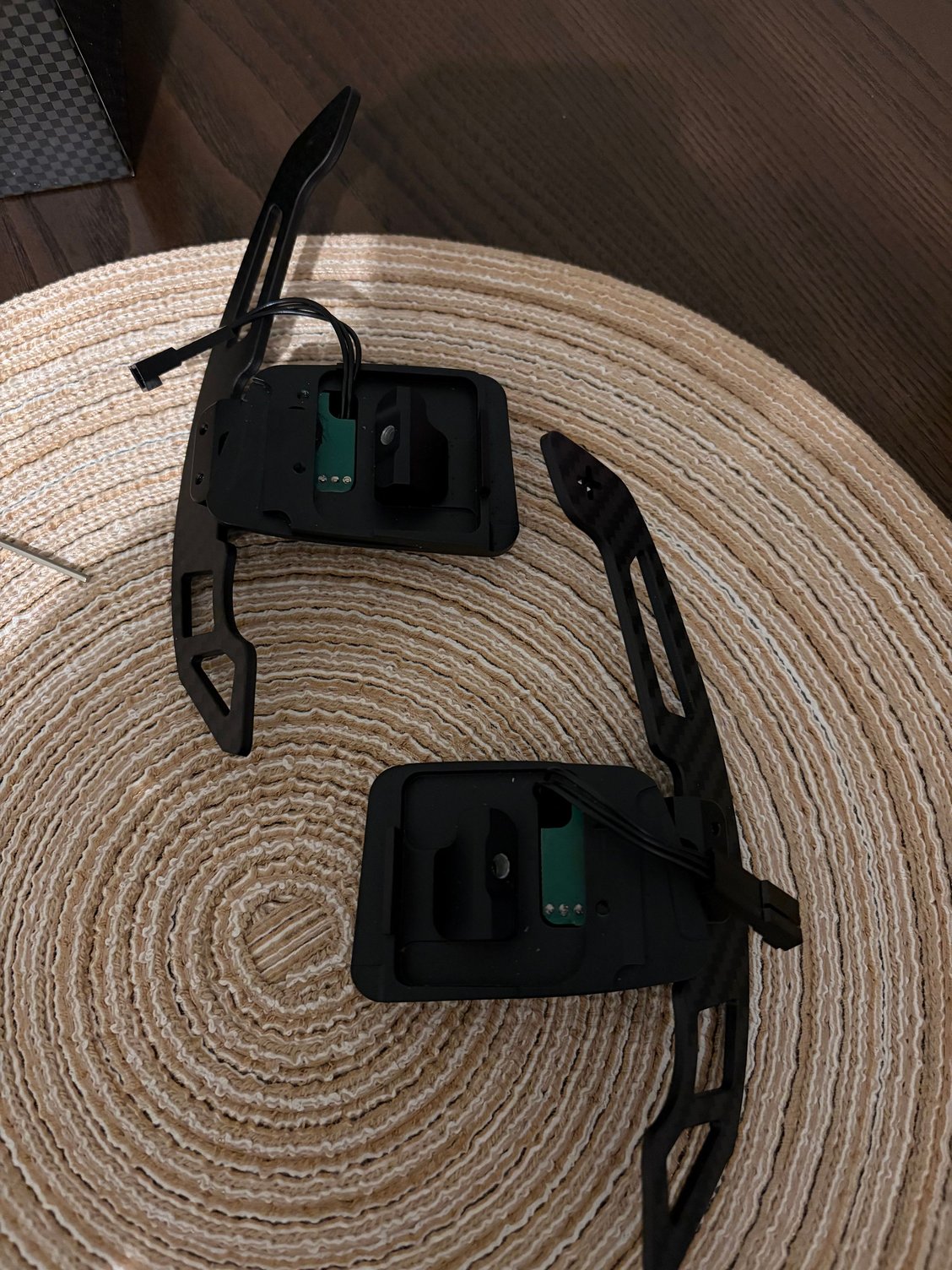

Mine showed up today, and I installed them immediately. Just finished a 30-minute shakedown run, here are my impressions.
Installation was extremely straightforward. A T20 Torx, one screw per side, unplug the two-pin harness, swap the module, reverse the process. Total time was maybe 20 minutes, it’s completely plug-and-play with no errors or warnings.
On the road, the difference is noticeable, in a good way.
These magnetic paddles are definitely louder than the OEM setup, but the tactile feel is dramatically improved. The click is sharp, clean, and consistent, with zero mush or vague travel like the factory paddles. Every pull has a precise “break point,” and the return is fast and positive. It honestly gives the car a more motorsport-focused character, especially in manual mode.
Compared back-to-back with the OEM paddles (which feel quiet, soft, and almost rubbery), the magnetic set feels like a proper performance upgrade. Upshifts are more positive, downshifts feel more intentional, and overall the shifting experience becomes more satisfying. No free-play, no wobble, no weird noises just a high-quality mechanical click.

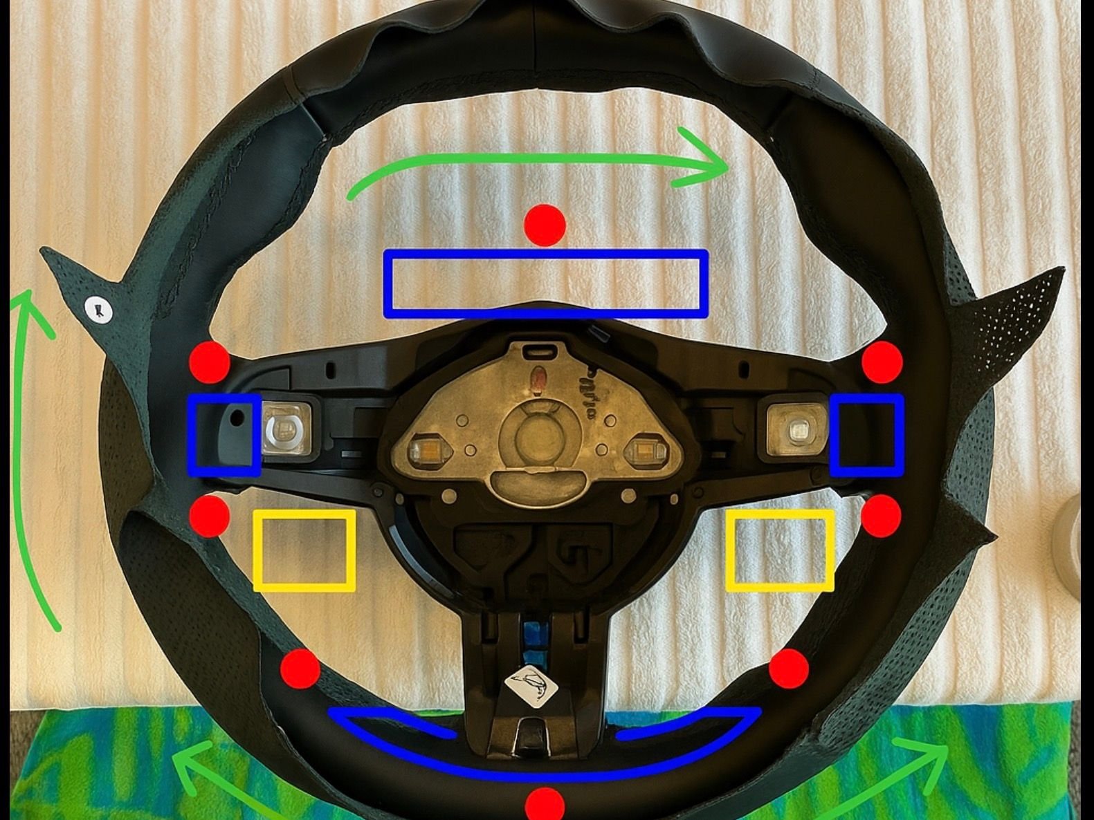

I ordered a custom Nappa leather steering-wheel skin with perforated side grips for my 2023 F-TYPE P450. The stock wheel always felt a little too soft and not as sporty or high-quality as what I’m used to in my Audi, Porsche, or BMW M cars.
Because my car has the heated-wheel option, it’s nearly impossible to source a full OEM replacement core or a flat-bottom wheel from overseas without losing that feature or going remanufactured/aftermarket. So for about $120 and some hands-on time, I decided to re-wrap the factory wheel myself and install magnetic shifters at the same time.
Here are the before-and-after photos. I used a small amount of leather adhesive to keep the seams tight and ensure the button panels fit cleanly. I also removed the slightly crooked 12 o’clock stripe that came from the factory. This photo was taken right after the install—Nappa leather naturally shrinks and settles over the next couple days, smoothing out any minor waves.
It’s been years since I last did a leather wrap (my previous one was on my 1991 Toyota MR2 Turbo), and I’m definitely older now—but it turned out great. The wheel feels far more premium and sporty than OEM, and I kept every factory feature, including the heating. It’s still the original wheel—just better materials and the magnetic paddles.

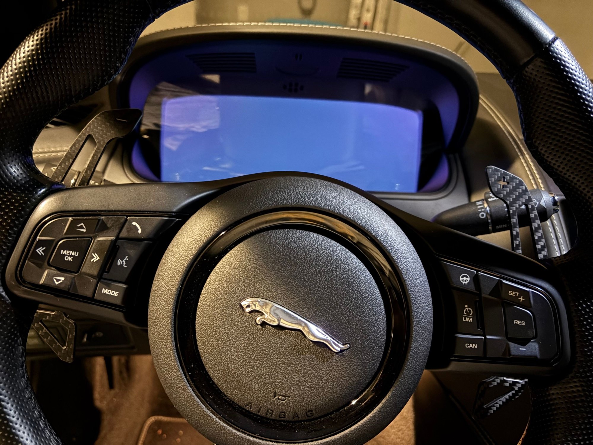

This install was extremely agonizing for what should’ve been a simple job. Whomever said it takes 20 minutes - I vehemently disagree. I’ve been struggling to get one shifter installed for over an hour due to stripped screws. The wire connector on the back of them is too long and I can’t get the screw threaded through the paddle assembly to fully connect. That’s after struggling to unscrew the original T20 screw for what seemed like forever. Not a fan at all so far.
the main issue is unless you take the steering wheel off - which you don’t NEED to do - you’re doing the job pretty much blind or at an odd angle at best.

Update: fortunately the second paddle went a lot smoother than the first. Probably took me about 15 minutes for just the second one but they’re on.
i went for a quick ride around the subdivision to ensure everything worked probably and the feel of the shifters is a lot more substantial for sure. They’re a lot louder. They make a satisfying “CLICK” whenever you press them, but the thing that surprised me is how much more pressure you need to use to actuate them than with the OEM paddles. I can definitely see how it isn’t for everyone but I think I’ll enjoy them. Pictures attached.

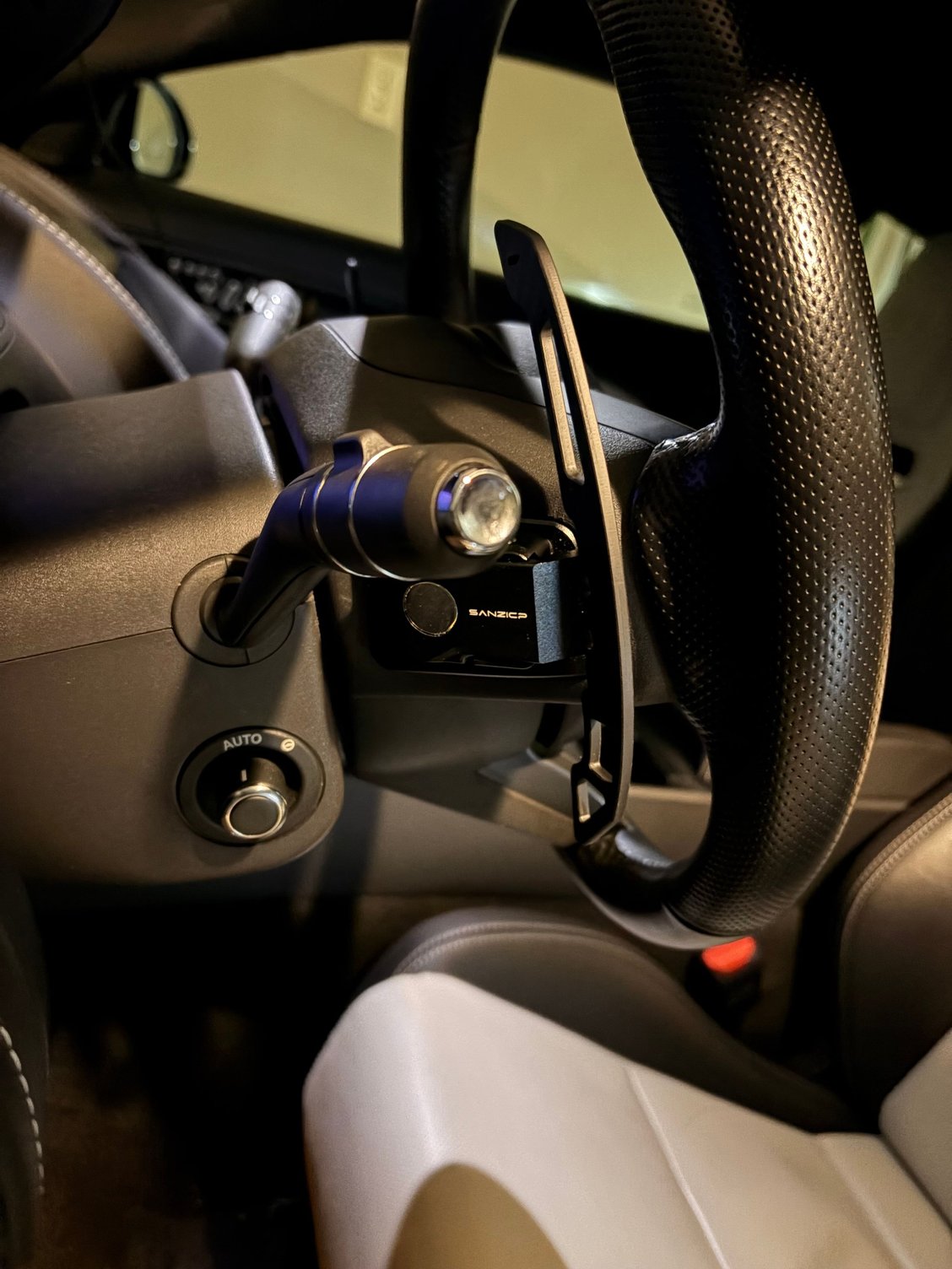

Fitted these paddles yesterday. Weather's been crap so I've just tested them on a short drive and still have to see how they feel during some hard driving but I'm pretty impressed by them so far. They feel really solid and what makes a big difference is that the whole base is out of metal. The paddles themselves are also incredibly stiff so there's no play anywhere and the shifting feels much crisper than before.
Super easy to replace and fit perfectly. Some 2 minutes per paddle if you know how to do it. I've removed and refitted paddles like this loads of times so it's a quick job. Best thing is to turn the wheel 90 degrees and drop it as low as possible to make it easy to access a paddle from below/behind.
I chose to fit the bigger paddles because the smaller just seemed too small and clearly smaller than the solid aluminum paddles I've had so far. Was a bit unsure about the looks before I got them and think they would look a bit out of place in a car without any other carbon fiber details, but now it feels like they blend in really well with my my interior since I have the interior black pack and original matte carbon center console panels plus the carbon blade wheels. I thought I'd order some additional replacement paddles with a different design but am not so sure now.
There's a bit more resistance than in the OEM paddles and I can imagine there's even more resistance if you fit the smaller paddles.
As pointed out they're surprisingly loud. It's not the microswitch that that clicks but it's actually when you pull the paddle all the way and hit the metal base, and then also when you release it and the magnets snap back together that you get pretty loud clicking because everything is made of metal.
I think it's a bit unnecessary that you can pull the paddle surprisingly far beyond the actual shift point, until it hits the base and clicks loudly so I'm playing around with some minor mods. I added automotive felt tape on the surfaces between the magnets and some damping rubber on the base so that you can't pull the paddle that far after the shift point. That significantly quietened them down and shortened the paddle travel.
To be continued but so far this feels like a really good update from the old JLR parts bin OEM paddles. This mechanism is on a completely different level than the OEM one which will feel mushy no matter what paddles you attach to it due to the plastic base and pin setup.
