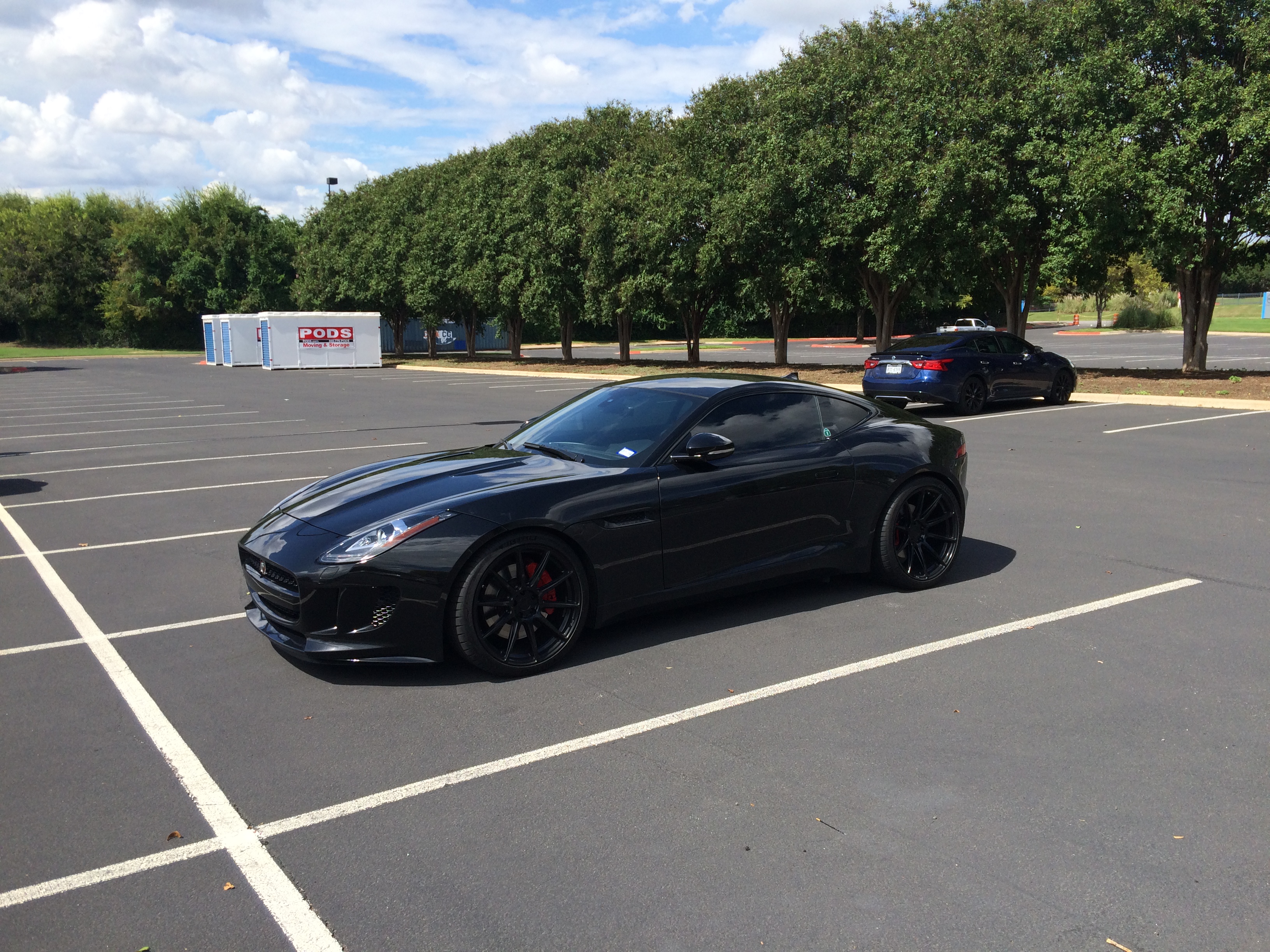

Eibach springs installed along with 15mm spacers. Still a slight rake, but overall, really happy with the height.

Looks great! How's the ride?

Smaller bumps are slightly harsher. Almost as though a bit rougher around the edges, but that's to be accepted with a lowering spring so I'm still overall very satisfied. Due to the mild drop, I'm not noticing any pogo affect which I was previously afraid of either as it seems the damper still has a decent amount of travel.

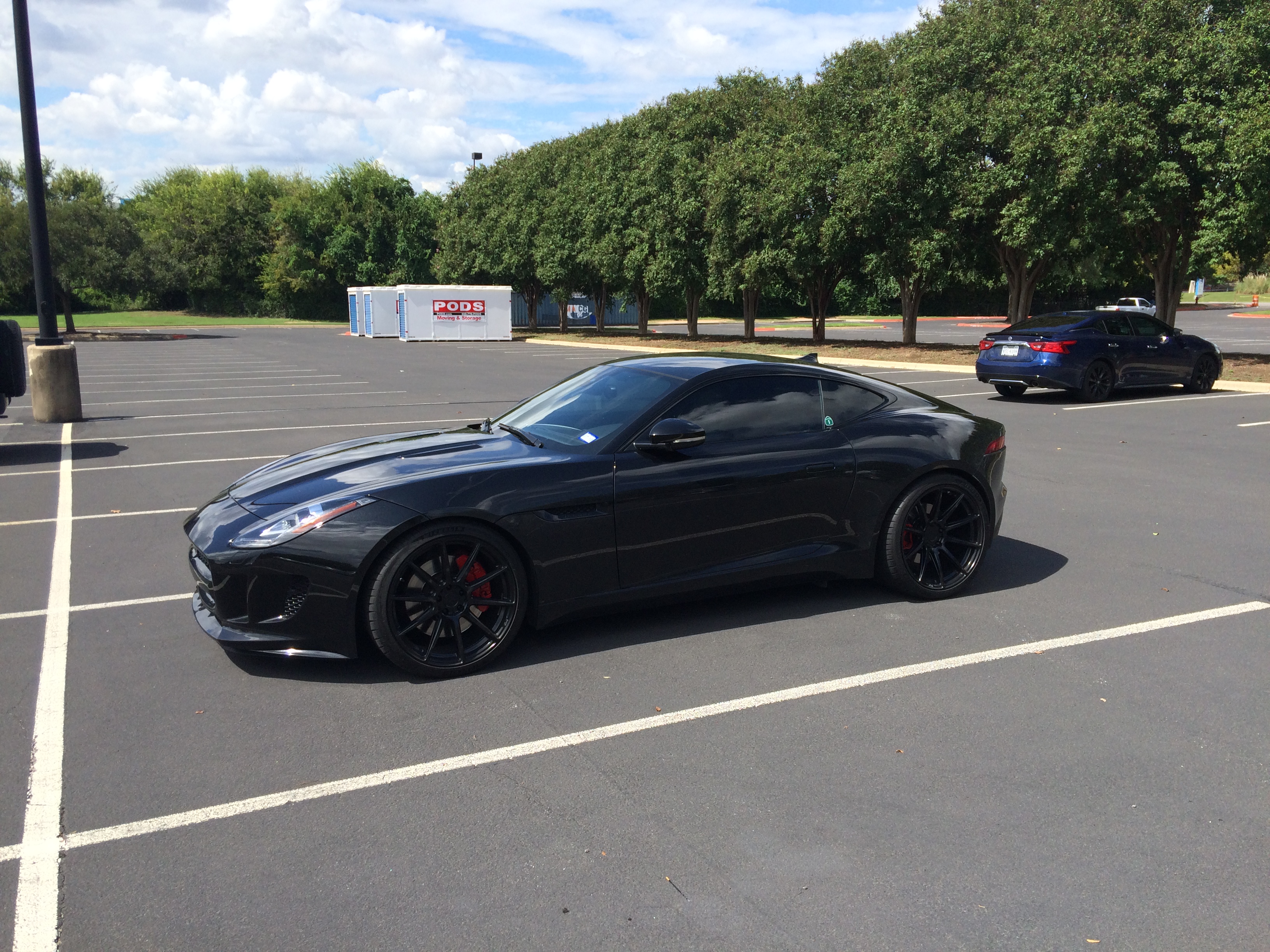

Only one more unfortunately, but can snap more once back in TX.

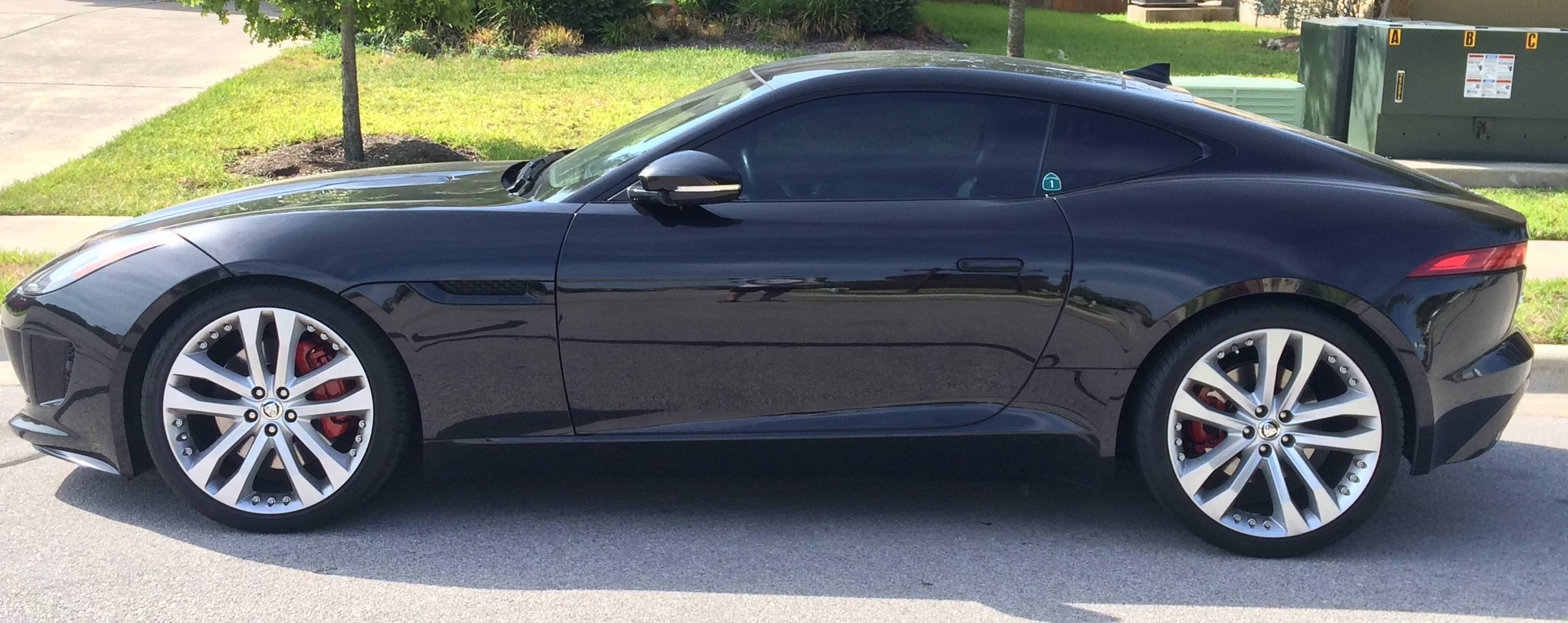

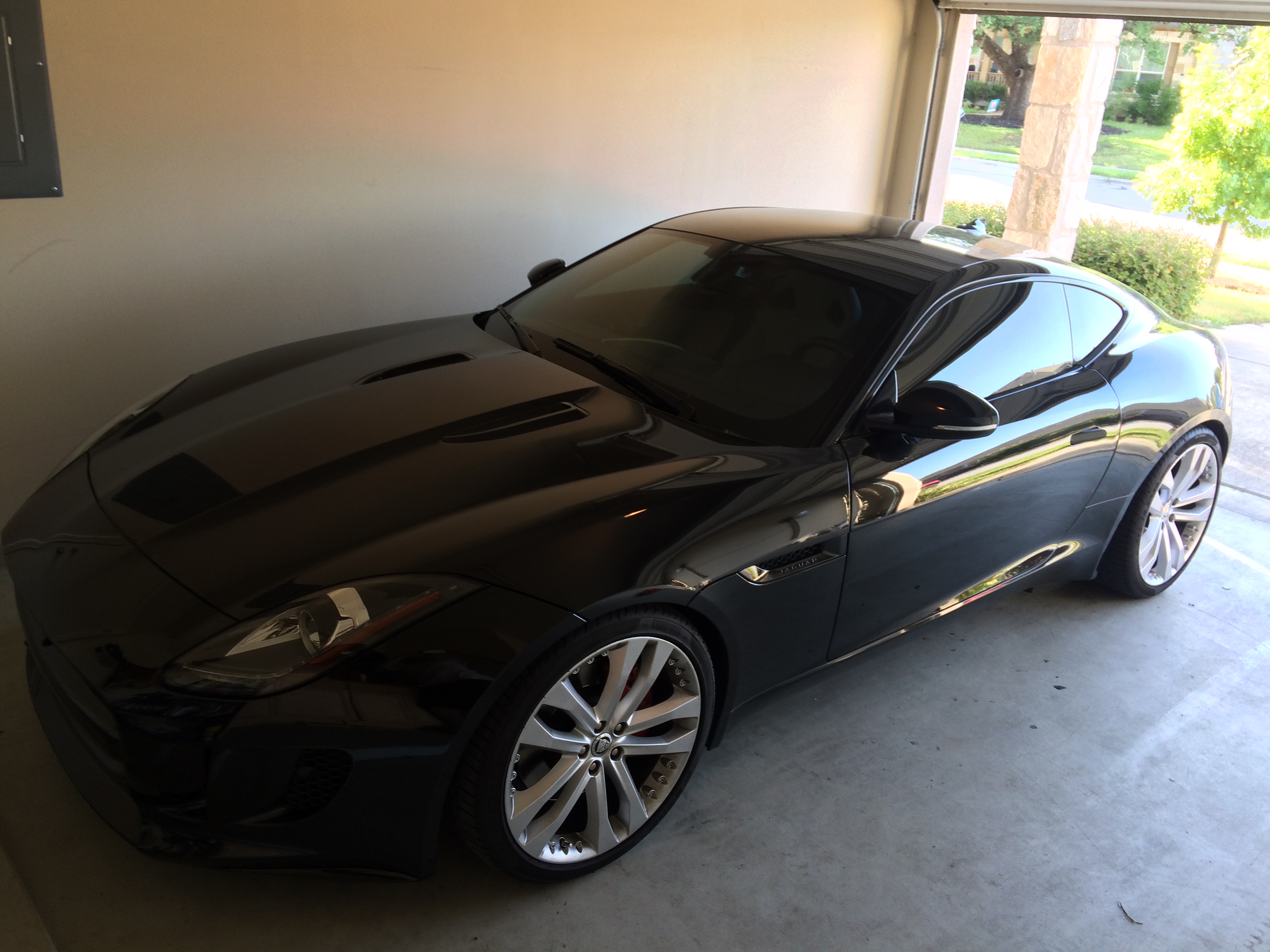

Almost forgot to add a few more pictures here:
