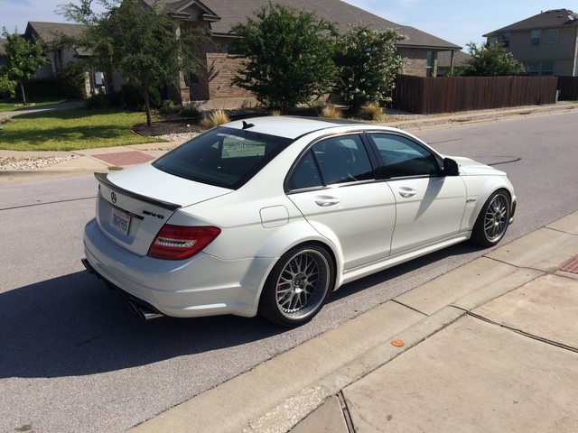

I think so too. Do you have pictures of how your car sits with the Eibach springs? Other than wheel spacers, I do not plan to modify the car at all. I'm coming from a C63 AMG which I heavily modified so want to take a break from that for a while.
