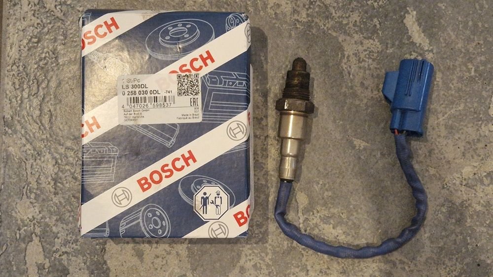

3. Jaguar tried a range of O2 sensors after high failure rates with early sensors, causing expensive warranty replacement costs. You will have to search by VIN number to find the correct JLR part number. The part numbers vary based on manual/auto transmission and AWD/RWD. This is mainly due to different O2 cable lengths caused by the differing configurations. Go to > Jaguar Palm Beach parts and search for Oxygen Sensor (Rear Lower) that matches your VIN range. The left and right sensors are the same on the 5.0L models. The JLR Dealer costs are very expensive, but all the F-Type O2 sensors are actually Bosch, so once you have identified the correct JLR part number, do a Google search for the equivalent Bosch part number as this will work out much cheaper.
I've just replaced the Bank 1 Sensor 3 on my 2018 V6 Dynamic, JLR cost for T2R54607 = £217, Bosch original = £58. It's a relatively easy job as long as sensor is not seized. Easier if you have access to car lift, but can be done with rear wheels on ramps if you are slim I'd say 1 hour tops. Don't forget anti-seize compound on new sensor threads (don't let it touch sensor tip). You will need ICarsoft or Dealer to clear the MIL once new sensor fitted.

Also the sensor 3 failures are typically the heater circuit.
