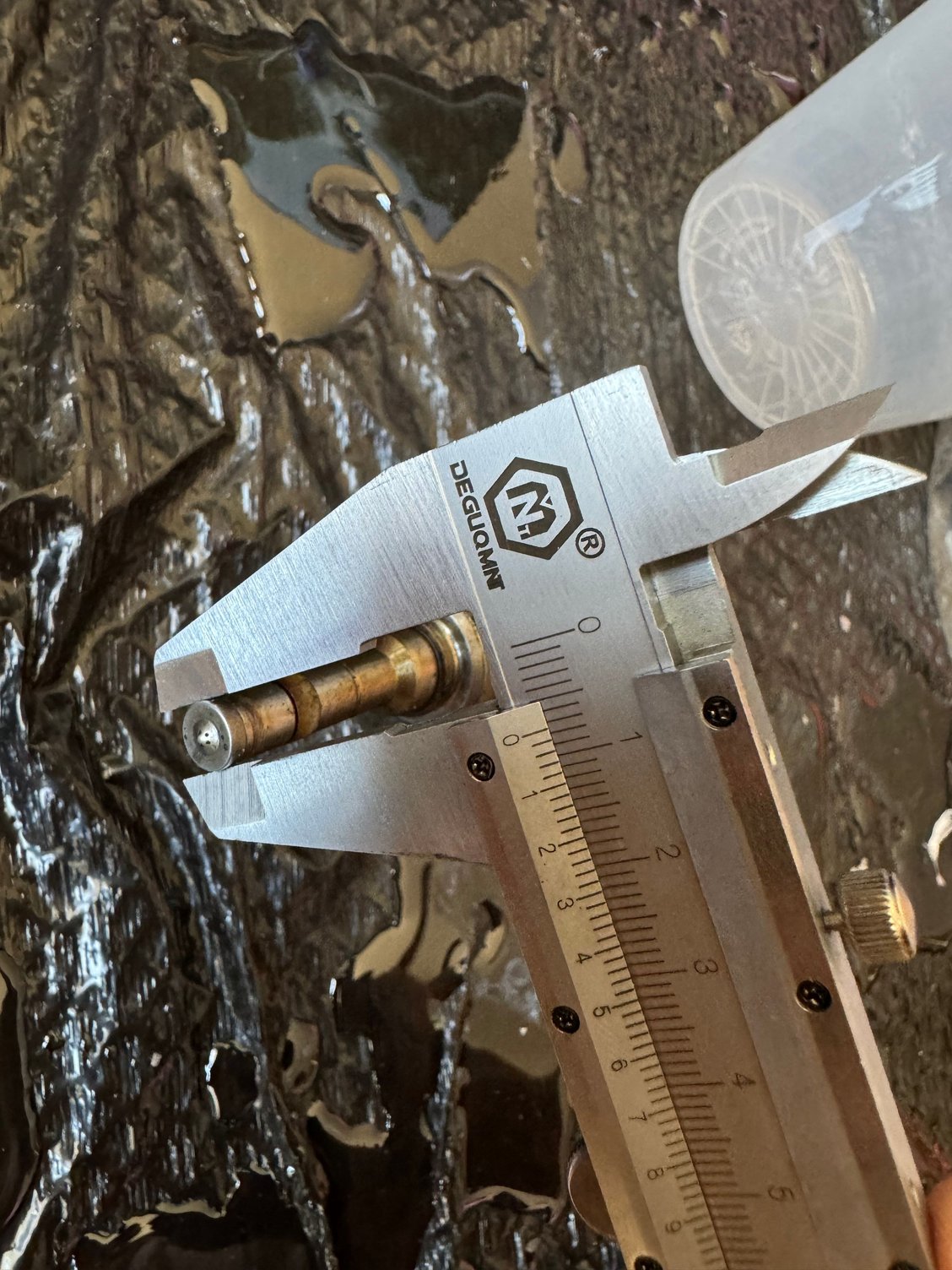

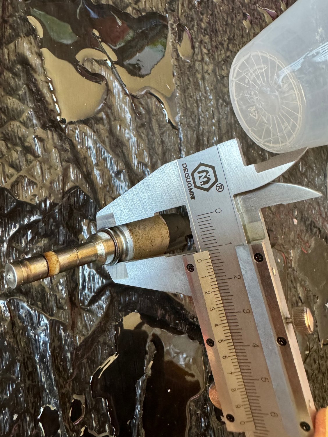

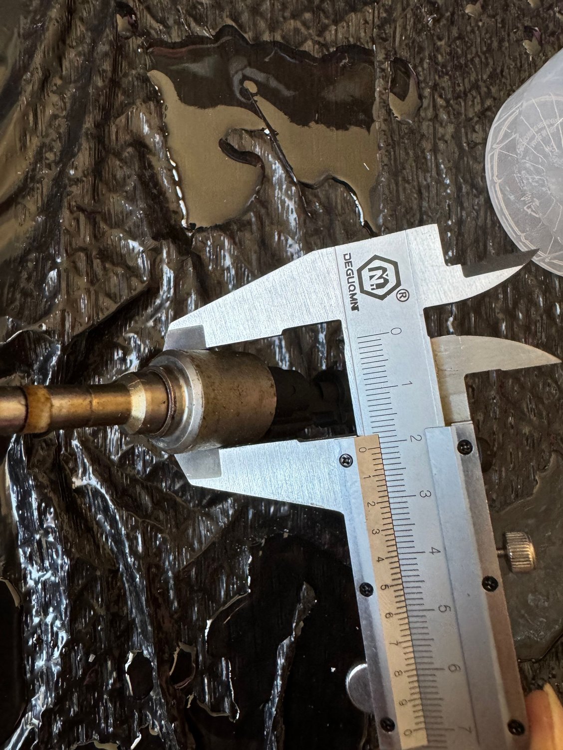

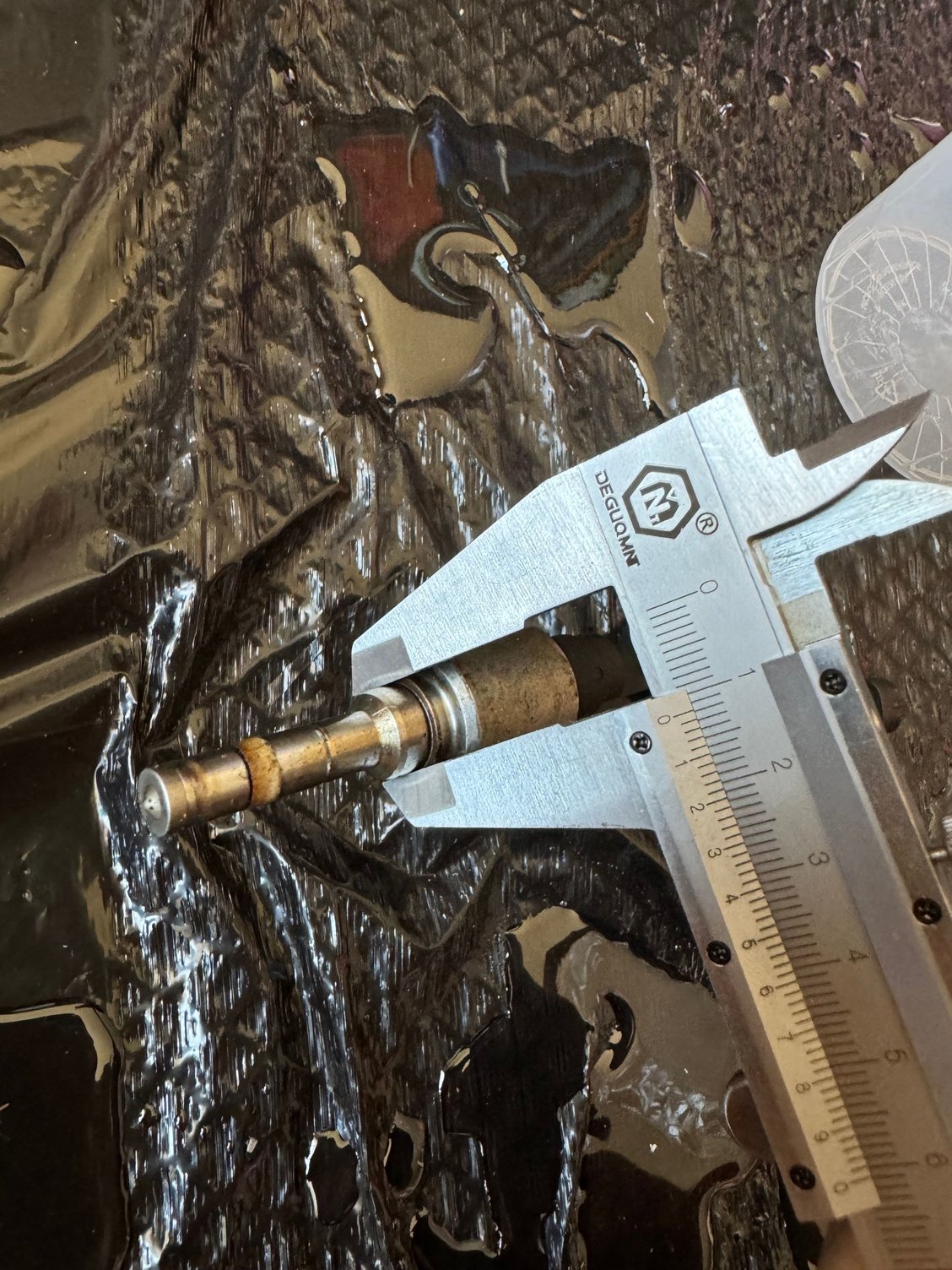

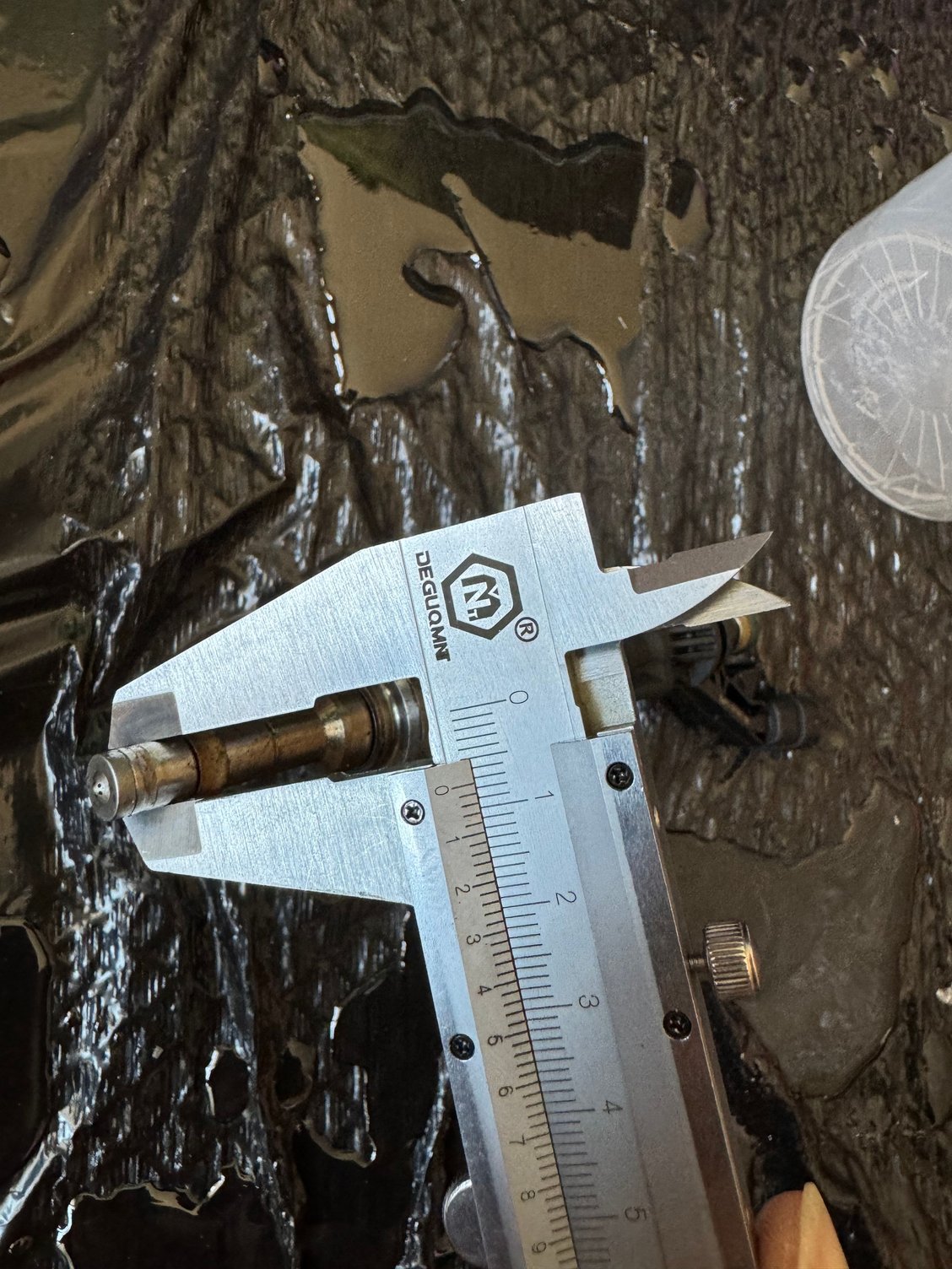

NBcat do you have what sizes the brass brushes should be?
We will need two sizes. The small one to clean the tip area out and a much larger one for the metal body.
I have not been able to find the dimensions of these injectors at least for the area's that need brushing?
Here are the area's I need to get the right sized brass brushes for.
Thanks to anyone who can provide these diameters.
Old May 28, 2024 | 11:05 AM
  #31
Ray Ray's Avatar
Joined: Dec 2019
Posts: 666
Likes: 184
From: NYC
I will get them for you in a bit, anything else you want to know except how it tastes?
og part from 2015 R, injector production date: 2014

Ray Ray that was WAY more detailed than I ever expected!!
Thanks so much and great pictures too!
Saved them just for this moment!

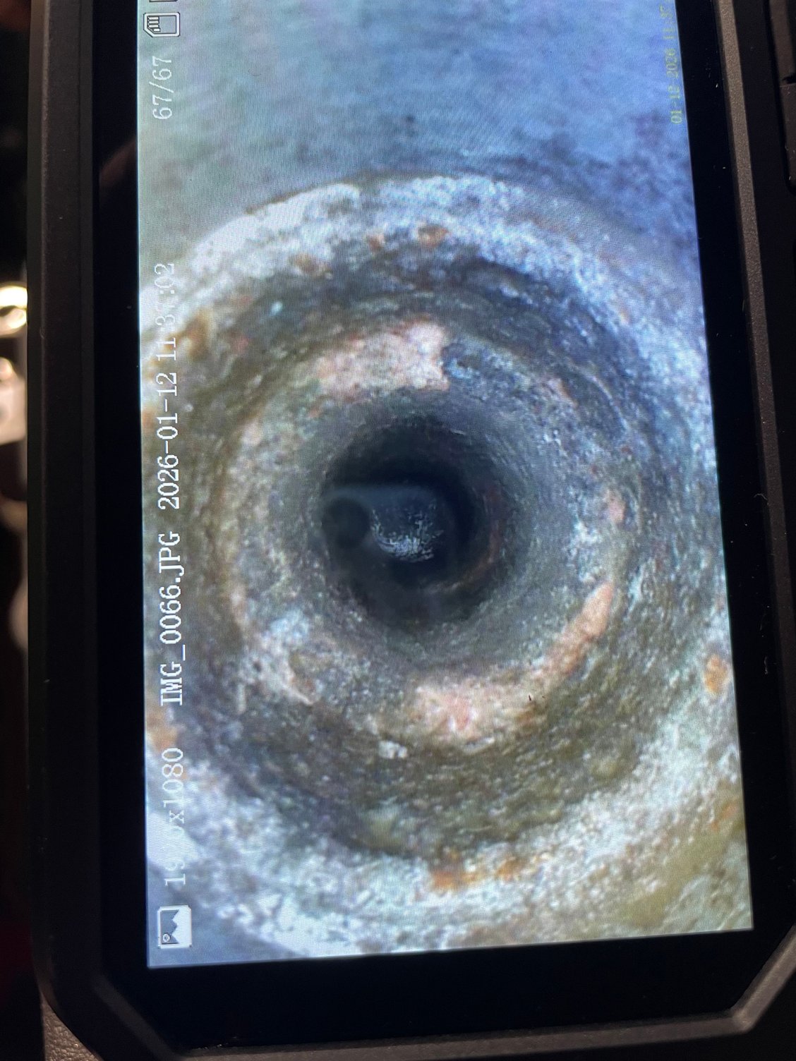

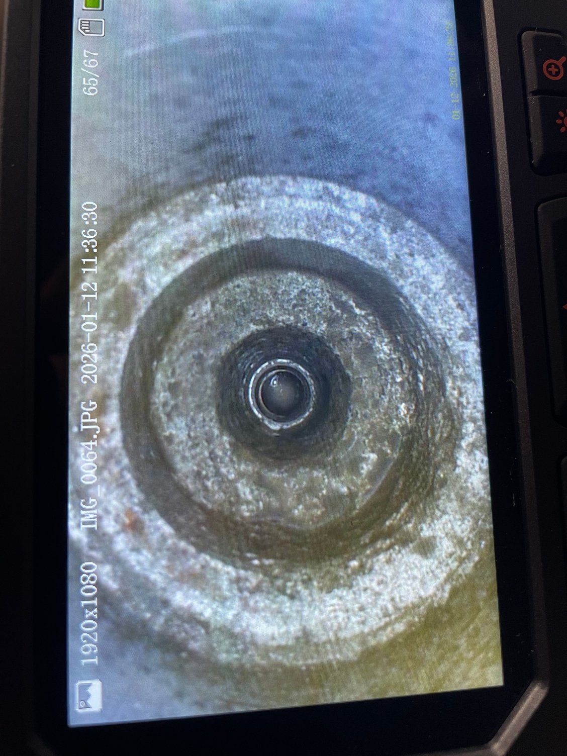

Any ideas of that can be restored without pulling the head and taking it to a shop? These 2 injectors was a real pain to remove.

Originally Posted by randyb
I used a brass brush and a little bit of corrosionX.
My concern is the oxidation(specifically cylinder 5), not the stuck tip of the injector. That is easy to push inside and catch with a magnet through the spark plug hole.
