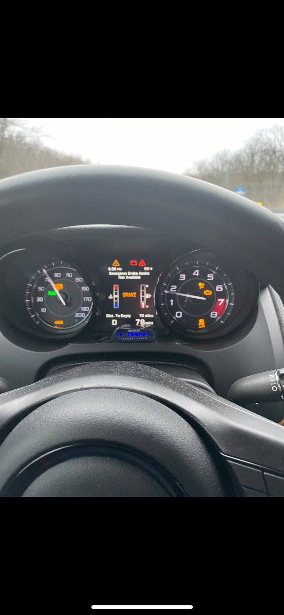

Ive been having issues with 2014 v8s 20k miles, All the warning lights you can imagine start going off. Abs, active dynamics, stability control, e diff, etc etc. Convertible top also will stop working. This happened at random and after the car sitting for a little, everything is fine again. I suspected low voltage battery, but testing battery showed its fine. Replaced it anyways and hoped all would be good, then last night it happened again, disconnected battery for 30 seconds, and car was fine again. I have no clue whats going on with the car, and some other posts on the forum seem to have the same issue, wondering if anybody was able to find a solution? I dont know what to do. Maybe its one of the other batteries? ive heard theres 2-3 batteries in the car? or the alternator even though it tested fine? The warning lights start as one or two, then shortly after everything you can imagine is flashing on the dash. This all started after i had a battery drain issue from the OBD2 port, and took a couple weeks to disconnect the battery and reconnect it.
