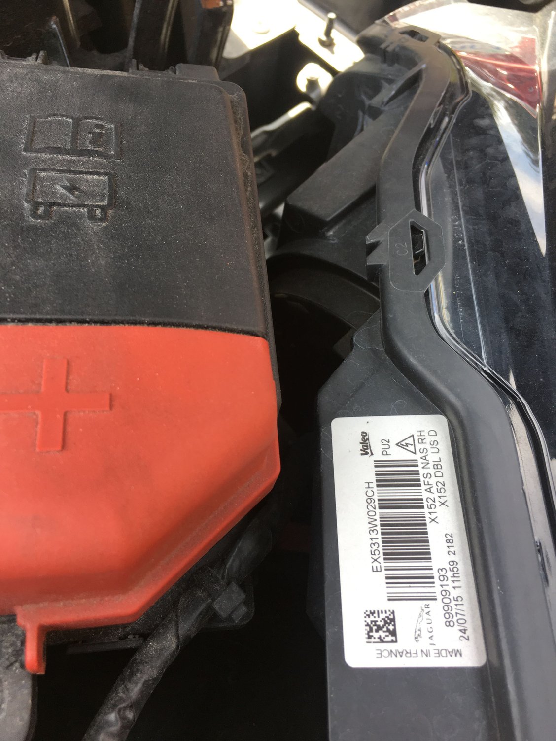

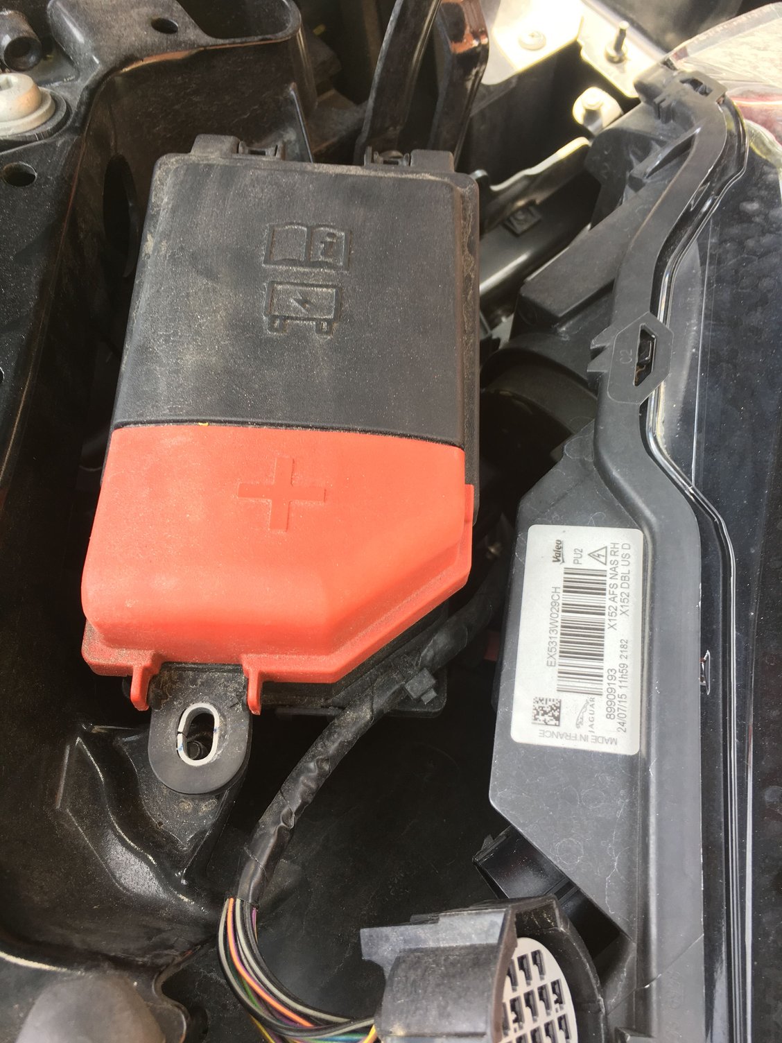

I'm stuck, there is the front charging box in the way and I can't access the bulb. I've removed the bolts and it will not move out of the way because of the big Red cable being routed under the car.

I replaced both bulbs about a year ago, and for the passenger side one (driver's side for me) where the charging post is (under the red cover shown in the pics above) I undid the bolts holding the box down and managed to move it out of the way far enough to access the rear of the light cluster, just enough to get the dust cover off, the OEM bulb out and the new bulb in. But it was a real chore and resulted in lots of skun knuckles. Maybe I had more play in the cable than the OP does, but there was just enough slack to move the box an inch or so.
I found the bulb on the other side was even harder to get at, and in the end I undid the bolt which holds the power steering reservoir in place and moved it out of the way, but again I could only move it juuuust far enough to gain tight access to the back of the light cluster.
If I ever replace the headlight bulbs again I intend to try loosening the bumper off and removing the light clusters from the car, I read somewhere that you can get the lights out this way without having to completely drop the front clip.
