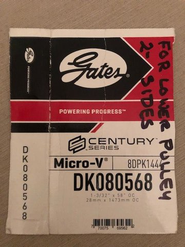

I’m using a Gates DK080578 (8DPK1444) belt that is specified as a 28mm x 1473mm OC (1-3/32” x 58”). Just barely long enough, but leaves the tensioner plenty of travel to take up any stretch.
Interesting. As I'm in a bind, I looked up that exact belt, but I had a tough time locating a place it would sell up here, in Canada.
As the stock OEM belt off the V6 is 1438mm, and the proper VAP belt is 1460mm, how does 1473 work? You said its too small, but wouldn't it be too large?
what was the OEM belt size that came off yours?
I thought you used the DK080568 (at least back in post #27 that is what you said) and the gates spec says its effective length is 1444mm. Link:
https://www.gates.com/us/en/power-tr...0/v/8550-01028
Also I don't think there is a DK080578 belt. I can't find one on the Gates site.
PS: My previous post said the belt was a DK80568 in error (since corrected). Sorry for the error.

Doh...yes it's a Gates DK080568 (8DPK1444). 1473mm Outside Circumference (1444mm cut length). Available from Eurotoys.
Hi Lance,
Just to be clear, your 1444mm centreline belt would be a good length (so would OEM JLR 1438mm) for your car. HOWEVER - you also have an earlier production date vehicle, with a different tensioner assembly to the gentleman who is posting about his FPace. Your OEM belt length would be 1412mm. His OEM belt length would be 1444mm. If he bought the belt you're talking about it would be SHORTER than the one we shipped him.
Not having a go at you at all, I just wanted to clarify because people are now talking about cars that have different OEM tensioners and belt lengths, and we have people confusing Outside circumference with effective belt length which is measured through the centreline.

No, we don't have a double sided version of the DK080568. The effective length of that belt would be 1442.75mm. The belt we have made is 1461mm.
Also worth noting, that the industry standard tolerance +/- is generally accepted at around 2mm - so regardless of who you're buying a belt from, say, a 1444mm OEM belt could be 1442mm or 1446mm.
The other reason the Dk080568 (which is double sided) works for me is that I have the smaller SC pulley as well.
