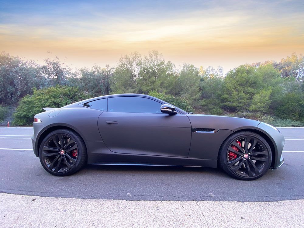

Default If anyone is wondering how to remove the mirror covers
Pretty easy, I removed mine to vinyl wrap them in gloss black, if I can do it, you can do it :]

it's not too late.

Just wanted to add a slight tweak. The way I take the covers off is to use three trim tools or flat screwdrivers to release all three upper clips one at a time and leave the tool in place so it cannot clip back in again, you can then easily rock the cover off starting at the outside edge with no risk of snapping the retaining hook/tab off the bottom. If you find yourself doing it often you can cut an old credit card into three lengths and slide those in then you only need one tool to release all the clips.

For the whole car. I find the thicker vinyls protect the car more as mine already got rock chipped.
