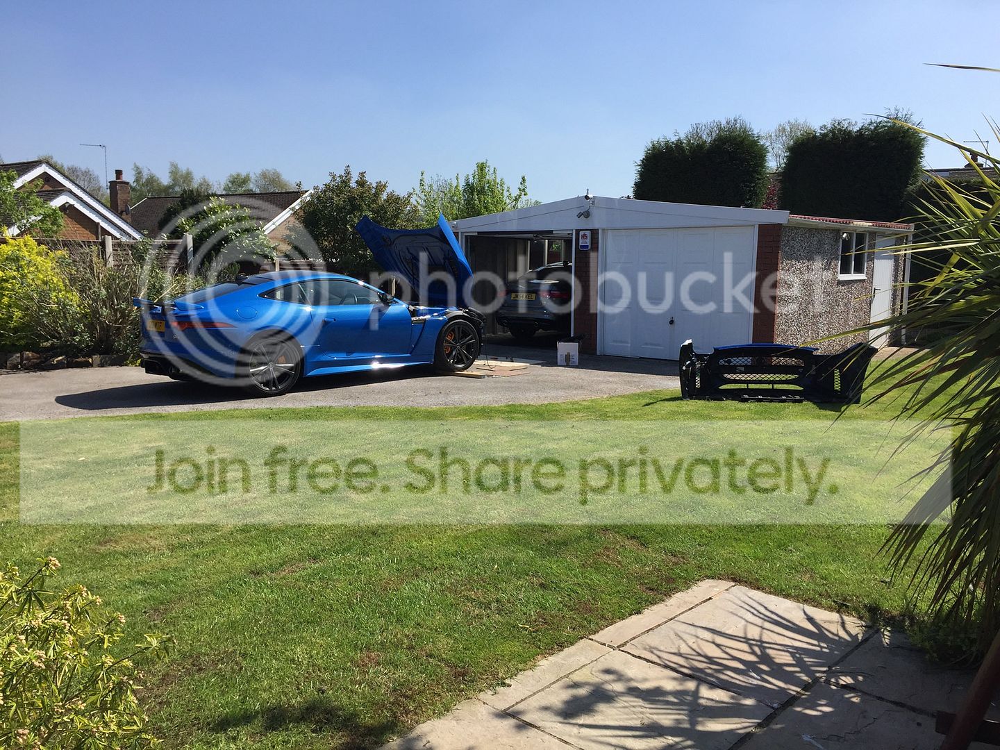

Hi there
OK so today I decided to perfect the RAM air install by using some larger ducting as for my trial install I just used some 60mm spare brake ducting I had spare. So I ordered this from kit from ebay:
https://www.ebay.co.uk/itm/Cold-Air-...72.m2749.l2649
Which is 76mm and has neat ducts on the end, chopping this in half pretty much makes them spot, just shape the ends going into the ducts slightly square by squshing them a little and they then fit perfect, snug and tight.
I wrapped the metal ducting ends in some foam and then insulated in tape, reasoning behind this is so they don't clang against the metal crash bar as any metal on metal knocking could of course create a false knock situation, that is why the ends in the photos are wrapped in tape, but within that tape is foam to make sure that does not happen.
Using cable ties you can hold the ducts in the exact position you wish.
Photo of stock setup and my trial 60mm ducting:
The new 76mm ducting:
Some photos of the car in the sun.
Its a much neater install, cannot be seen behind the grill with the benefits of drawing cooler air but also been able to catch air in motion to try and a create an ram air effect.
Will it make me go any faster, who knows, probably not but it certainly did not slow me downon the trial setup resulting in a PB of 11.2@124mph in not ideal conditions. Hoping I can get an 11.1s run, which will make me very happy considering the car is still stock and that pretty much then guarantees a lower pulley and map should yield a high ten second run.
