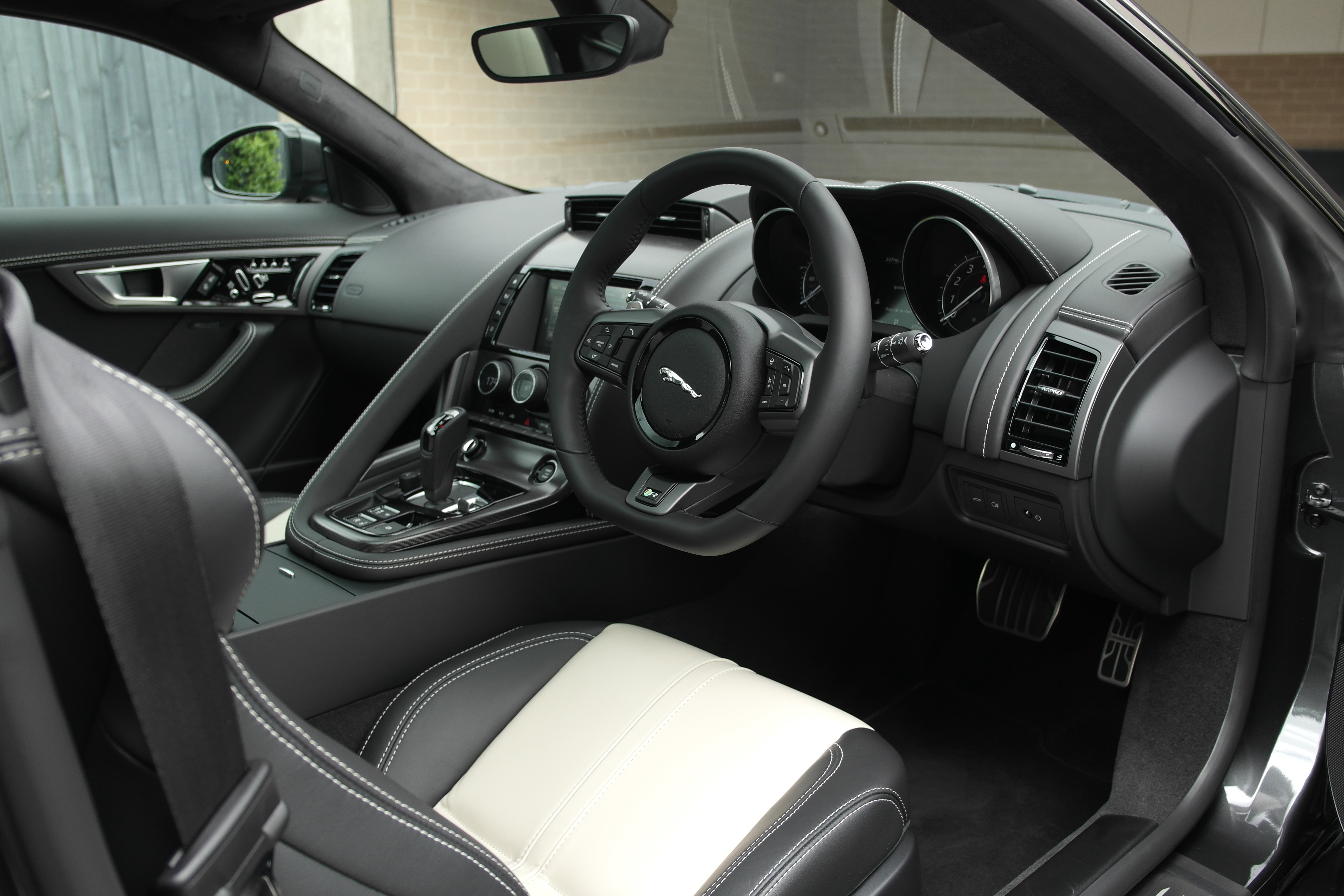

I have the performance seats, interior black pack, extended leather pack and red stitching. I wanted to break up the all black of the center console. So I ordered the original "Ignis Orange" engine stop/start button that came on earlier F-TYPEs. Cost of the button was about $28 picked up from my local retailer
Installation is straight forward. You really need a trim panel removal tool to remove the center console trim as its fitted on very tight. Afterwards everything just snaps back together.
I also wanted a more uniformity with the interior lighting. The footwell lights use a traditional 194 filament bulb. The output is very yellow. Kind of mismatched looking considering that the overhead map lights are white LEDs. I ordered 4500K/85lumen LEDs. 4500K is white enough to match the overhead map lights and 85 lumens is just bright enough where its not too obnoxious or look aftermarket. I ordered the LED's from SuperBrightLEDs. Knowing how electrically sensitive these cars were, I went with a CANBUS compatible setup to avoid any error codes or issues.
https://www.superbrightleds.com/more...ofit-car/1127/
Replacing the footwell lights was a bit of a pain. The bulbs are tucked away to point where you need stick your head in the footwell to see what you are doing.
Before:
Everything is all black. Nothing wrong with that. Just a bit boring.
After:
Just enough color to break up all the black:
LED in the footwell before/after. Note that the light output is very similar but much whiter.
