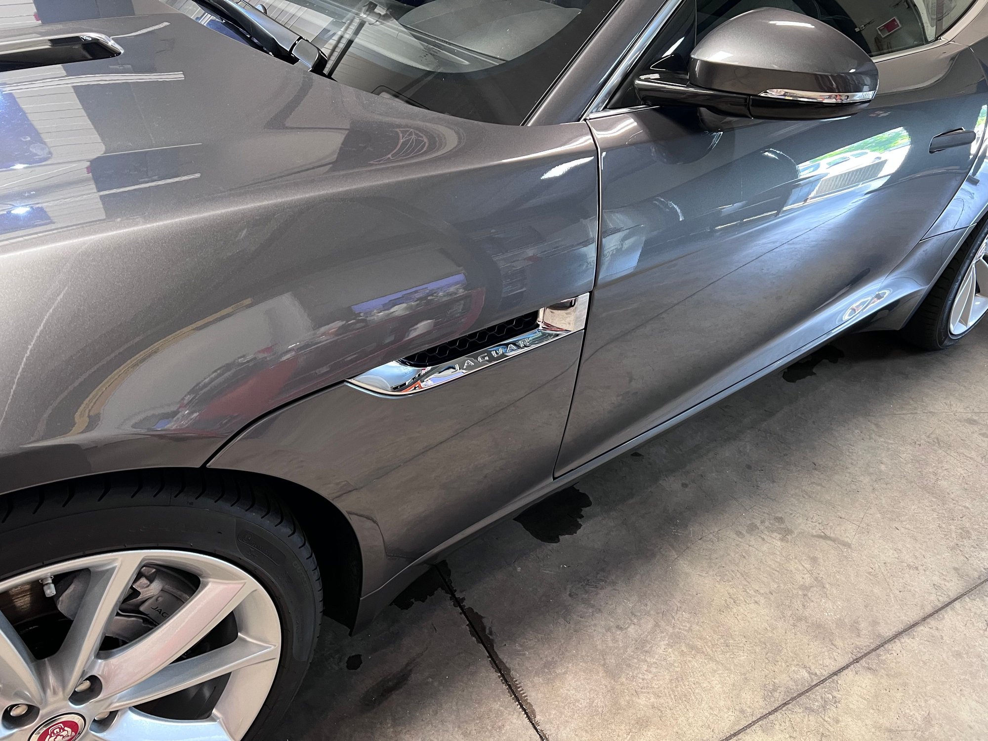

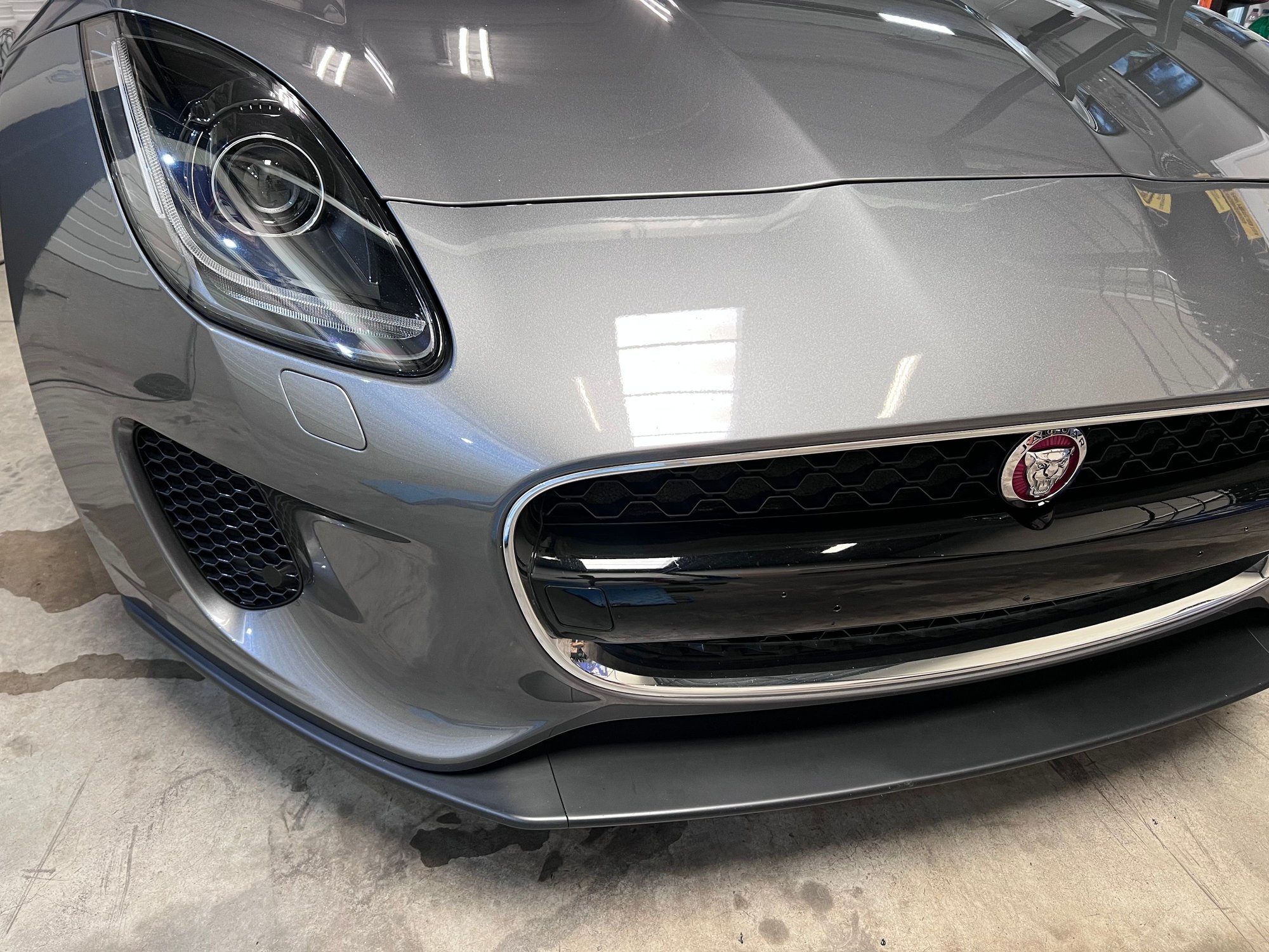

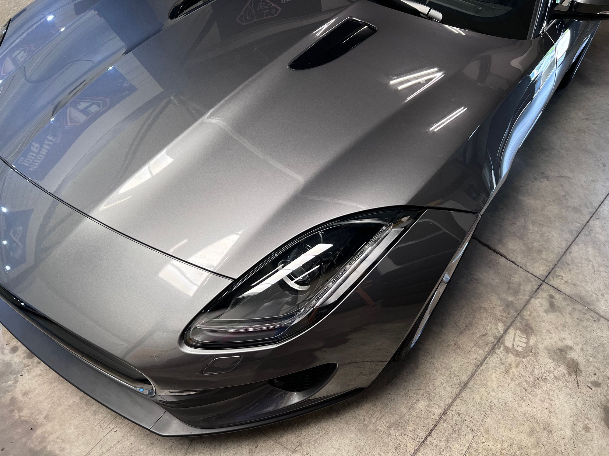

Hi Everyone,
I have a Jaguar F-Type in my shop with the hood not releasing. Cable hasn’t bin broken. But I need the hood open for PPF installation and steam cleaning polish residue. How can I get it released? Is there a way to get under the hood?
thanks for your reactions!
