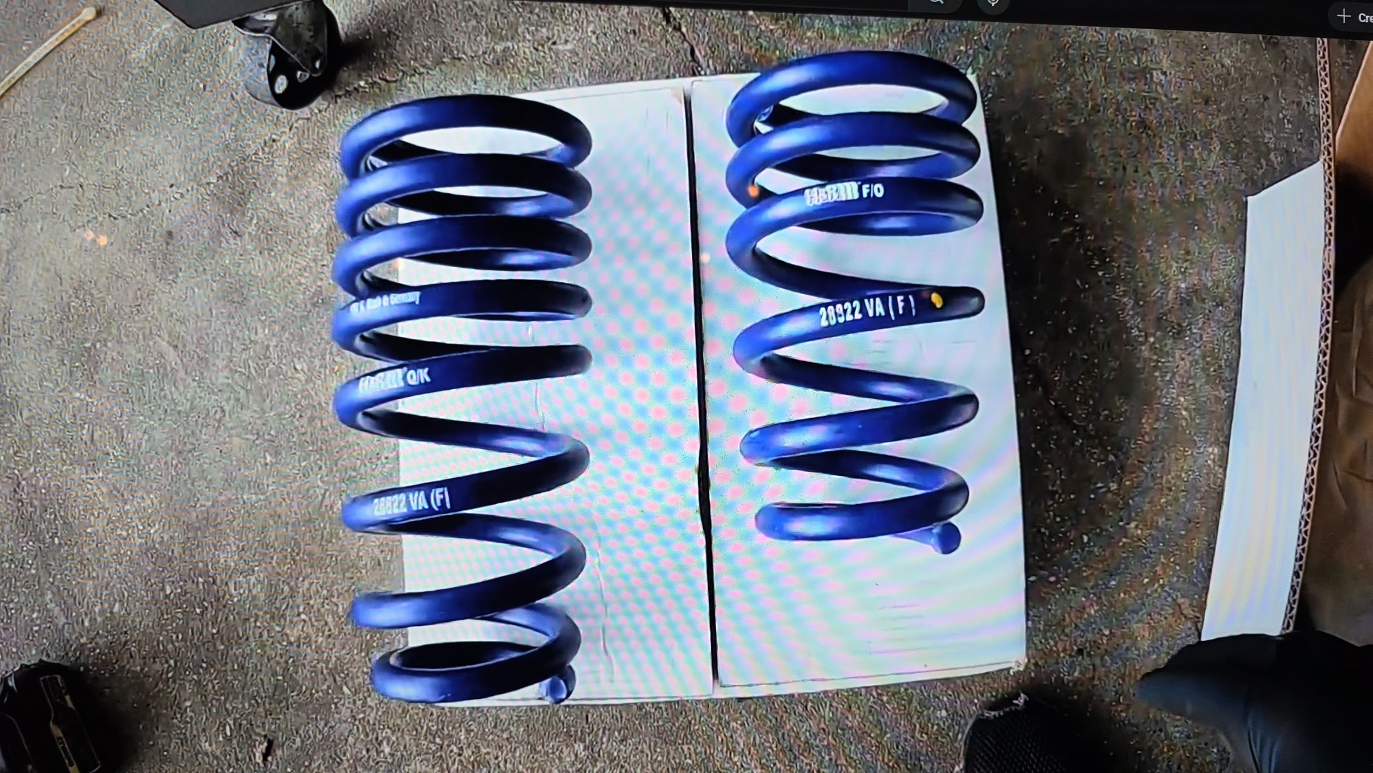

Unhappy KW kit - too long front springs on 2021 P450 AWD...??
Originally Posted by sundaram
Update - the KWs fit my 2023 AWD R with slight modifications to the perch. I haven't gotten it back yet, but they were able to drop a lot more than the 20mm as advertised. Will post pics when I pick it up next week.
Hi! My mechanic tried to install the KW HAS kit yesterday (Product Code "25331005" which should be for all AWD cars from 2013). My car is a 2021 P450 AWD (Phase 3 facelift V8 AWD)
The front spring assembly is way too long and would increase ride height at the front by over 1". He installed the front springs without the helper spring and at the max low setting it still sits about same height as stock if even a bit higher. The front spring is specified as a 130-70-200 (130 spring rate, 70mm inner diameter, 200mm lenght) in the install instruction and on the physical spring itself.
Rears fit perfectly (and can lower a lot more than then 20mm specified).
I checked the specs (in the install instruction found online) on the RWD kit (ending "003" instead of 005) and it has the same helper and main spring lenghts 75mm + 200mm main spring but a 120 spring rate vs 130 on the AWD (I guess for added weight). The shock would be very different though on the RWD and AWD variants on the front due to the front drive axles.
I just dont understand why the kit wont fit on my car, the KW spec sheet clearly states P450 AWD (which is a 2021+ facelift only model with V8)...
I have seen in a few other instances that there are two spring lenghts on the F-Type front, these are H&R springs from different kits, the right was the correct one for his 2015 V8 R RWD and the left is for what he mentiones V6 model?
Front H&R springs for different F-Type kits. His car was a 2015 RWD V8 R and the right spring was the correct one for his car, he says that the left was for the V6? But havnt seen anywhere else that the V6 has a different spring than V8 though it would make sense from slightly less weight up front...
I will speak with KW today but not sure what they can do, maybe I can source a shorter spring but couldnt find one from KW that matches what I would need...

Got the KW install sorted today!! It was human error! The solution was just to pack the whole spring assembly together and set the adjustment base to the absolutely lowest point and the front got lowered by maybe 20mm, more like 15mm. Luckily that is exactly what I wanted so it was 100% perfect to me, but it did NOT go as low as @sundaram has his on the front on the above pics. Rear can be lowered from almost stock down by something like 50mm.
The V6 F-Types has longer springs front (same lenght front and rear), V8's have shorter springs front. KW kit has 10NM harder springs up front for the AWD version vs the RWD version (130NM vs 120NM RWD), otherwise its identical and it fits both V6 and V8 cars due to the front adjustment screw can accomodate both the longer sprint on the V6 and the shorter on the V8. Rear suspension is identical between V6 and V8 cars.
The ride, chassie feedback and steering got a lot more direct with minimal impact on comfort + significantly improved stance! Very happy with the install, but if you want the front to be really low the KW kit as it comes is likely not for you.
