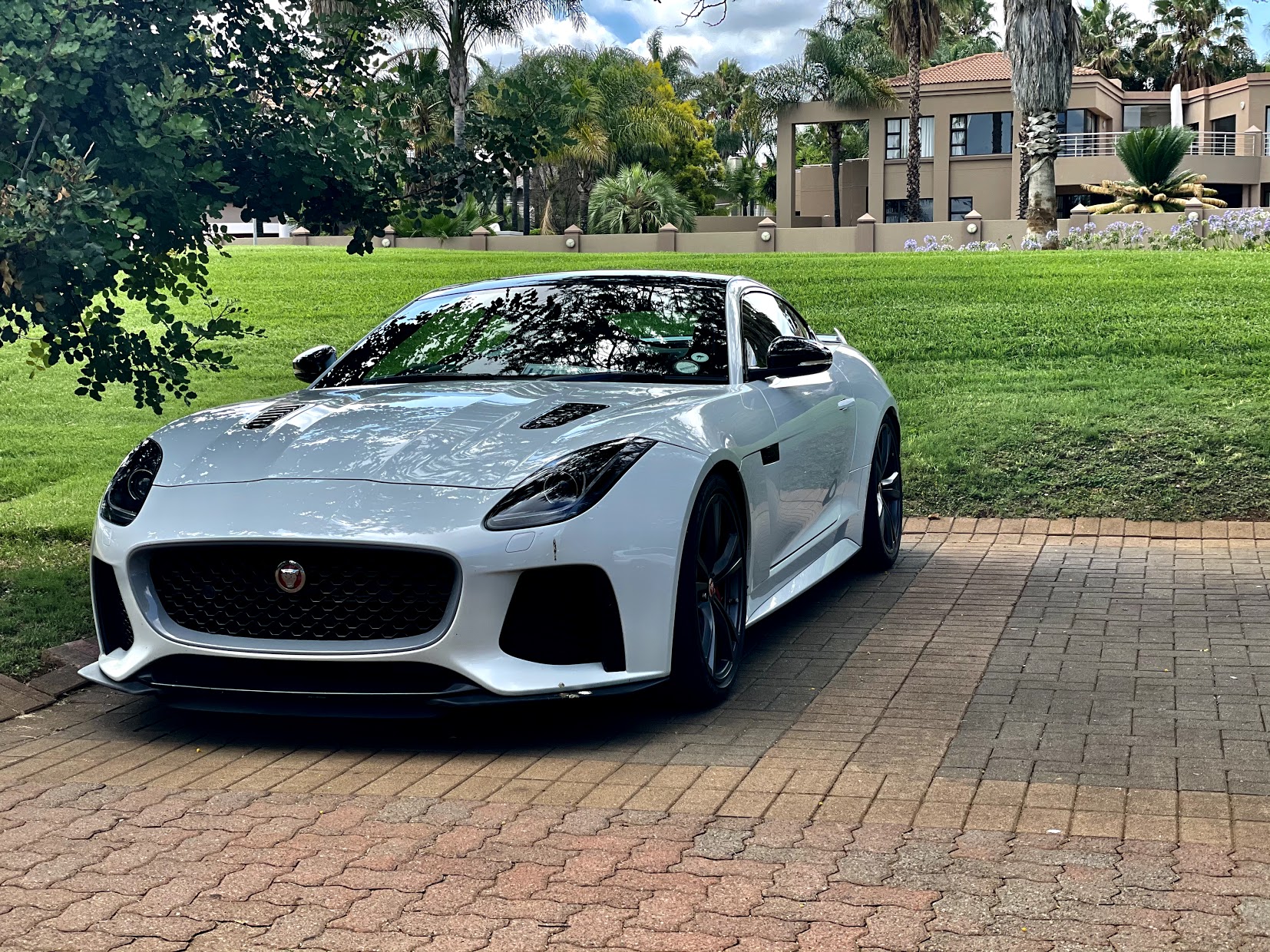

The handling feels much better. Grippier. With the stock setup I had exaggerated oversteer and understeer depending how fast I went into a corner. With the new setup, it's much more neutral at 8/10's.
I did have the suspension lifted up a bit and the torque steer feeling is gone now. Squat and go from the line

That height looks great! Like you said previously, some spacers on the wheels would look fantastic. Do you have any side profile pictures you could post?

Spacers added and the rear has been raised a hair:
Happy with it now!
