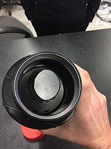

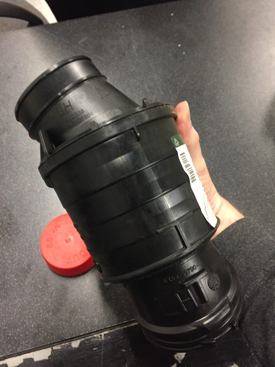

Hi there
OK parts 3 & 4 arrived, checked them out at dealership and decided to not go ahead with the purchase.
You can see from the image attachments the airflow is not restricted in anyway, there is no gauze or hydrocarbon or pre-cat type device in the tube at all unless of course they have been changed at some point during manufacturing.
Now of course the mid section is much thicker but trying to gut that would prove quite difficult and by doing so you'd then upset the air flow unless you smoothed out the internal walls.
I am quite sure that the thick mid-section absolutely reduces supercharger whine as the design looks to suppress noise and not impede airflow.
As such I feel the best solution would be to give sections 3 & 4 to a fabricator to have copied but without the centre bulge and as such a thinner wall and either made from carbon, FRP or ABS plastic all that matters is the internal diameters are kept as close to stock as possible with as smooth airflow as possible.
If there are any other parts people can suggest I look at on the intake system I shall do so.
Does anyone have an image of the interior of the air box from the V8? As maybe that also has carbon trap and/or Helmholtz resonator inside?

Those holes inside look like some sort of muffler function.
