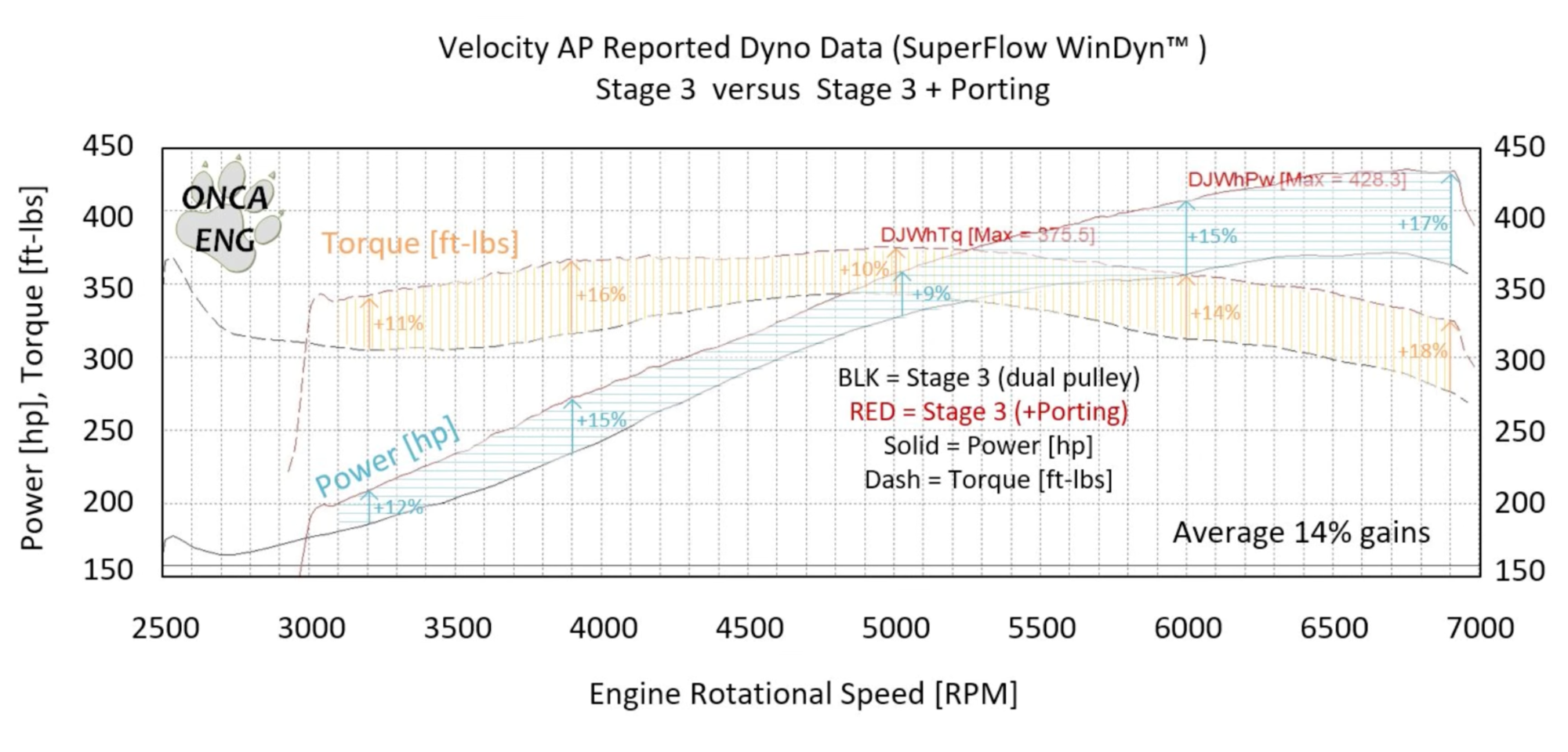

No clutch concerns as @WSHudds states above. I will be doing stage 3 and SC porting soon like @HermanWiegman :
