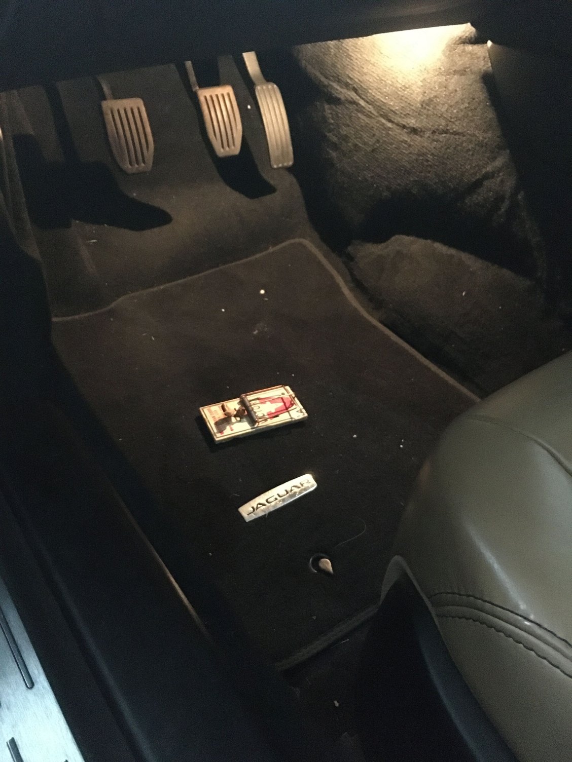

The below photo of the mouse trap by the Jaguar logo on the floor mat was rather ironic... a big hit with my family and co-workers.
I suffered much ridicule and bad jokes that attempted to affront my manhood and choice of vehicle... but I would prevail in the end.
Dim dome lights, from bird seeds
An ironic photo of a mouse trap next to the Jaguar logo

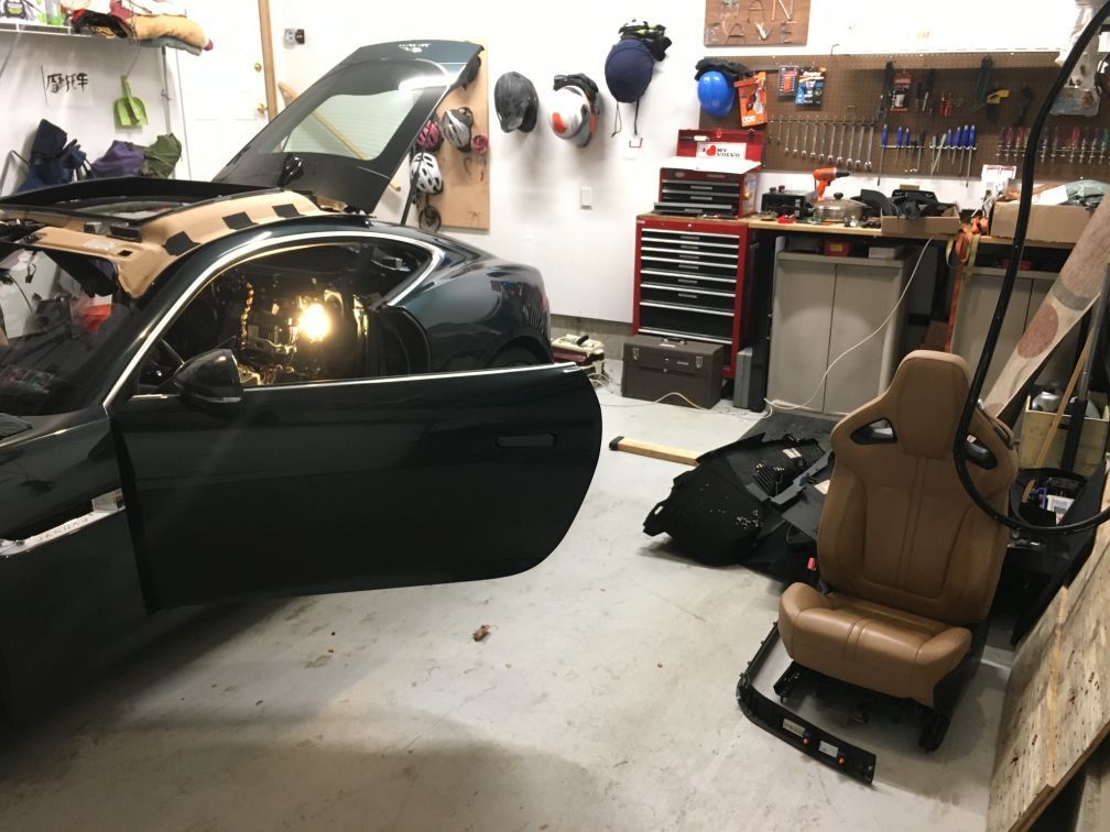

Next step: investigate the process to pull the headliner. I downloaded a PDF copy of the repair manual on the forums. Thank You!
The directions were pretty good, as I only broke one clip through the whole process.
Here are some notes:
  • follow the PDF manual down into the various sub-sections, often going a few layers deep
  • begin the process with the doors and hatches all open, and windows rolled down... before disconnecting the battery for the first time.
  • the battery will need to be connected and disconnected a few times to avoid airbag deployment and also support moving seats back and forth.
  • there are about 8 different types of Torx bolts (T15-T50) for all of the bits and bobs.. so keep them all straight with a cardboard bolt board
  • all of the pillar / roof / rear interior panels have to come out, so some leather cleaner and window cleaner also come in handy before re-installation
  • Only one side window (C-pillar) needs to come out to extract the headliner from the car.
  • enlist the help of an other person to extract/install the headliner as it is somewhat fragile and rather large

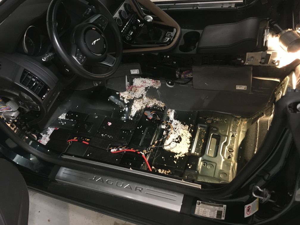

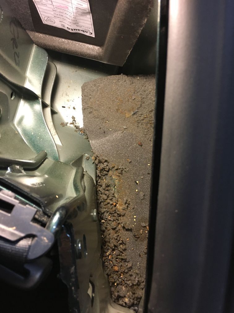

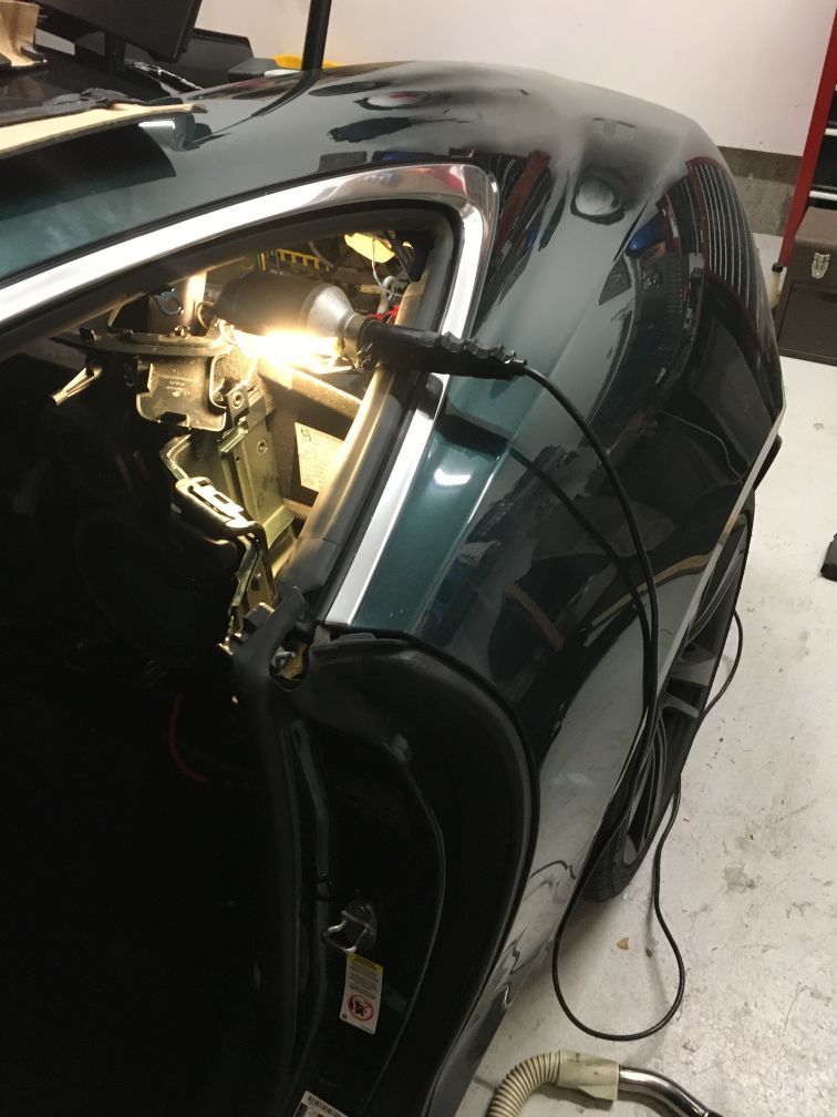

Here are some photos of the mouse hotel eviction process.
Final tally was about 8 nests and food hordes.
Dog food in the A-pillar...
What happens when you drink too much beer after dinner....
Mouse hotels below the left hand side carpet.
Small game hunting in the rear haunches...
Target acquired...

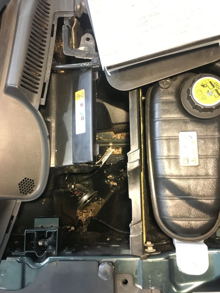

Probably crawled through the re-circ door. If you check your pollen filter you may find mouse damage there too

Here is a photo of the pollen filter area...
1) the nesting materials here look more like leaves, cardboard and cotton...
2) the pollen filter is new, so someone recently changed it and saw the mouse damage...
3) once the mice chew past the pollen filter they have free reign to the ventilation system...
Looks like I will be digging and cleaning for a while more. Oh well, that is why I call it my "hobby car."

Ive seen this more than you would expect. They love Mercedes wiring due to having corn starch wire sheathing. Seen a couple Jag ones but only one other like yours but in an F-Pace
