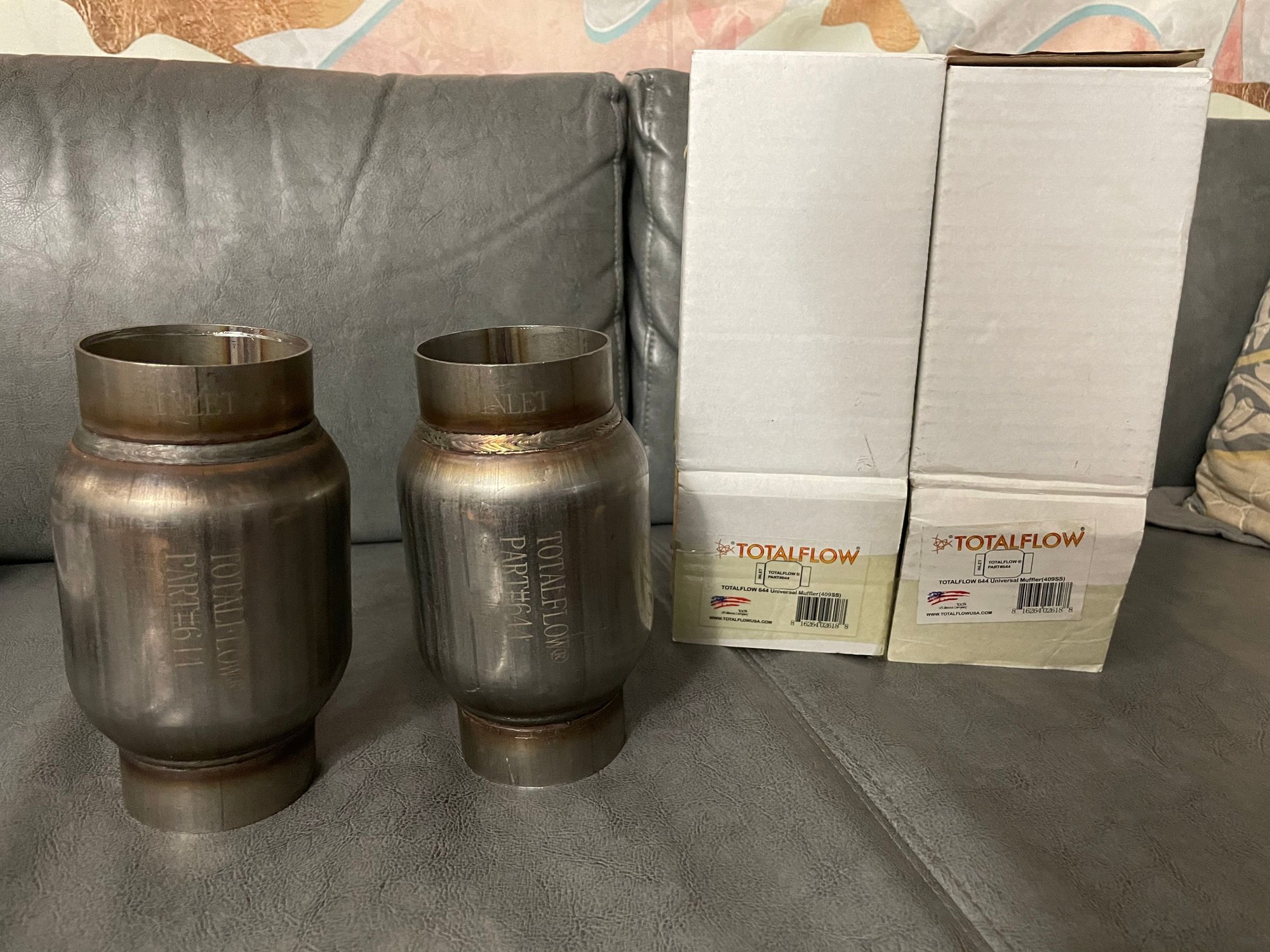

This whole setup sounds much better after installing two of these:
https://www.amazon.com/TOTALFLOW-644-Muffler-Inlet-2-5-Diameter/dp/B07RYC5XN5/ref=mp_s_a_1_1?dchild=1&keywords=totalflow+644&qid=1610059721&sr=8-1 https://www.amazon.com/TOTALFLOW-644-Muffler-Inlet-2-5-Diameter/dp/B07RYC5XN5/ref=mp_s_a_1_1?dchild=1&keywords=totalflow+644&qid=1610059721&sr=8-1
Less rasp, slightly less volume, and better idle noise. Sound clips coming soon on my channel.
These tiny mufflers really work!
Installed on the catless downpipes so they can be removed easily.

Yea! Much better exhaust sound. It’s still loud but cleaner sounding. I am surprised how these tiny mufflers work lol. It’s not a huge difference, but it is noticeable.

Default I was able to improve the exhaust sound with the $20 Amazon Mini Mufflers
Less rasp, less drone, and better idle noise. Still sounds really good when full throttle.

Mini mufflers welded to the temporary gutted downpipes. Very happy with the fuller and more refined exhaust sound.
