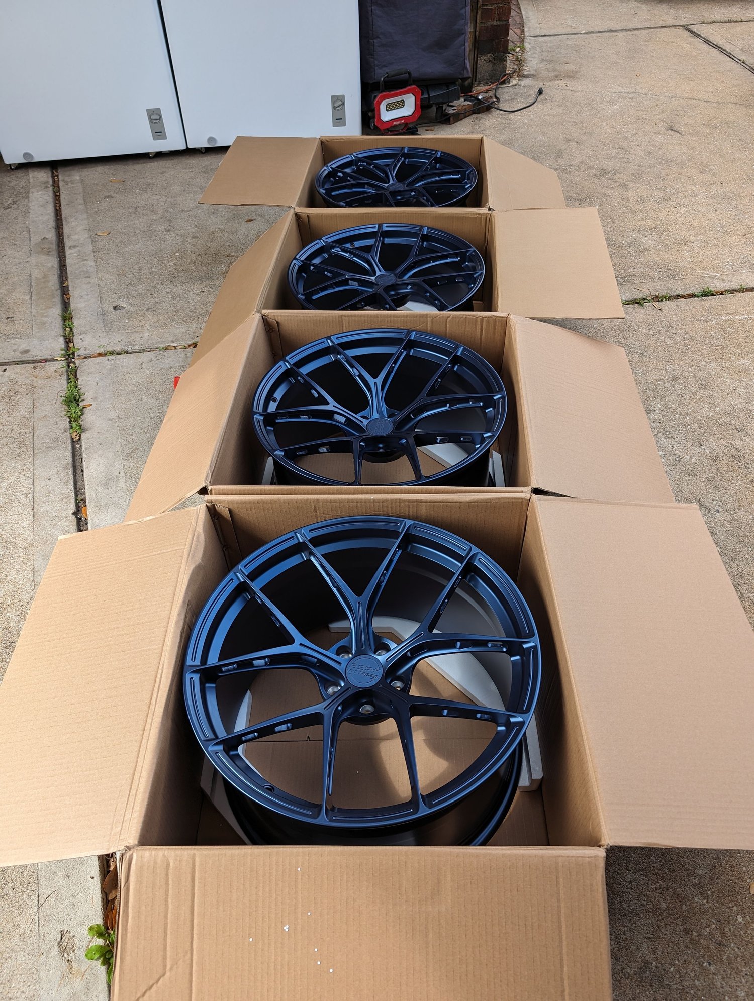

I am so stoked that my custom wheels came in over the weekend and wanted to share with fellow F type owners of an excellent and incredibly affordable custom wheel company, BSPK Forged.
I have not seen them mentioned on these forums and I believe I may have the first set of their wheels on an F Type so I wanted to share my experience in case others may want to check them out. John Repucci is the owner and operator and he is such a professional person to work with. Very responsive, concise, and helpful.
Please note: I am not affiliated with the company or owner at all, just a satisfied and repeat customer.
My car is a 2015 V6S with the Superperformance brake package (380/376mm brakes)
Wheel Specs:
Fully forged 6061-T6 Aluminum
Custom/user specified offset
Satin Indigo Blue finish
Fronts: 20x9 +40 offset; weight 20.5 lbs on my corner balance scale
Rears: 20x10.5 +21 offset; weight 22 lbs on my corner balance scale

Unboxing:
Wheel and machining details

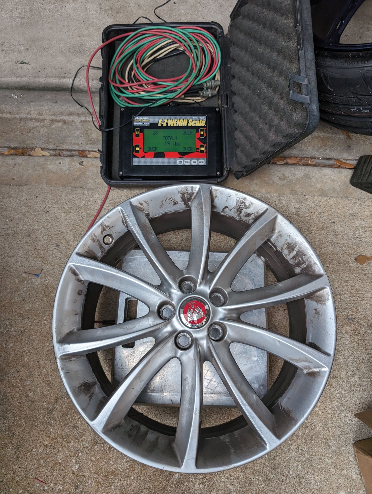

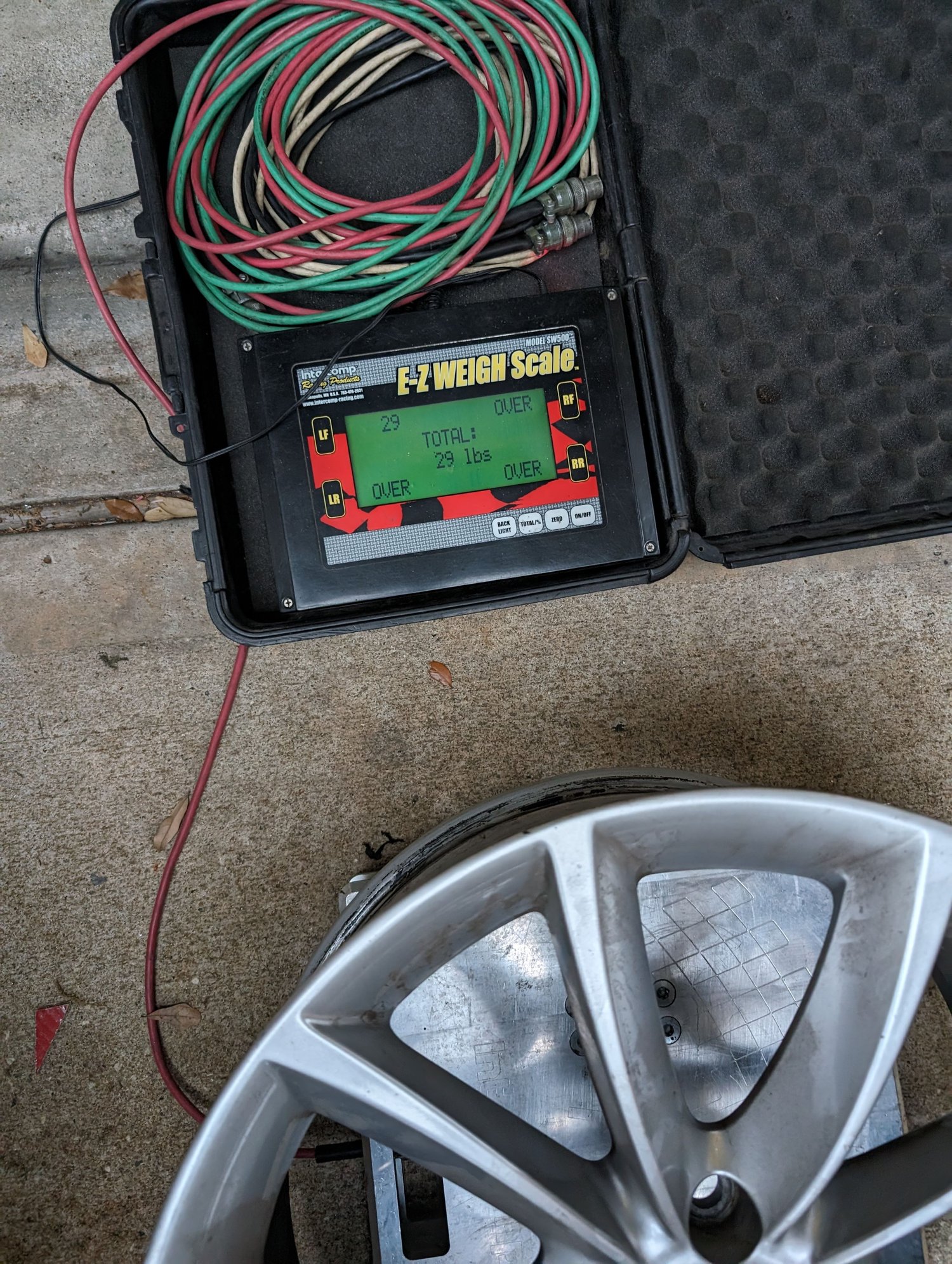

A small update for today
I had enough time to mount the front tires on today and also dismount the OEM 19's for some weight comparisons.
19 x 8.5 Front OEM turbine blades - Weight: 28lbs
19 x 9.5 Rear OEM turbine blades - Weight : 29 lbs
So that nets me a weight reduction of 7.5 lbs in the front and 7.0 lbs in the rear, all the while being larger and wider 20x9/20x10.5.
I also have the fully loaded weights, but that's less of a direct comparison as the tires are different and they'll weigh differently. But here's captures for that anyway-
OEM setup is on Pirelli Pzeros = 55lbs fully loaded (Wheel/tire/tpms/centercap/balanced weight)
BSPK setup has Firestone Indyhawk 500 = 49lbs fully loaded (Wheel/tire/tpms/centercap/balanced weight)
In any case, I'm super thrilled to shave 6lbs off rotational mass all the while having larger and wider stance.

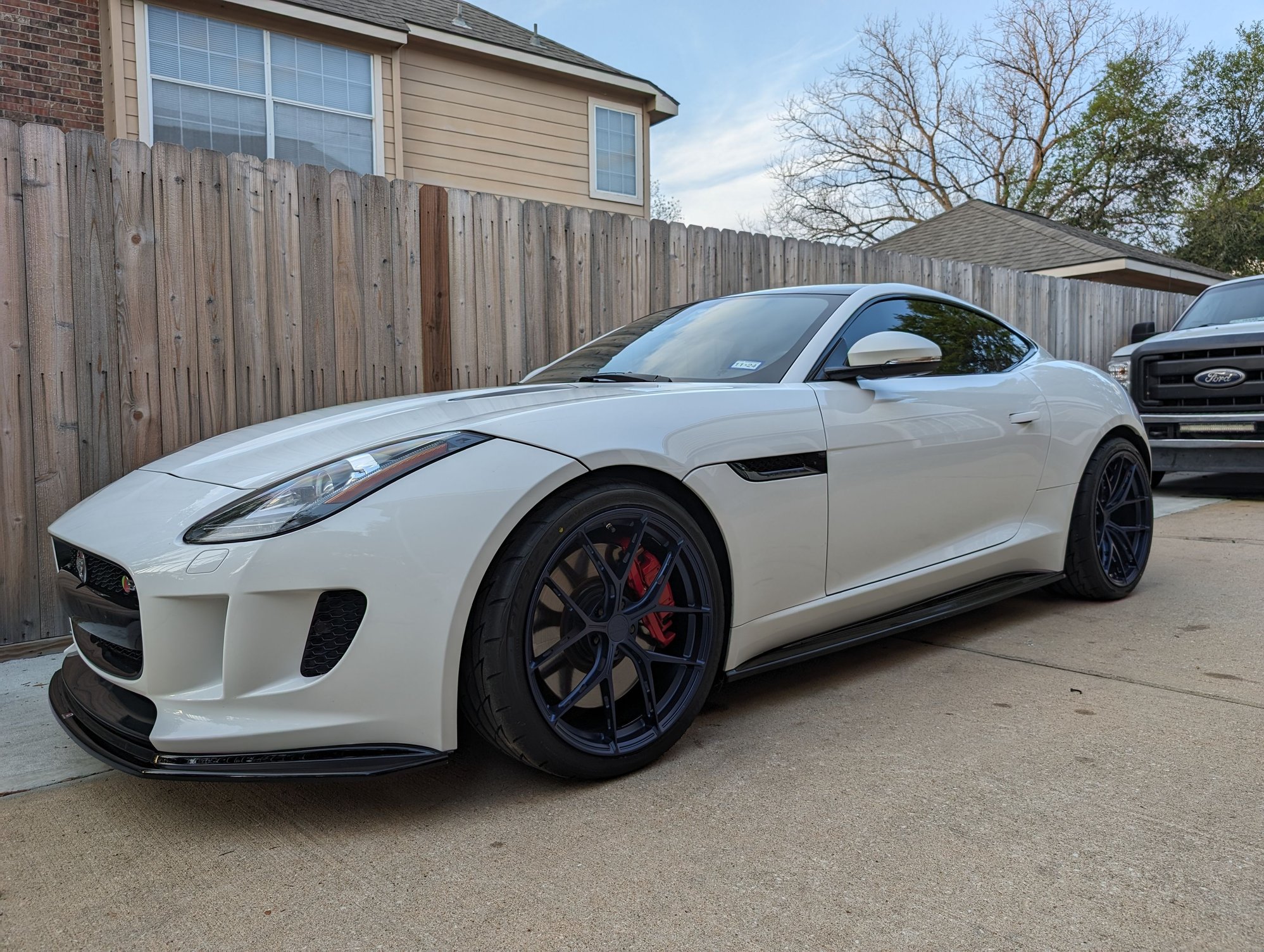

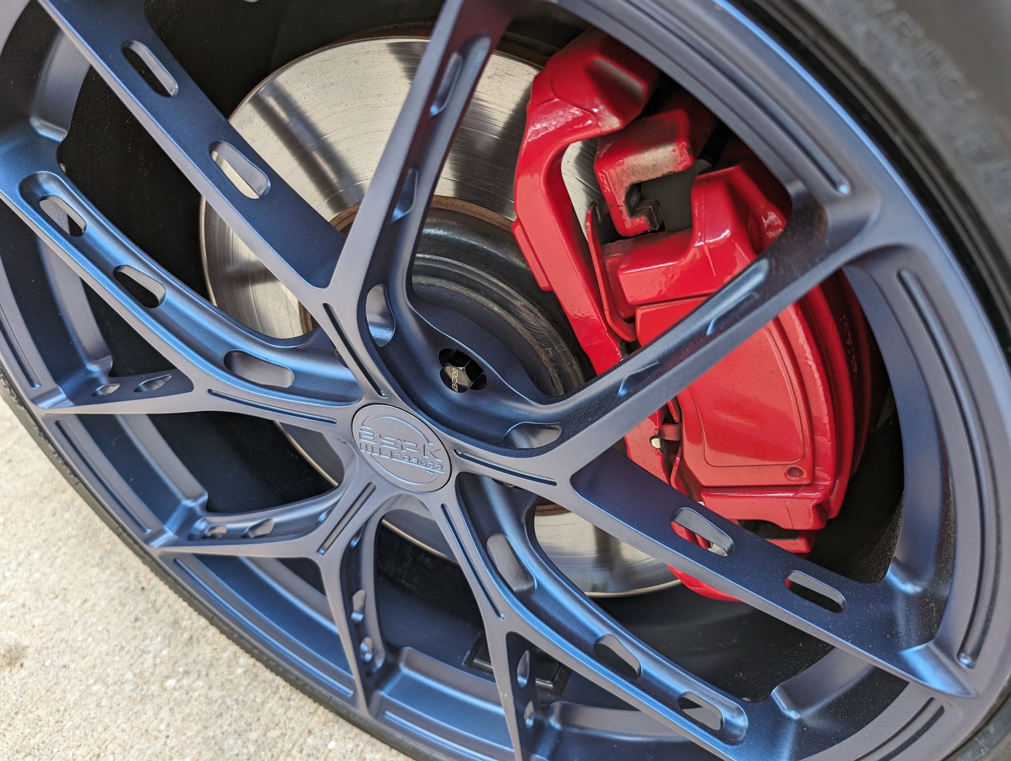

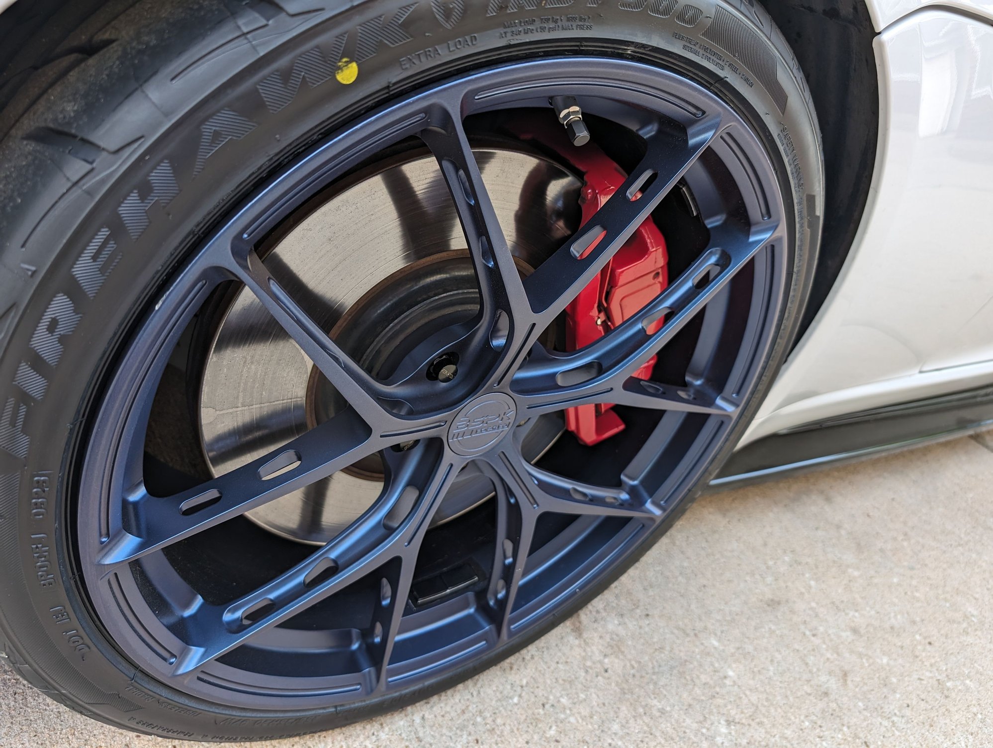

Mounted!
I am absolutely in love with these wheels. The color is amazing as it changes depending on lighting conditions and the steering already feels more responsive with just street driving. I'll know more when I take it to the track, but I suspect that's from the weight loss and tire profile/sidewall.

That's a sharp look!

That stance is perfect man. Great post!
