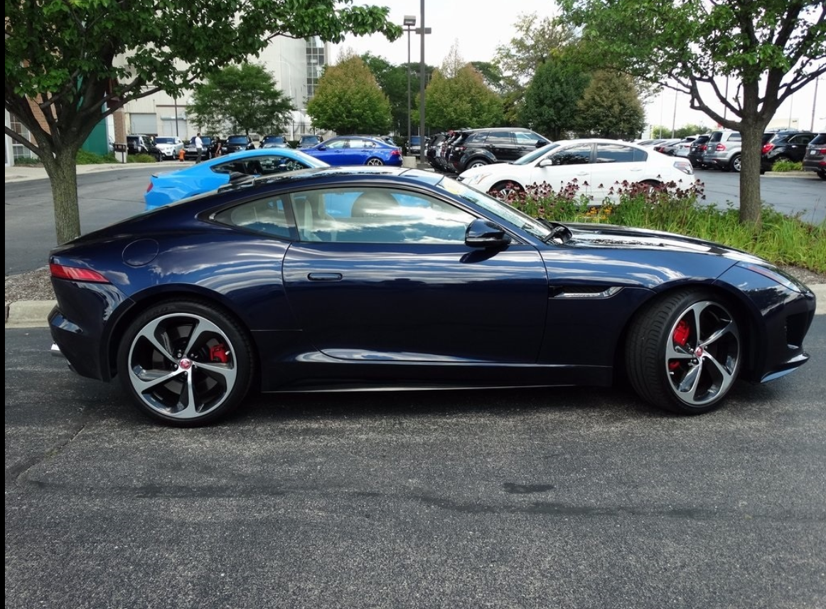

Originally Posted by roelly
What a beauty!! Love the blue I will most likely need to do the same.
