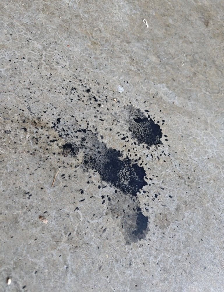

Hello and thanks for taking the time to read! I've been trolling this forum for a while, and I'd like to ask for some advice on how to proceed.
Here's the stage:
I (Very) recently got my paws on a 2017 F-Type SVR Coupe 🥰 . I got this (1 Owner, clean carfax and 14k miles, from a Porsche dealership. Previous owner seems to have taken good care of it - who allegedly traded it in for a 911 - which is why I purchased it. It's still under the '60 day dealership warranty') [whatever the fine-print on that means ... 🍻].
This is my first Jaguar. I'm used to BMW, WV & Other German manufacturers that well, drip all kinds of stuff 🤣, but usually after 80-100k miles...
A 'checkup service' with my local Jag dealership is scheduled for next week. I am by no means a 'car guy' - I just like to drive. It's my full intention to take good care of this car. Unfortunately for =reasons= I didn't have the chance to do a PPI like I'd have normally done - I decided to trust my gut feeling and the promises of the Porsche dealership that the car is in good condition. *the purchase experience there was also a story for another time... But I really wanted this car.
This car spent most of its life in California, but the last couple of years up in Minneapolis. I only had a brief chance to look under the car and I only saw tiny bits of rust on the steel support strut, much less than expected, the rest of the car looked clean. (I used to live in Europe, so I learned the hard way what northern winter will do to car manufacturers that don't respect the weather... or chemistry for that matter &#129315.
After a great (intentionally long) drive back home from the dealership ( about 900 miles ). I did a quick undercarriage wash to get rid of the salt before putting it in the garage. I wasn't planning on moving it much before taking it to the dealership for an inspection and fluid change, etc. And I was planning on replacing those struts before they have a chance to rust.

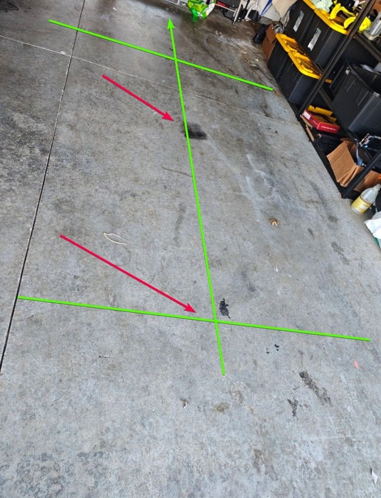

I had to move the car yesterday to move some stuff around the garage (don't judge!) - when I noticed 2x spots where some sort of fluid had dripped (see pics). I had parked the car (arrow facing) - and by the positioning, and slight red sheen on it, my uneducated *** would have said that that looked like transmission fluid.
The questions:
( After having done some mildly obsessive homework about all sorts of mechanic stuffs about this car that I still don't understand and probably never will...). This is supposedly a 'forever sealed' transmission, yet many places heavily recommend flushing the transmission after ~40-50k miles or 10y depending on use).
- How concerned should I be? 🤔
- Should I have someone flush the transmission? (I was planning/calculated with ~1-2k cost to the Jag dealership (and/rmy regular trusty mechanic) for pricing on flushing the transmission and probably all the other fluids?)
Thank you!

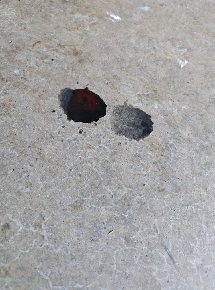

The black spots are almost certainly exhaust condensation drips, very normal and well known, there are small holes in the exhaust pipes to allow built up condensation to drip out leaving black sooty spots. Nothing at all to worry about.
Not sure what the reddish spot is but my WAG is that it is not transmission fluid but coolant, the OEM/normal/usual F-Type coolant is pink/red/orange in colour.
Maybe a touch/feel test would help, i.e. does it feel oily or just watery?
I don't think I have ever read or heard of a transmission fluid leak on an F-Type but coolant leaks are quite common.
If it is coolant it could be coming from a number of places and you would need a thorough examination and some tests to figure out the culprit.
First step would be to remove the undertrays and do a visual inspection, second step would be a close inspection of the engine compartment, next step would be a coolant system pressure test.

I can't speak to the leak under the middle of the car but the red fluid toward the rear of the car is the rear differential leaking (probably the front seal). It's a common issue.

I agree with all of the above. Car needs to be lifted and inspected by a good JLR independent or JLR dealership. I’d be very surprised if it’s a tranny issue but no telling what the PO and/or the Porsche tech’s have done. For sure the tranny should not need anything based on miles and “someone” may have decided to do a tranny service and not done it well. I have been told the OE fluid is special mineral oil and VERY expensive, if the JLR dealership does the service.
The red spot could well be coolant. Check the coolant level in the reservoir. JLR used Orange and then Pink Dex Cool. DO NOT add any left over BMW blue you may have left over! Several likely leak suspects that are not based on miles. I’d be willing to bet the WP and/or the little plastic elbow going into the WP from the thermostat bypass hose. A JLR guy will figure it out. If the coolant is low, add some Pink. DO NOT allow the coolant to run low. An overheat is catastrophic with this motor. The dash will not warn you. This little leak IS your warning.
If the car was pointed the other way, it could be differential oil but I don’t think that fluid is red. You absolutely should have the pinion seal inspected. A well known problem.

Good morning and thank you for your feedback!
The exhaust drippings makes so much sense, didn't even think about it! Both spots had VERY similar consistencies, both definitely more on the watery side, the 'red tinted' spot felt mildly more oily but not by much. I've 'felt' transmission fluids before (like from some CVTs) that felt close to this, but on the other hand I've also 'felt' transmission fluids that were more akin to steam-age grease XD. So I didn't know what to expect coming out of a Jag

As a side note.. If you are trying to determine if it is Diff fluid, smell it. Diff fluid smells bad when it is first put in the car, however it smells even worse when it has been in the car any amount of time. It smells more like a fishy oil... The other give away for it is that Diff fluid is not usually red in color. I hope y'all don't think I am crazy but this is what I have found over the years.

Hello again! And sorry for the delay in responding - turns out, the other day mid-flurry of responses, I somehow managed to get myself temporarily banned - quick posts? 🤷🏽‍♂️
Thank you all for your suggestions. I scheduled a full service and inspection with my local JLR dealer and they'll take a look and replace all fluids (if necessary), just waiting for all the snow and salt to go away before I drive it there
In the meantime... Updates! ...
- I left the car in the garage for 2 days. No new spots.
- I took a (gentle) ride, parked it back in the garage, next day: no new spots.
- I decided to let it idle in the garage ... after 10 minutes... SPOTS!
However... this time it was just clear water. Both puddles in the exact same places as the original ones, this time however, water.
It made total sense what some of you pointed out about the exhaust pipes! - I was still confused about the one in the middle of the car. I took a look underneath, and I couldn't find anything weird. In fact, it looks suprisingly clean and rust free below. I saw a couple of struts that are starting to collect some rust, so I was thinking about having those powder coated, or I saw a set of reinforcement struts that these guys make > Wraptor Designs > Struts I was wondering if anyone had experience with them.
It's been about a week now, and I haven't found any new 'dirty/oily' spots. So maybe this was really just a false alarm 🤞🏽🤞🏽🤞🏽. I'll post back once the inspection is complete.
In the meantime, thank you all for your comments and support!
