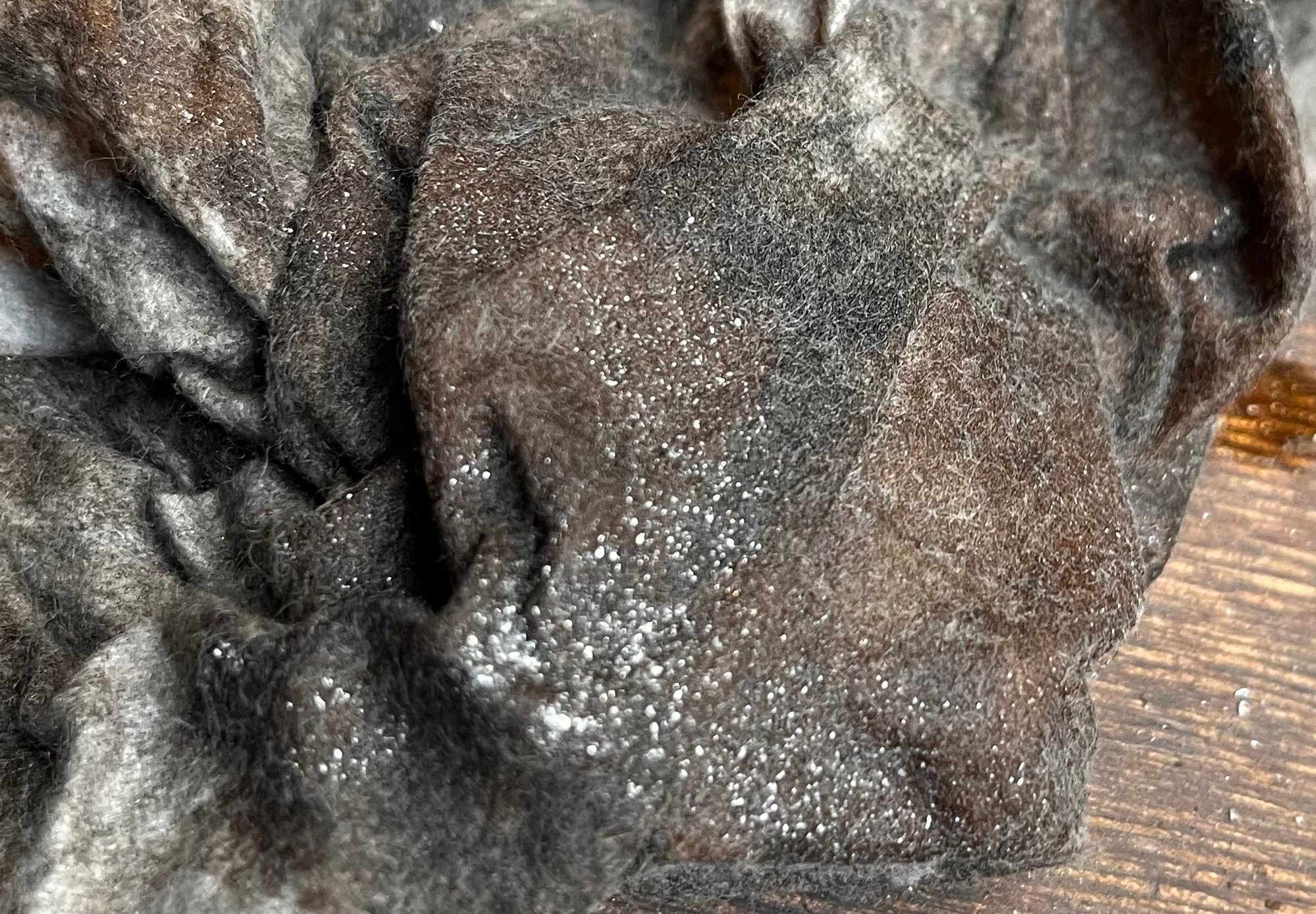

I’m cleaning up the car and diagnosing what needs to be done.
The major issue is the heavy knock. My prime suspect is a spun bearing. I have no history of the car.
I pulled the filter and found metal shavings in it. See photo. I used a magnet to find out if it is aluminium or steel. At least there is steel.
Where can this come from? Cylinder lining? Timing gear? Not a bearing, piston, piston rod?
Any ideas?

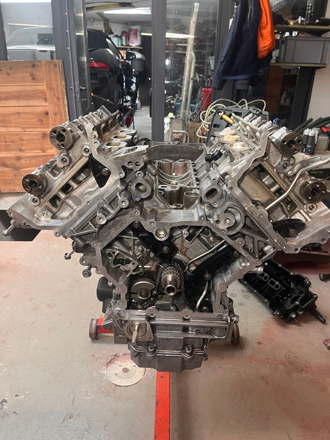

Heads on
Heads on
Timing installed
Timing installed
Fully dressed
Fully dressed
almost ready to install.
in basic a very pretty engine. But all those things mounted on it. Makes it very bulky.
