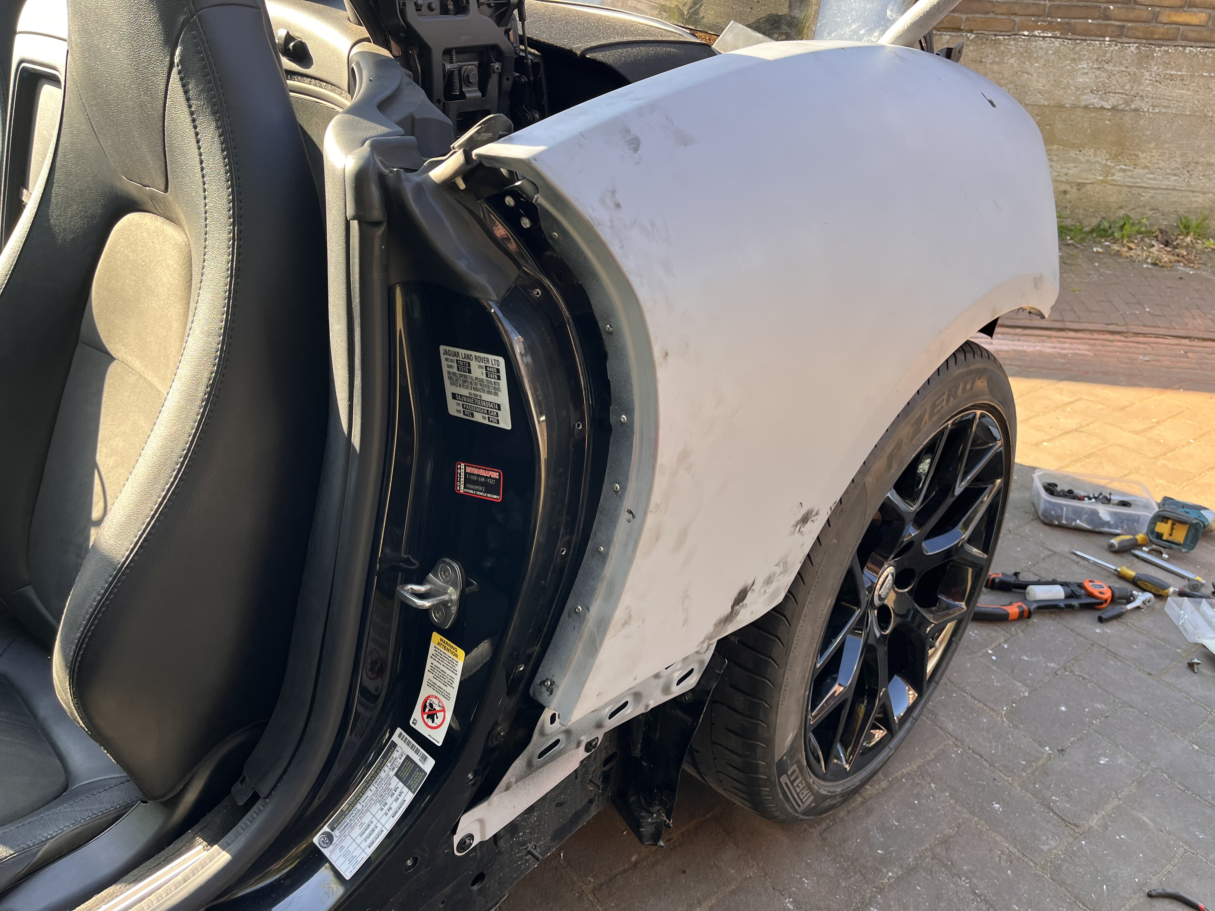

The front is complete. The bumper will have to come off again for the headlights (cracked). The engine runs fine. Some ticking from the supercharger (I didn’t check it when the engine was out). A lot of polishing to do.
Nose ready
Nose ready
Next fase: rear quarter panel.
Panel out.
Panel out.
First fit.
First fit.

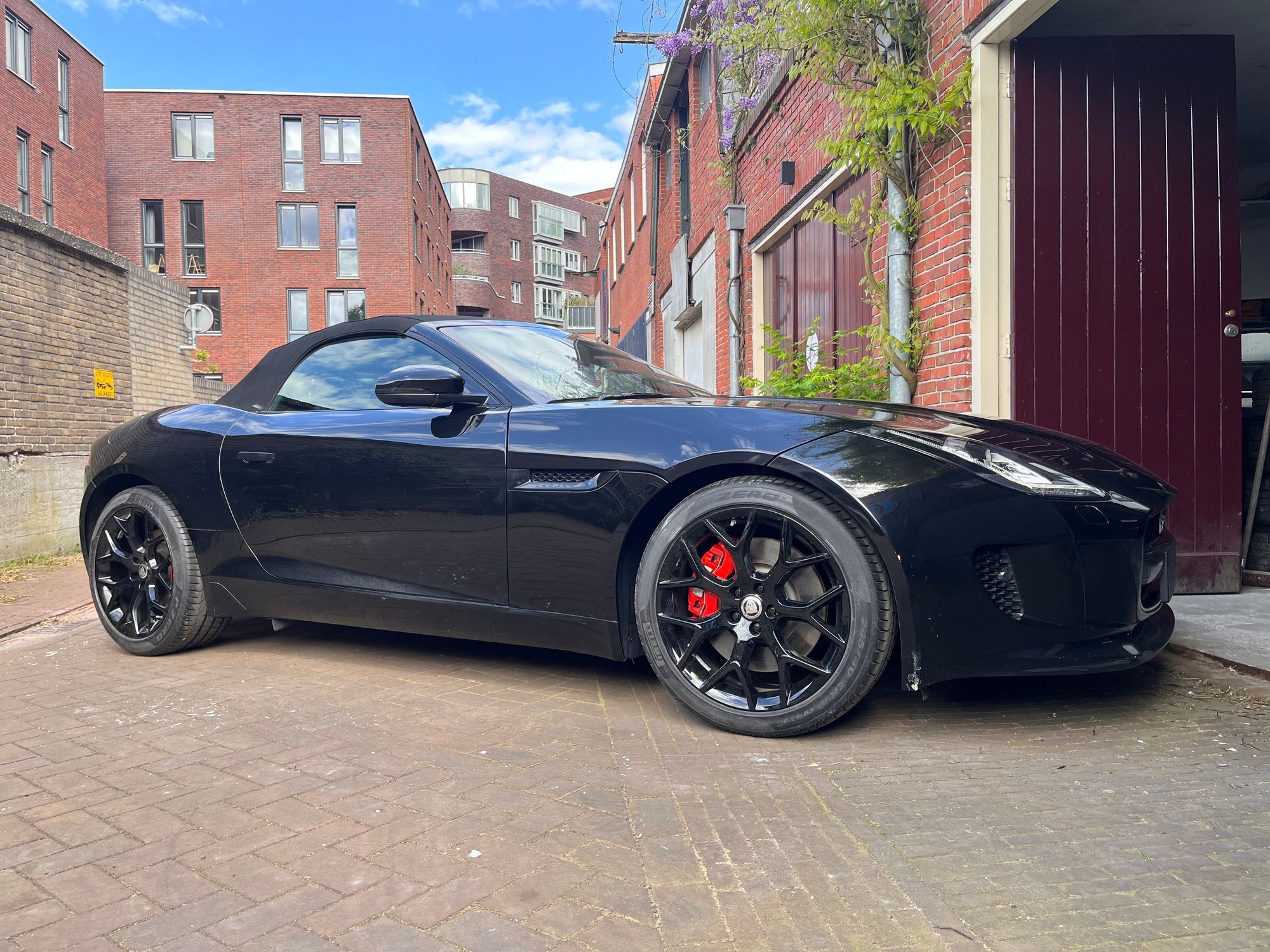

I finished the body work. The next fase is alignment and filling the air conditioning. So I drove a 20 minutes drive to a workshop (with workshop licence plates. The engine is running perfectly, good pressure, no overheating, leakage, etc.
After the workshop it will be registered in the Netherlands in a goverment test centre (RDW). After that it will be appraised, than I have to pay taxes. Than it is allowed on the road. After that it will go to the paintshop. Than I can finally drive it. This autumn we plan a trip to Tuscany, top down and visit nice places and restaurants.

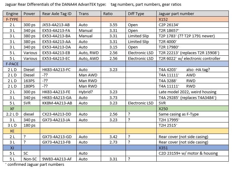

Does the 340hp F-type have a LSD?
Old Jul 18, 2025 | 12:16 PM
  #32
DJS's Avatar
DJS
Posts: 6,995
Likes: 2,665
From: Metrowest Boston
That’s a good point. The open diff of the base (340HP) has a different ratio than the S’s (380Hp) LSD. I believe Herman Weigman here produced a table of all the different options.
Old Jul 18, 2025 | 12:20 PM
  #33
DJS's Avatar
DJS
Posts: 6,995
Likes: 2,665
I believe this came from Herman…

Default Can I find the tag?
I have the 340 manual. If I skinny under the car, is it possible to see the tag?

From: The Netherlands
It doesn’t have one now, but soon it will have one.

Finally…. It is registered!
Now I can drive it!
In the meanwhile it has the LSD swap.
Registered in the Netherlands.
2013 Jaguar F-type.
2013 Jaguar F-type.
