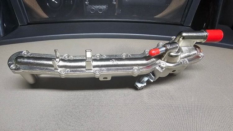

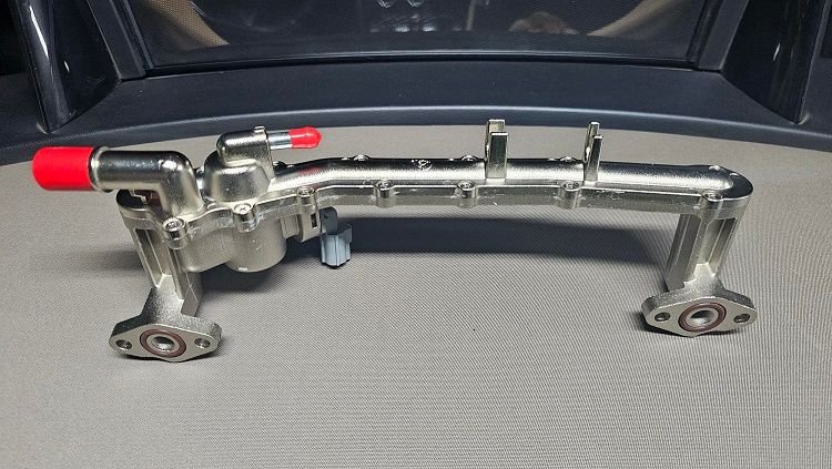

Default NEW Rear Coolant Water Heater Pipe
It has arrived. It looks and feels like a quality part. Too bad it will be hidden in the back of the engine. It looks like a RTV/Silicone type gasket material was used instead of a paper/fiber gasket. I tried to pick some over flow material off but it is stuck on there pretty hard. I haven't tried to fit it yet but I'm confident it will be a perfect fit.

First thing to do is make sure all screws are tight ,then check all passage ways

I think I'm going to run my scope in the outlets at the back of the engine just to see what I can see. I already removed the ridiculous symposer.

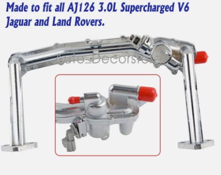

Would this be the correct part?
Plug N play, or does software get involved?
anything special to refill coolant? I have container of Jaguar spec.

That is the correct heater pipe for the V6. No software programming necessary. It is a direct fit. It's like the other plastic water pipes. Take the old plastic welded pipe out and replace with this one.
If you re talking about bleeding the air out of the system after replacing the pipe, I'm not sure. I need to figure that out too.

I found the one pictured on Ebay.
eBay item number:395347555941, don't know anything about the seller, it's an "unbranded" part. Not saying I would buy this particular one either.

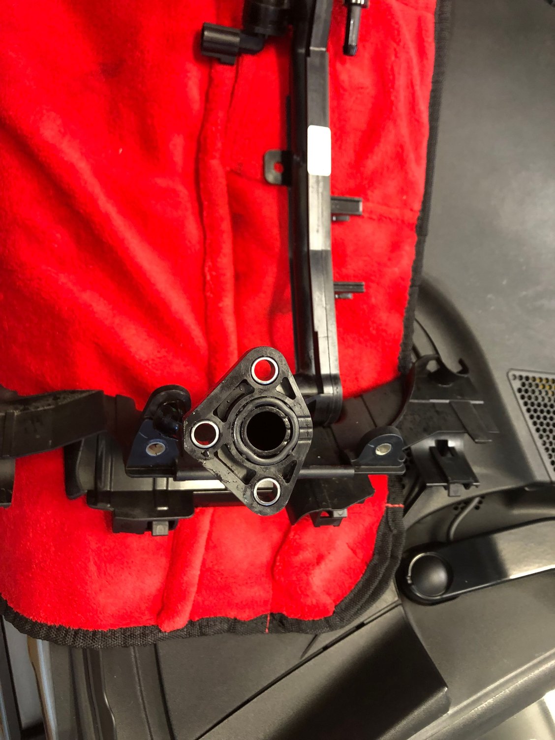

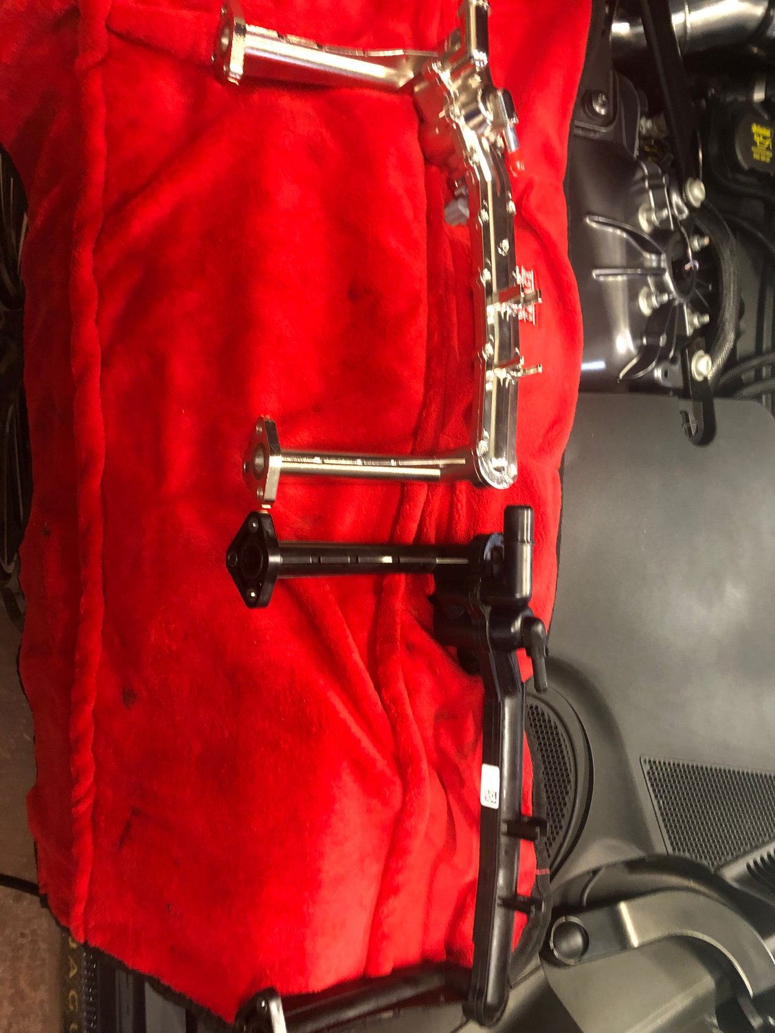

Default 3 screws
I changed mine last fall with some difficulty, primarily removing the plastic heater pipe. I notice in your pictures the new heater pipe has only two screw holes whereas mine has three similar to the plastic one I removed. If yours are compatible it will be an easy install. The hard part is if the plastic one your removing has the three holes similar to mine, the lower center screw is difficult to access due to the webbing on either side of the screw. I had already removed the symposer which helped considerably, the wiring harness bracket had to be removed to increase access. It’s a pretty easy job, yours should be even easier with only two screws on each side. This is my first attempt at attaching a photo.
As you can see, 3 hole flanges
The center bottom was difficult to access

3 holes = V6, 2 holes = V8.
Also the "runners" (the tubes these holed flanges are attached to) are much longer on the V6 version than on the V8 version.

Well that explains it! I should have bought the 8! But I enjoy the manual 6sp.
