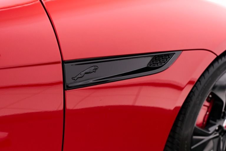

I ended up just wrapping mine in gloss black film in my attempt to de-chrome mine.

That looks great- did you wrap yourself or have a shop do it? I want to do the same and trying to decide if I should try my hand at wrapping.

I wrapped them myself using a heat gun and vinyl from Vvivi (
Amazon Amazon
) Just make sure you have a new xacto knife blade to cut the excess. A dull blade can tear instead of cut.
Also I had a chunk of soft silicone rubber and used that to press the vinyl into the JAGUAR debossed lettering. Heat the vinyl then push the silicone rubber to force the vinyl into the lettering recess.

That looks great!

The
wrapping looks good on old vents, but I do like the style of the new one...

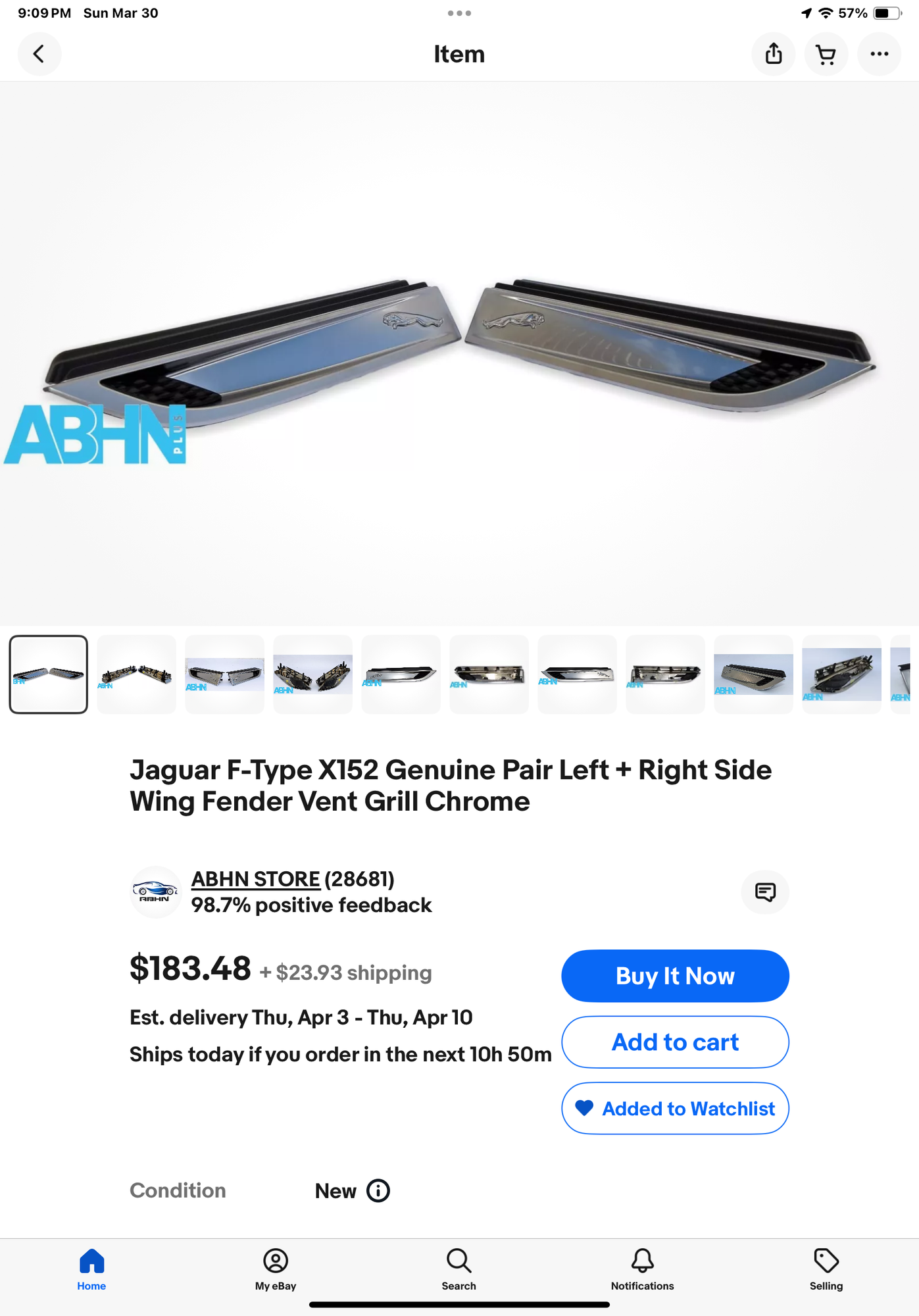

Originally Posted by rtmyers1
Has anyone replaced their 2020 or older F Type side vents with the new style from 2021 on... I see they're on sale on ebay for 150 dollars...
price has gone up a little but here it is.
